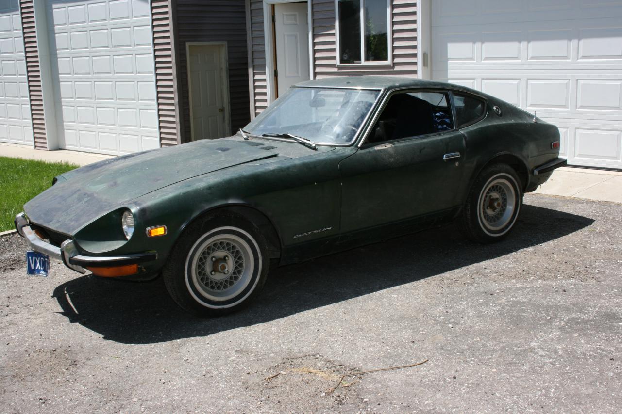

Posted June 1, 200915 yr comment_285353 Not an emergency, just Not sure where to post - so If I need to post elsewhere please let me know. New to forum and need some help in getting started and some information. I have already killed a couple trees printing off forums. 1972 240(HLS30-95298) 68,000 miles sitting since 86, no body rust to speak off, outcome is to put back to original condition Engine was ( i said was) stuck, passenger side floor pan rusty(ed)(needs replaced) and spare tire well rusted(same situation as floor). Engine as fired, but not started yet, still some work to do before I expect this. 1)Looking for a reputably company to buy replacement parts from, everything from weatherstripping to door panels to console, Who have you had good experience with, don't need to know bad just good. 2) Manuals who has a good one out there and where to buy. 3) Ignition key, kind of works, kind of don't work , replace ignition or new key? and where would I find the key designation?(not in glove box) Thxs in advance Joel Solon, Iowa Link to comment https://www.classiczcars.com/forums/topic/32045-manuals-parts-and-keys/ Share on other sites More sharing options...
