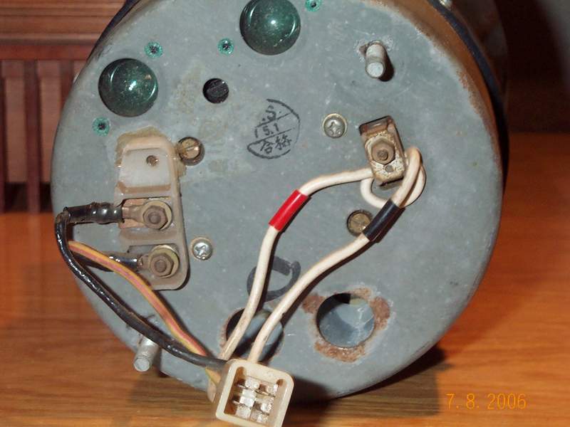

June 29, 200915 yr comment_288285 I have the typical 4 wire connector. One Orange wire, One Black wire, and a white wire loop w/Red tape & w/Black Tape into the same connector. The white wire is an inductive loop that completes the ignition circuit. Here is a photo attached: Many thanks.. Edited June 29, 200915 yr by moritz55 Link to comment https://www.classiczcars.com/forums/topic/32100-tach-acting-very-funny/?&page=2#findComment-288285 Share on other sites More sharing options...
June 29, 200915 yr comment_288287 And you know it is triggered from the positive side as standard!If you want it triggered fron the negative side, then get a 3 wire.Chris Link to comment https://www.classiczcars.com/forums/topic/32100-tach-acting-very-funny/?&page=2#findComment-288287 Share on other sites More sharing options...
