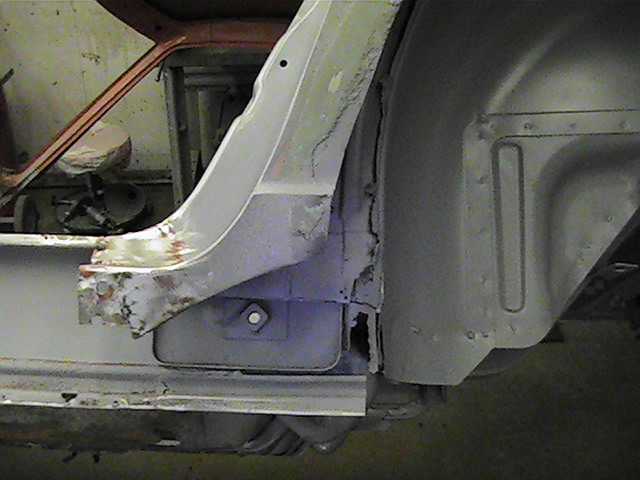

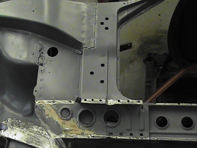

Does anyone know if there is a set of X-Ray type views of various parts of a 240Z or pictures that show these areas with the outer metal surface removed? I am particularly interested in the lower part of the dogleg just in front of the rear wheel and other rust prone areas as I am thinking of packing those areas with chassis grease (poor man's POR-15) to stop it from rusting. I lost my last 240 to rust don't want to lose my current car that way.

Here are two pix of the structural steel on the inside of the rocker panels. One of the front end and one of the rear. I hope they help you.
However, you must know that there is undoubtedly at least surface rust on all these bits. If I were you, I'd figure out a way to bathe these parts in Ospho to convert the rust and then apply a two-part epoxy or polyurethane coating to them. You'll have to remove the seats, dogleg finisher panels, sill plates, and pull up the vinyl covering to expose all those lovely access portholes. It's a bit of work, but surely worth the effort in the end.
Thanks for the dogleg pictures, they are very good. I may have to make a new hole inside the car to gain fuller access to the dogleg; the porthole there may not provide enough. I pulled the inside finisher back a little and looked with a flashlight through the porthole; no surprise, I can see rust in there. I bought some long skinny brushes at bed and bath that are on steel twisted wire that can be bent into different angles. Good idea on ospho; it would be a good thing for this area. I'd love to get a camera in there with a light on it.
