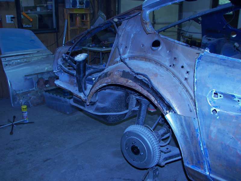

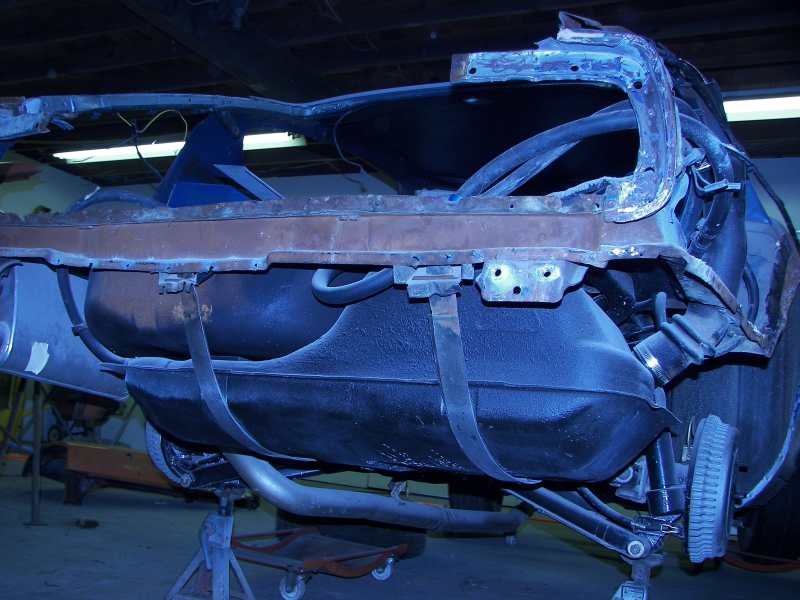

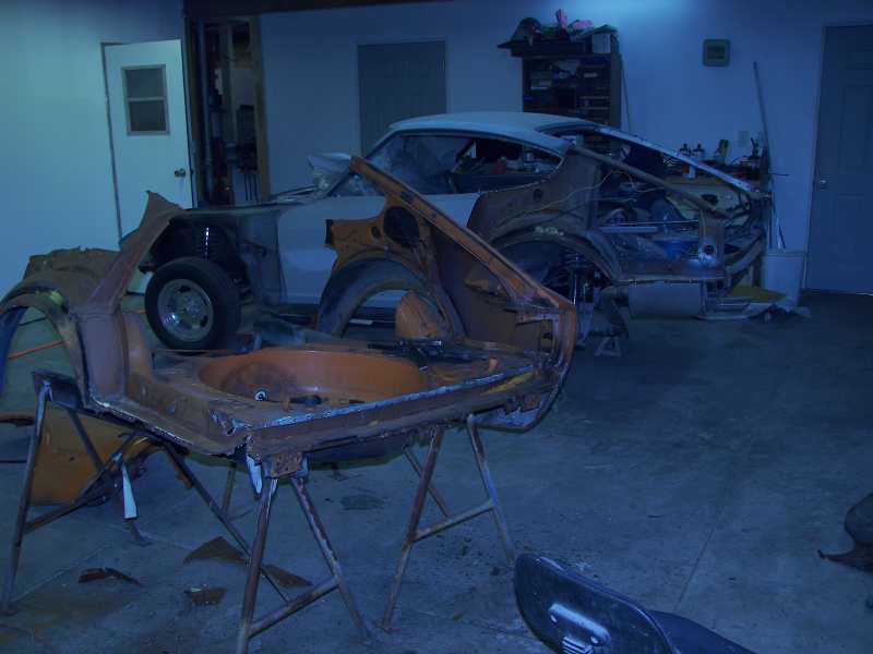

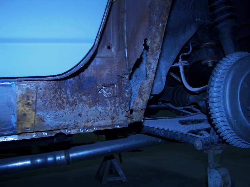

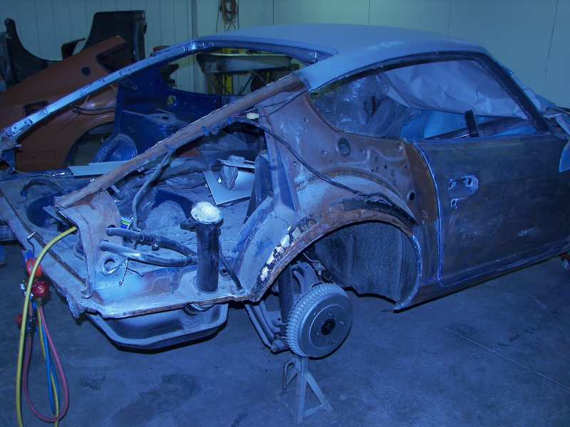

Here are some current pictures of a Recently "Fully Restored, better than New" car bought from a "licensed Datsun Restoration Business". These pictures are of the corrective work required after the California/Nevada shop sold the car as being completely restored. I took the pictures on July 2nd 2009.
They seem to fit the gist of this thread.
WIll

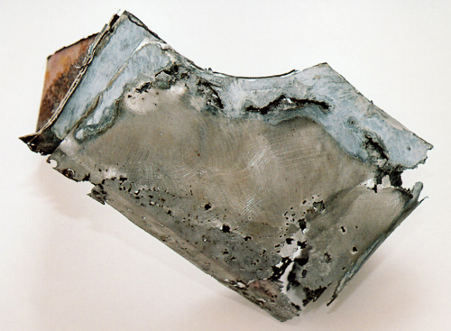

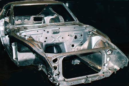

This topic is the very reason I had 26th dipped. She was rusting from the inside out and total submersion was the only way to derust her. And I'll take Diseazd's comments a step further and say that the seam sealer used by the factory when these chassis were constructed did not particularly last long. It dried and cracked. Indeed the area of the dog leg inside the wheel arch is a water-catcher and not sealed very well at all. Heres a shot of the chunk I took out.
I used a garden type pump spayer with one of those long plastic wands to spray primer / sealer up inside the chassis as best I could reach. Then after that mess dried, I srubbed the outside down and sealed up all the seams by hand.
Will, in one of your pictures, there is a black strip over the inner fender well where it would touch the outer skin. Is that tar mat insulation?
Chris,
It looked like it, but I didn't take a good look or feel. I'm headed back out there on Monday, and I'll give it a thorough examination.
Will
