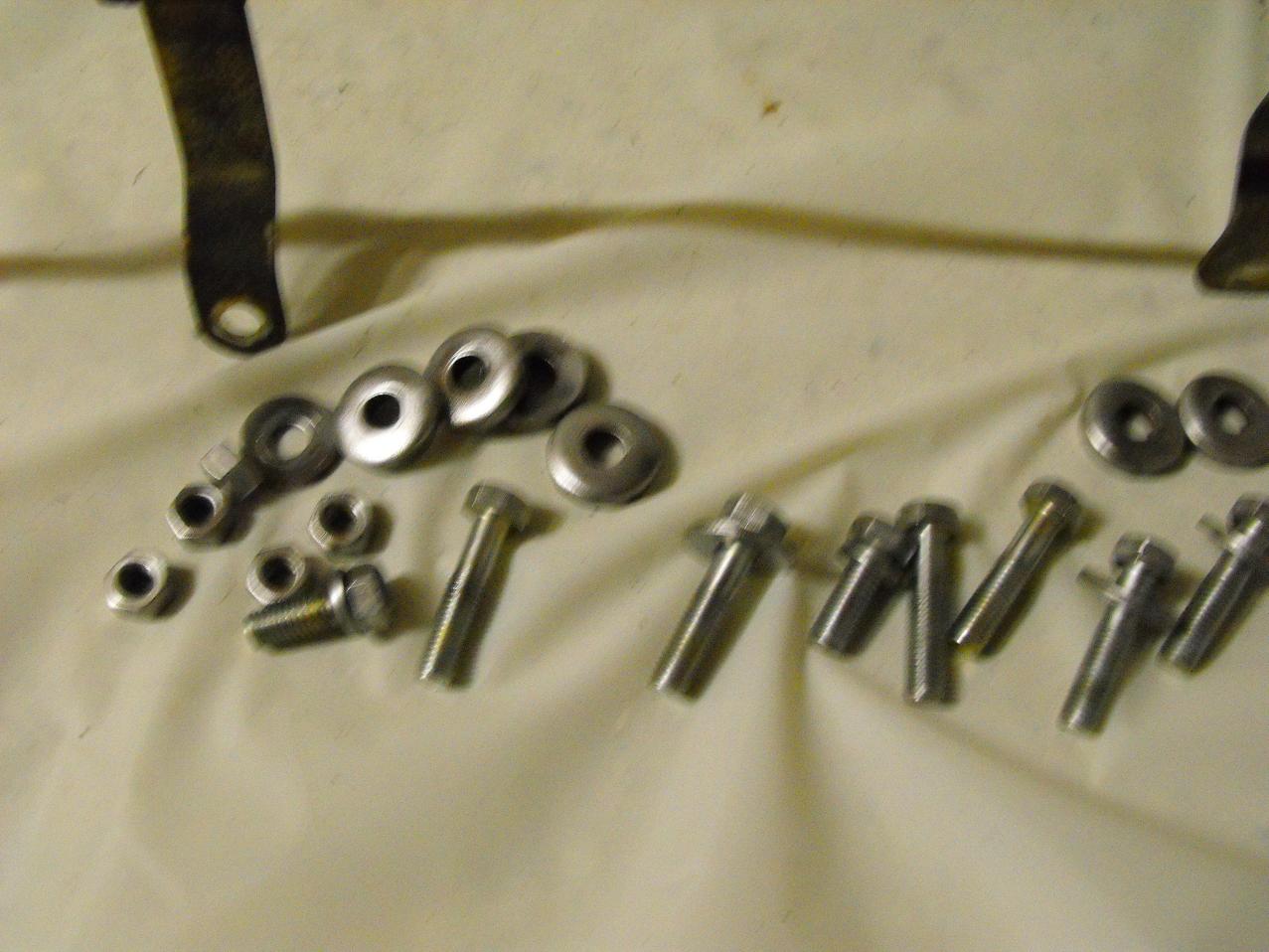

June 15, 200915 yr comment_286771 I got all the bolts, washers, screws, hose clips and various other bits back from the platers and the results are amazing. However, I did a lot of prep. The more you do the better they will turn out.My process.1. Gave them all a soak in the parts cleaner. Kerosene and solvent.2. Removed surface rust and remaining dirt with a bench grinder mounted wire wheel3. Treated any hard to get to rusty parts with rust killer and used a tiny wire brush to get it in.4. Gave them to my local Datsun club "good bastard" who works at the platers.5. He wasn't happy with how some of them turned out so he re-plated those.Good luck.James Link to comment https://www.classiczcars.com/forums/topic/32197-1970-z-refreshbiting-the-bullet/?&page=2#findComment-286771 Share on other sites More sharing options...
June 15, 200915 yr comment_286780 motorman7, don't forget the nuts and washers on the top of the struts, they will look out of place with everything else plated like new if not done. Link to comment https://www.classiczcars.com/forums/topic/32197-1970-z-refreshbiting-the-bullet/?&page=2#findComment-286780 Share on other sites More sharing options...
June 15, 200915 yr Author comment_286782 motorman7, don't forget the nuts and washers on the top of the struts, they will look out of place with everything else plated like new if not done.Thanks, I probably would have overlooked those. I also need to take off the plate for the windshield washer fluid lines. Will do a careful final check before I take everything in. Thanks for the heads-up, Rich Link to comment https://www.classiczcars.com/forums/topic/32197-1970-z-refreshbiting-the-bullet/?&page=2#findComment-286782 Share on other sites More sharing options...
June 15, 200915 yr Author comment_286783 I got all the bolts, washers, screws, hose clips and various other bits back from the platers and the results are amazing. However, I did a lot of prep. The more you do the better they will turn out.My process.1. Gave them all a soak in the parts cleaner. Kerosene and solvent.2. Removed surface rust and remaining dirt with a bench grinder mounted wire wheel3. Treated any hard to get to rusty parts with rust killer and used a tiny wire brush to get it in.4. Gave them to my local Datsun club "good bastard" who works at the platers.5. He wasn't happy with how some of them turned out so he re-plated those.Good luck.JamesThanks James! I will begin this process shortly.Best Regards, Rich Link to comment https://www.classiczcars.com/forums/topic/32197-1970-z-refreshbiting-the-bullet/?&page=2#findComment-286783 Share on other sites More sharing options...

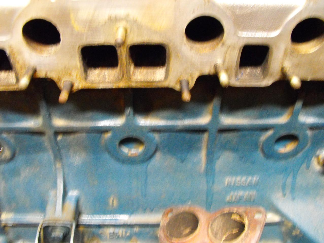

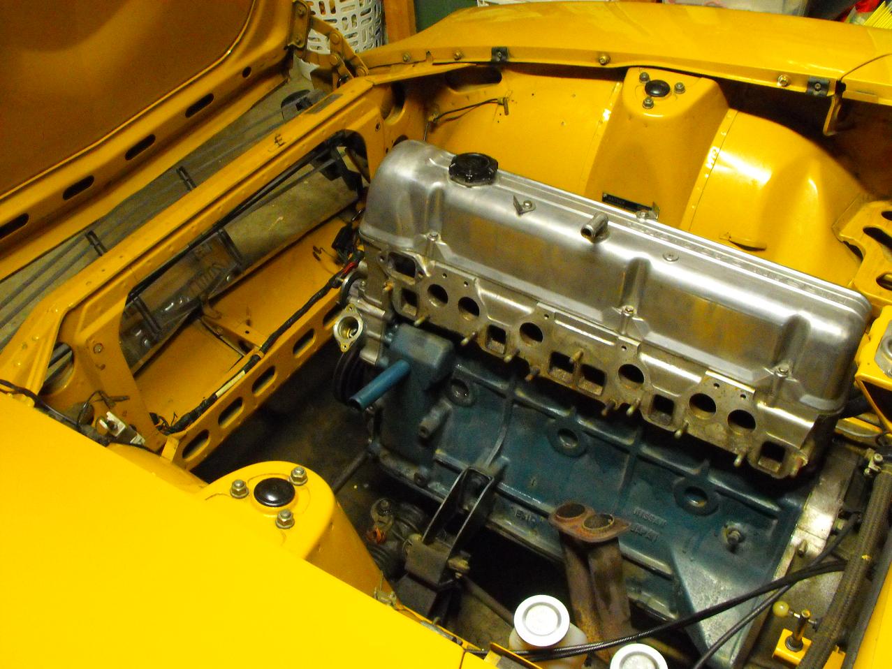

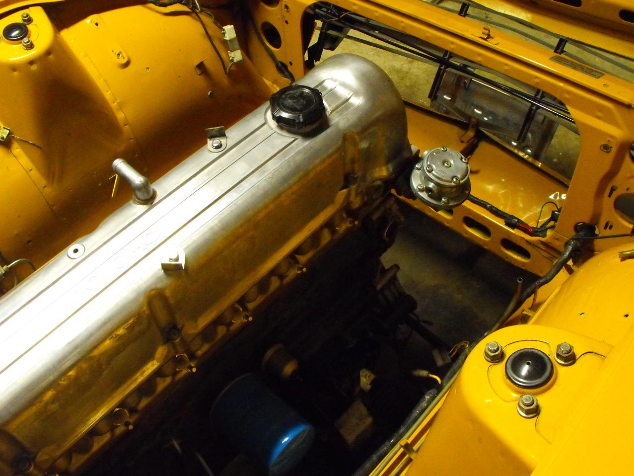

June 16, 200915 yr Author comment_286854 I cleaned up most of the engine bay paint with Maguires cleaner wax this evening. Still have more to go but got about 75% of it cleaned. Still have a lot of little detail areas but not bad. The engine (Carb side) cleaned up well but took a lot of effort. I used mineral spirits on the paint and greasey areas; 0000 steel wool and lacquer thinner on the corroded aluminum. That came out pretty well but is a lot of work. Probably less than halfway done with this. Was surprised at the poor paint job on the engine block. There are paint drips. Perhaps it was painted on a Monday at the engine shop. I did get two more of the smog rail fitting loose. Four down, two to go. It's nice to have a 17 year old son to help. He works in exchange for letting him drive the car on occasion. He did a nice job cleaning the nuts and bolt with wire wheel in prep for zinc plating. Rich Link to comment https://www.classiczcars.com/forums/topic/32197-1970-z-refreshbiting-the-bullet/?&page=2#findComment-286854 Share on other sites More sharing options...
June 16, 200915 yr comment_286895 Hi Rich. Just as we said at the last show, once you start it is impossible to stop. Get some blue engine paint from Les while at his shop, you will be glad that you did. Looking forward to seeing the final product.Randy. Link to comment https://www.classiczcars.com/forums/topic/32197-1970-z-refreshbiting-the-bullet/?&page=2#findComment-286895 Share on other sites More sharing options...
June 16, 200915 yr Author comment_286897 Hi Randy, Nice to hear from you again. Funny thing about the engine paint here. I am wondering if this is the norm. Actually, right now I am debating on what to do with this. I almost want to keep it because it is original and so bad. The coverage is pretty complete and there does not seem to be any corrosion set in. I was actually debating on whether to just give it a clear coat instead of the true paint color. As everything else on the car is original, I am now wondering if painting this is a good idea. I will think about it here for a while as I have time and am in no rush. Will spend time prepping the zinc parts and continuing the clean. I hope to get my zinc parts looking as good as yours. Best Regards, Rich Link to comment https://www.classiczcars.com/forums/topic/32197-1970-z-refreshbiting-the-bullet/?&page=2#findComment-286897 Share on other sites More sharing options...
June 16, 200915 yr comment_286899 If you have re-plated the bolts/nuts/parts - and cleaned the aluminum up - - you may as well re-paint the block the original color.FWIW,Carl B. Link to comment https://www.classiczcars.com/forums/topic/32197-1970-z-refreshbiting-the-bullet/?&page=2#findComment-286899 Share on other sites More sharing options...
June 16, 200915 yr comment_286903 Rich. I understand you hesitation. I had it when I started my refresh. Remember it is only "original" once. If you start replating your Z it will no longer be original. And the bad exisiting paint on the block will make it look like you scimped on the "refresh". Been there, done that. Your choice, but just trying to give you another viewpoint. You will still be able to claim all original parts, or mostly so....I do! Link to comment https://www.classiczcars.com/forums/topic/32197-1970-z-refreshbiting-the-bullet/?&page=2#findComment-286903 Share on other sites More sharing options...
June 16, 200915 yr Author comment_286904 Yes, that makes sense. I will go ahead and 'refresh' the block with paint. I guess it just had that 'ugly puppy' attraction, that's why I was hesitant.Thanks for the feedback Link to comment https://www.classiczcars.com/forums/topic/32197-1970-z-refreshbiting-the-bullet/?&page=2#findComment-286904 Share on other sites More sharing options...
