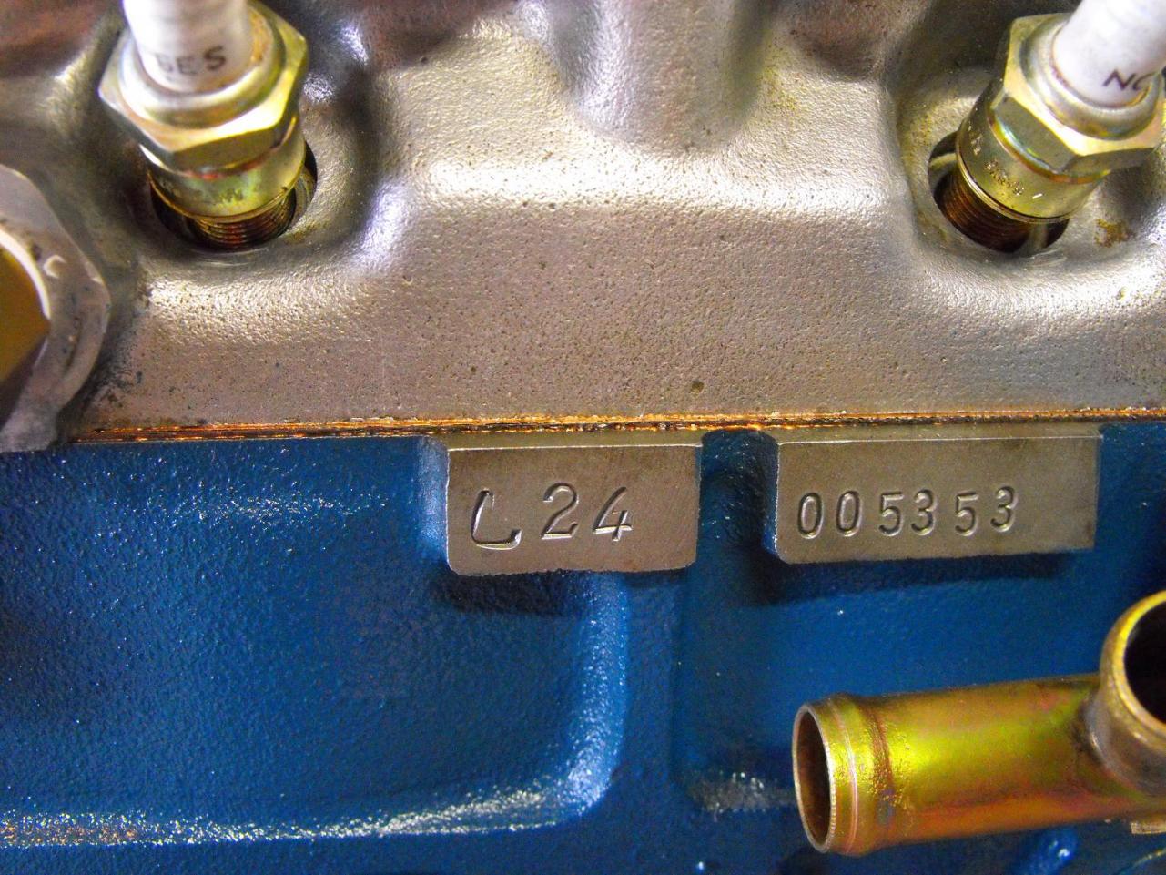

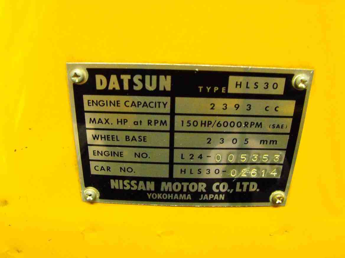

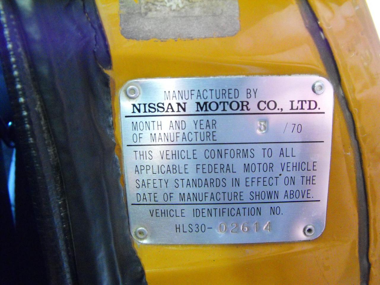

Hi All,
Just thought I'd post the tags and numbers since they were easily accessible (and look cool of course).
The head had 2 different size bolts. 5 long that were on the cam towers, the rest were short.
