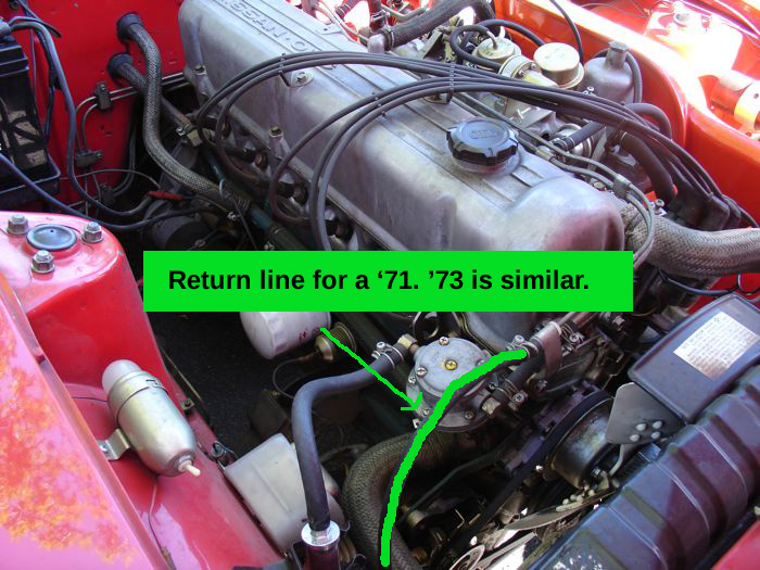

June 15, 200915 yr comment_286786 correct the line comes in on the rail then there is a distro block with line going back. I just did not know how effective it is. My carbs are getting hot as sin with the header i have. No vapor lock no driving issues and i have a 280 hood. Just wanted to make sure i had a nice fresh flow of fuel in and out. I added a electric pump from a old rx7 i had here in the rear to boost flow.If you are talking about the line on the left side of the car, that's not the return line. The real return line is on the other side of the car, comes up right next to the fuel supply. The supply goes to the filter and then the pump on its way to the carbs, the return line connects directly to the small tube on the fuel rail. Link to comment https://www.classiczcars.com/forums/topic/32202-73-240z-easiest-way-to-run-return-line-for-fuel/#findComment-286786 Share on other sites More sharing options...
June 15, 200915 yr comment_286788 A picture is worth many words.... Link to comment https://www.classiczcars.com/forums/topic/32202-73-240z-easiest-way-to-run-return-line-for-fuel/#findComment-286788 Share on other sites More sharing options...
