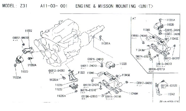

Hi Ivan, you say your manifold is 15mm to tall for your bonnet ?
if you rework your engine mountsyou wil get it to fit fine. Ive used the RB30 block with the RB25 head and manifold, which is 40mm taller than the RB25 block and i have 10mm clearance over the throttle body.
