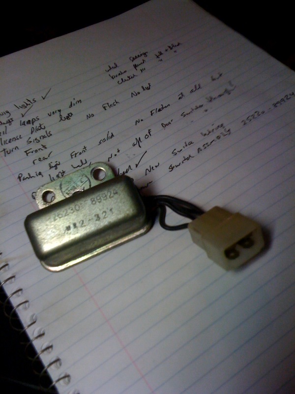

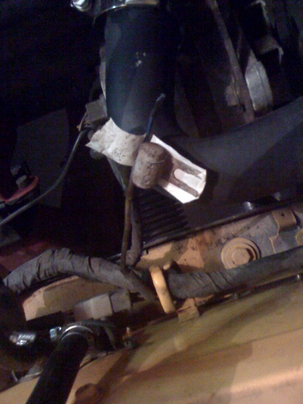

Posted June 20, 200915 yr comment_287329 While I am waiting on some help welding up my frame I am tackling my wiring issues. I am not sure what these parts are for, could you please help me ID them? Pic 1 is attached to a blue wire, but the round end has broken off. Can I simply solder this back together? Can I/should I order a new one? Pic 2 was in the car's spare parts pile, but I cannot find anything while digging through the FSM. Courtesy Nissan and a google search show it as a repair assembly? What for Pic 3. I dont see my yellow black oil pressure sender wire anywhere. Also, I can't figure out what the little rubber cap is for. It has to Red/blue wires. Thanks Link to comment https://www.classiczcars.com/forums/topic/32277-help-me-id-these-electrical-components/ Share on other sites More sharing options...

June 20, 200915 yr comment_287348 1 is a condensor and it is replacible, I could have sworn it was on a black wire but I could be wrong. It's typically mounted to the same bolt as the Voltage regulator. Doesn't matter how you connect it to the correct wire, as long as you connect it.2 looks like an A/C relay. don't take my word for it though. Arne would know before me.3 are you sure it's not a Yellow/white wire? like the insolated one near the motor mount?Your turn signal flasher might also be in the upper left hand kick panel area and has a white, 2 wire connector. So if it's not on the steering column support, look to the left. Link to comment https://www.classiczcars.com/forums/topic/32277-help-me-id-these-electrical-components/#findComment-287348 Share on other sites More sharing options...
June 20, 200915 yr Author comment_287360 I checked around at the Z store and didn't see anything for a condensor. though I will try to solder this one back up. I do have an uninstalled factory air kit and that may have gotten seperated from the rest of it. I will check the part list for it and see if it matches anything there. Does anyone want that? Also, I was able to clean up the wire better by the mount a bit better and I think it is yellow/black after all. It just has the wrong end on it and that through me off. I havent had time to check out the flashers yet, but will shortly. Thanks again Link to comment https://www.classiczcars.com/forums/topic/32277-help-me-id-these-electrical-components/#findComment-287360 Share on other sites More sharing options...
June 21, 200915 yr comment_287433 I think #2 is one of the relays on the passenger side kick panel just below the dash. The automatic cars had a starter interlock relay over there. The hazard relay on my '73 looks like that and it's over on the pass kick panel. Link to comment https://www.classiczcars.com/forums/topic/32277-help-me-id-these-electrical-components/#findComment-287433 Share on other sites More sharing options...
June 26, 200915 yr Author comment_287954 I have officially ID'd number 2....it is the accessory relay. Having plugged it in I now have windshield wipers! THough they appear to be very slow and don't even have the wiper arms attached yet!I have hooked up my hazard flasher, but still dont have any turn signals. My hazards also work. According to my haynes manual a white wire and green wire should go for the turn signal flasher and I have a set on the driver's side, but when connected to the heavy duty/hazard flasher I still get nothing. I would've anticipated a fast flash at least.I managed to connect the oil pressure sender as well and while I am not getting any pressure the gauge at least works when I ground it out. Thanks for your help so far. Link to comment https://www.classiczcars.com/forums/topic/32277-help-me-id-these-electrical-components/#findComment-287954 Share on other sites More sharing options...
