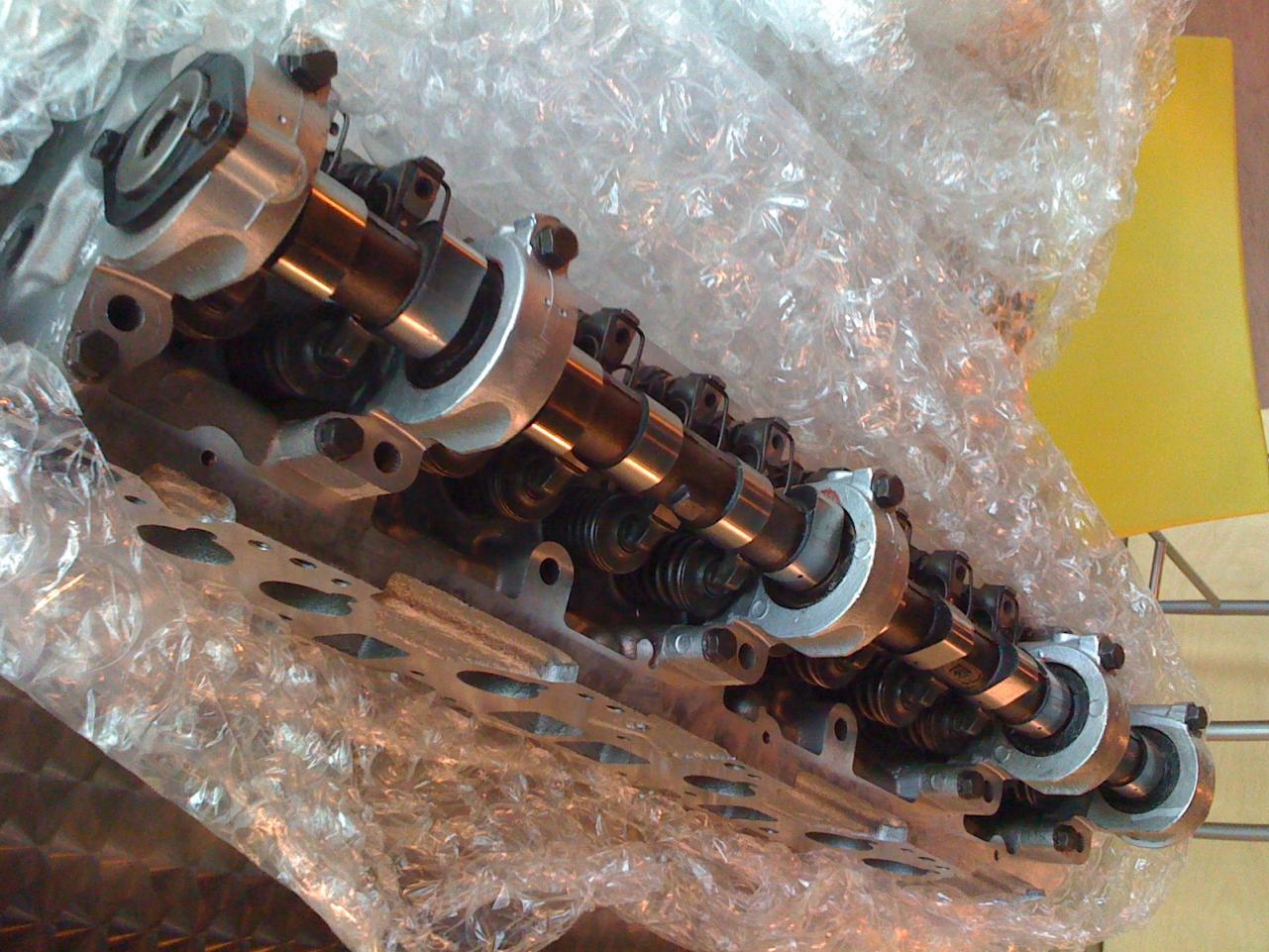

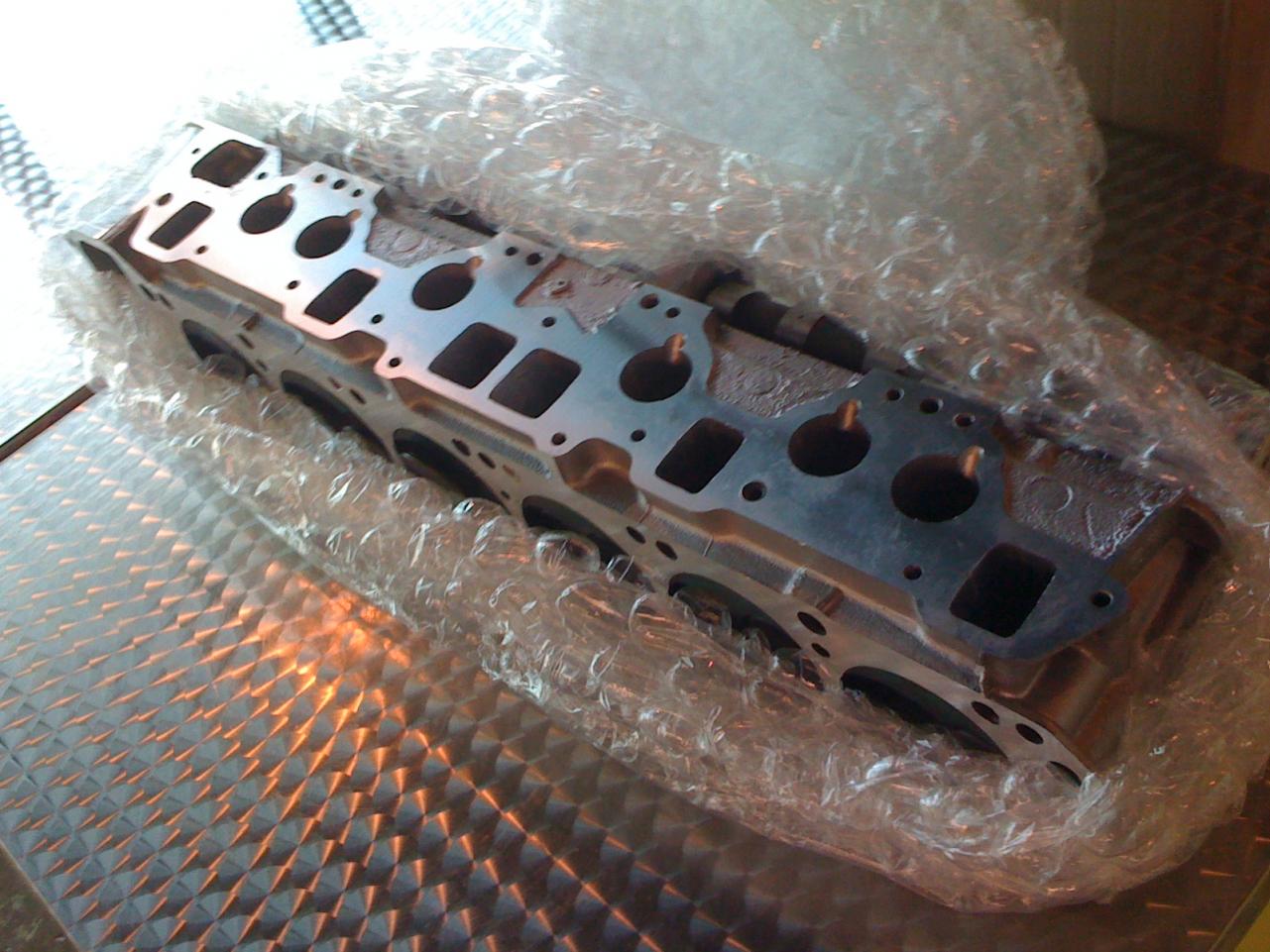

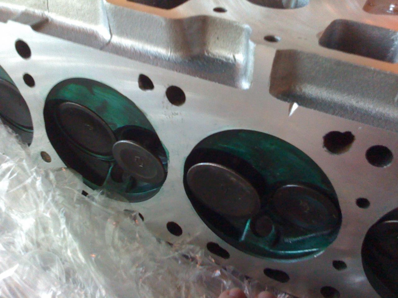

the head just got here today. it's an N42, and by sight, it looks really good. there are one or two chinks here and there; one on the edge of a lobe, another on the edge of one of the exhaust ports. but overall, it looks good. it's got the double springs.
my question is this: who has bought a head from this guy, and if you had problems with it, what were they? i'm going to have it checked out by the shop i go to, and i'd like to have something to tell them to look for.

ok, so i've found the first problem. the head got here without an oil line, and i assumed that that was typical, and that i would just put my old one on. i guess i should have thought about the fact that i never told him that i still have my old head. anyway, i took my oil line off the old head and walked over to put it on the new one, and lo:
it has no holes in the bosses for the oil line.
before i try to talk to him about this, can someone tell me which head's cam towers do NOT have these holes? i'd like to know what i'm dealing with.
EDIT: did earlier 280z's have no oil line? mine was manufactured in October of '75.

Apparently internal and external oiled cam setups can be swapped on the N42 head. I have a two N42 heads in my garage now. One is internally oiled and the other has the external bar. The head without the bar has oil holes in the cam lobes.
Does the cam in your head have the oil holes?
it does indeed have the oil holes on the lobes. maybe i've avoided catastrophe... do you have any idea if the different setups correspond to when the car was produced?
