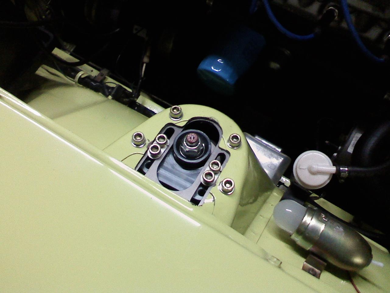

July 15, 200915 yr Author comment_289616 Here's an update on the camber plate installation......I didn't dare put 'em on top......didn't want to take the verbal abuse from you guys!! Will post the pics of the coilovers and brakes later. Thanks for your advice. Guy Edited July 15, 200915 yr by Diseazd Link to comment https://www.classiczcars.com/forums/topic/32373-ground-control-coilovers/?&page=3#findComment-289616 Share on other sites More sharing options...

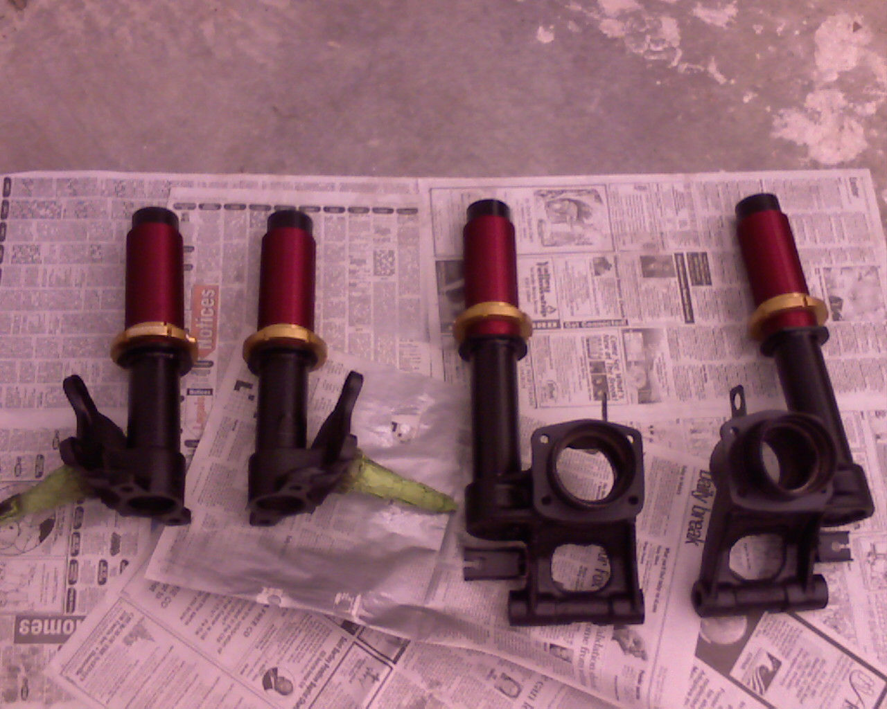

July 20, 200915 yr comment_290024 Hi guysi wanted to add something to this discussion...i am in the process of doing the same mod to my 73 as well.have the struts sectioned and the new perch welded on.Need to worry about the top of the strut towers now as well.it's good to hear you recommend XXX 1/8" plate for the reinforcing plate.XXXanyways, my question here is regarding hubs...can i re-use my 240hubs on the 280 struts or do I need to swap those out to 280 as well?Thanks guys,-e Edited July 21, 200915 yr by EricB I mis-typed Link to comment https://www.classiczcars.com/forums/topic/32373-ground-control-coilovers/?&page=3#findComment-290024 Share on other sites More sharing options...
July 20, 200915 yr comment_290029 it's good to hear you recommend 4 thicknesses of 1/8" plate.I was going to do just a single one...Not sure what you're talking about, but there is no need for 1/2" thick steel on any part of the Z chassis. Link to comment https://www.classiczcars.com/forums/topic/32373-ground-control-coilovers/?&page=3#findComment-290029 Share on other sites More sharing options...
July 21, 200915 yr comment_290095 Jonsorry. I mis-typed. I was referring to the post you have on the previous page about making 4 reinforcing plates from the template and putting them on the underside of the strut tower... my bad.regarding the hubs though, can I use 240Z hubs on 280z spindle/strut housings?Or does everything need to be 280z up front for caliper/rotor to line up right?Thanks,-e Link to comment https://www.classiczcars.com/forums/topic/32373-ground-control-coilovers/?&page=3#findComment-290095 Share on other sites More sharing options...
July 21, 200915 yr comment_290103 I know the hubs have different offsets. Not sure if the caliper brackets have different offsets. I would think the easy thing to do is get some 280 hubs and use 280 brake parts. Link to comment https://www.classiczcars.com/forums/topic/32373-ground-control-coilovers/?&page=3#findComment-290103 Share on other sites More sharing options...
July 21, 200915 yr Author comment_290109 When I ordered my brakes from Arizona Z Dave sent me hardware that worked with 240z hubs. You need to specify which hubs you've got when you order because of the different offsets. I bought the Willwoods. Link to comment https://www.classiczcars.com/forums/topic/32373-ground-control-coilovers/?&page=3#findComment-290109 Share on other sites More sharing options...
July 21, 200915 yr comment_290111 When I ordered my brakes from Arizona Z Dave sent me hardware that worked with 240z hubs. You need to specify which hubs you've got when you order because of the different offsets. I bought the Willwoods.Do the 240 hub parts fit a 280 strut though? The caliper mount (integral to the strut housing) has to be inline too, which is why it is easier/safer to stick with 280 parts or 240 parts, and not mix and match. Link to comment https://www.classiczcars.com/forums/topic/32373-ground-control-coilovers/?&page=3#findComment-290111 Share on other sites More sharing options...
