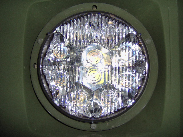

August 29, 200915 yr comment_293229 Have you seen Trucklite's new LED bulbs? Low voltage draw, lexan bulb, 10,000 hour life guarantee. Bright clear light, Best price I've found is $260.00 each, but you do not need any special wiring or switching. The pic is the military version 24 volt, around $450.00 each. Link to comment https://www.classiczcars.com/forums/topic/32389-best-new-headlights-for-a-stock-240z/?&page=2#findComment-293229 Share on other sites More sharing options...
