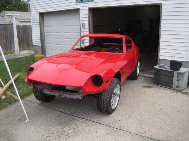

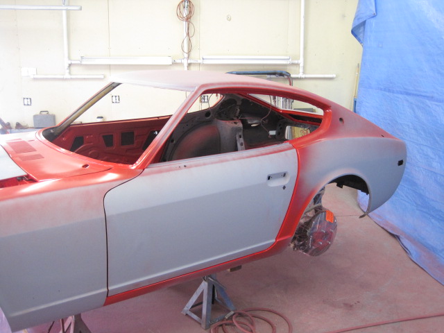

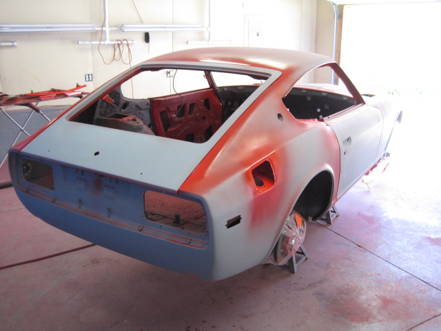

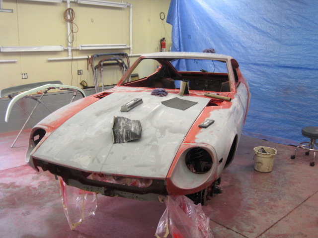

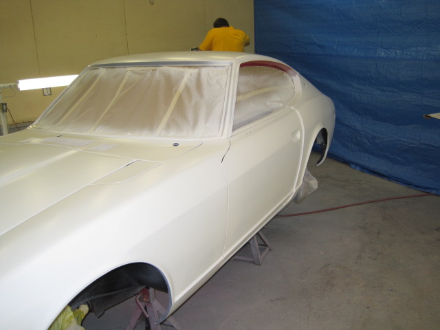

Well I posted those pics of the jam work being done-atleast we thought. After taking a second close look the painter(my best friend) and I decided that there were some discrepencies. Since we are just painting in a garage the lighting isn't the best and that cost us. We had found some areas that just didn't get covered well enough. I hated to complain about a "free" paint job, especially to a great friend, but he knew that he kind of blew it. So he basically shot everything over again, what a difference! If the outside turns out as good as the jam work, we will both be estatic. This weekend is slated for the final work. We promised ourselves that we would take our time and triple check everything, and clean everything 20 times and get this right the first time. At 150$ a quart, you can't waste this red stuff.

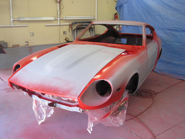

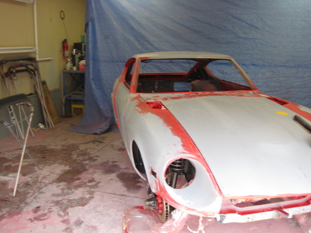

Well my buddy and I spent about 7 hours wet sanding and finishing any minor bodywork that we missed. We are about 4 or 5 hours away from painting-besides the day it will take to clean the garage before painting begins. It is truly amazing the amount of work that is involved in a complete paint job like this. The guys that complain about the cost of a QUALITY paint job, just try it once yourself. My buddy and I were talking about the cost of labor and materials for a paint job of this caliber and we figured 8k+

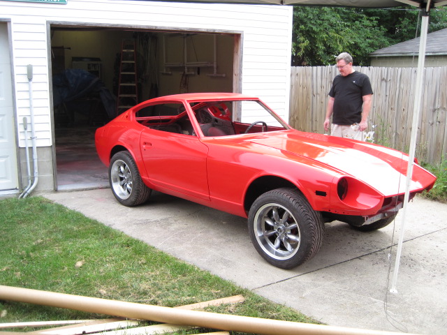

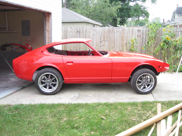

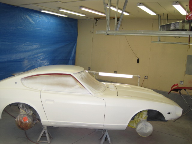

We almost had her done today until the spray gun starting throwing fits with the clear. It was a day of high anxiety because of the unknowns and the high costs of failure. I had never used a sealer before and it was a white tinted sealer to boot. Then there is always the issue of dirt and bugs and spider webbing and runs and ect...

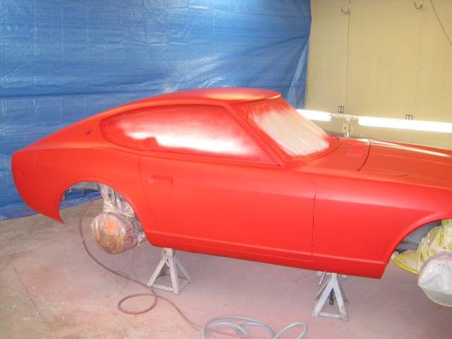

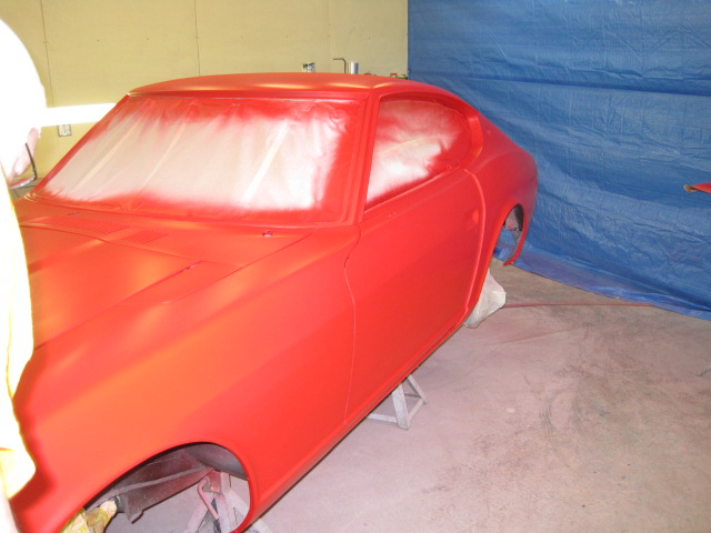

Well the sealer went on weird , but settled out smoothly later. We had a few small runs in the sealer that really didn't show up until we painted the base coat. The base went on well with some weird spider webbing, but we were able to smooth that out too. We(my painter and best friend) were pretty happy by this point because besides the few small issues, this was going pretty good with hardly any dirt at all in the paint.
Then the clear was sputtering and causing bad orange peeling, so my friend gave up for the day. There was a bad run that also needed work, so he said enough until he figured out the issue. Now we will have to wet sand the clear and start over, but I am still very very pleased with how this is turning out-especially the body work-this will be nice!!!!!!!!!!!!!!!!!!!!!:cool:
By the way, the red pics are before clear

I wish you could have here to give some pointers or just tell us that we are screwing up! My friend a difficult time with the clear. First mistake was not using the fish eye reducer. Secondly, we had some kind of reaction or some spray gun disorder. We are using a hvlp -don't know the brand name. Not sure on the pressure, but I would assume according to instructions. Probably waited an hour between the sealer and base-also according to instructions. Base went on pretty smooth, just the urethanes we had the issues with. I think at first he had the wrong tip on the gun-too big.

Pictures can be decieving. The orange peel is narly in spots. I think the problem was clogging and maybe too large of a tip----throw in some humidity and inexperience and bingo. The color is great though and so is the shine, plus there is over a gallon and a half of clear on that car. I could sand forever and never break through. I think it will be great in the end.
