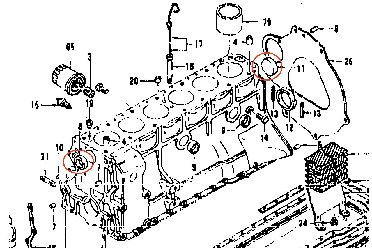

Posted July 7, 200915 yr comment_288882 hey guys, for a L26 block what would be the correct size freeze plugs , 35mm or 40mm, and does anyone know who sells long tube headers for a good price for the L26 Link to comment https://www.classiczcars.com/forums/topic/32448-core-plugs/ Share on other sites More sharing options...
July 7, 200915 yr comment_288925 hey guys, for a L26 block what would be the correct size freeze plugs , 35mm or 40mm, and does anyone know who sells long tube headers for a good price for the L26[/quote35mm. Edited July 7, 200915 yr by Nigel1943 Link to comment https://www.classiczcars.com/forums/topic/32448-core-plugs/#findComment-288925 Share on other sites More sharing options...

July 8, 200915 yr comment_289007 There are different sizes, i got a complete set from northernautoparts.com they don't cost much.ChrisYes, but not in the block, which was the question, 7x 35mm. There is a 50mm one which is for the cylinder head and a 40mm one which I'm not entirely sure where it goes, maybe at the front of the cylinder head. Link to comment https://www.classiczcars.com/forums/topic/32448-core-plugs/#findComment-289007 Share on other sites More sharing options...

July 8, 200915 yr comment_289017 Yes, but not in the block, which was the question, 7x 35mm. There is a 50mm one which is for the cylinder head and a 40mm one which I'm not entirely sure where it goes, maybe at the front of the cylinder head. The 40mm core plug is for the front of the engine block and the 50mm plug fits on the rear of the block. Neither are for the cylinder head. Link to comment https://www.classiczcars.com/forums/topic/32448-core-plugs/#findComment-289017 Share on other sites More sharing options...
