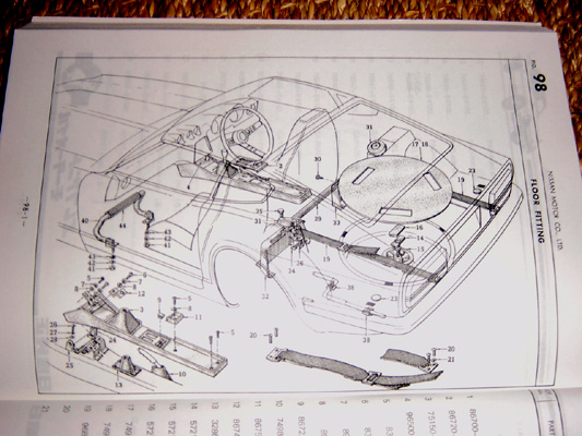

October 18, 200222 yr comment_17229 Hi Nick, I'm also putting an early RHD car back together at the moment ( although mine is an early '70 Fairlady Z-L ). The Factory parts catalogues are useful for seeing what goes where, as they have lots of "exploded views" and of course all the part numbers. I have taken a digital photo of one of the relevant pages that might be of help to you. Here are the part numbers of what you seem to be looking for: *32 ( 74670-E4101 arse'Y-COVER, rear floor "A" ) *33 ( 74675-E4101 arse'Y-COVER, rear floor "B" ) *34 ( 99619-E4101 BELT-tire stopper ) *36 ( 99751-25700 arse'Y-HOLDER, jack ) If you have any other problems I might be able to help. Good luck, Alan T. Link to comment https://www.classiczcars.com/forums/topic/3253-what-goes-where/#findComment-17229 Share on other sites More sharing options...
October 18, 200222 yr comment_17232 Is the passenger side footrest (item No. 40) shown on the scanned parts pic., standard on any or all 240z's ? CheersDazza:beard: Link to comment https://www.classiczcars.com/forums/topic/3253-what-goes-where/#findComment-17232 Share on other sites More sharing options...

October 18, 200222 yr comment_17237 Dazza,The 75500-E4100 "arse'Y-FOOT REST, assistant" was standard on Japanese home-market Fairlady Z-L ( S30 ) and Fairlady Z432 ( PS30 ) models, and an "Option" accessory for the Fairlady Z ( S30-S ) from launch in October 1969. It was also standard on the Fairlady 240Z ( HS30 ) and Fairlady 240ZG ( HS30-H ) when they were launched in October 1971.Japanese "Home" market models of S30-series Z had the reinforced holes in the correct position on the passenger floor - so that the footrest could be a bolt-on if selected. This is one of numerous differences that the Japanese home-market model bodyshells had compared to the "Export" models.Your question about this footrest and the "240Z" would seem to be enquiring as to whether any "Export" models of HS30 and HLS30 had these fitted as standard. The answer is "no" - to the best of my knowledge they were only ever on the Japanese home-market models. I have seen some fitted on Export cars - but they were later additions by the owner, and did not have the correct reinforcement to the passenger floor area around the holes.Nick,I have not seen the Microfiche CD, so I cannot comment apart from saying that I believe it refers mainly to the HLS30 USA / North American market Export cars. The digital photo above, and the information that I wrote, comes from one of the Japanese parts catalogues for the S30 and PS30 models ( NISSAN MOTOR CO. LTD. publication no. C-187 ) which is mainly in Japanese. It does not cover the Export HS30 models ( although the Japanese home-market HS30 series cars are covered in publication no. C-236 and these have many similarities with the early Export HS30 models ).These parts catalogues ( they are not workshop manuals ) are invaluable if you have anything other than an HLS30, as they contain a wealth of information and all the original part numbers. They even have a lot of the Competition and Sports Option parts in them. My Z432-R replica project would struggle without these as reference.All the best,Alan T. Link to comment https://www.classiczcars.com/forums/topic/3253-what-goes-where/#findComment-17237 Share on other sites More sharing options...
