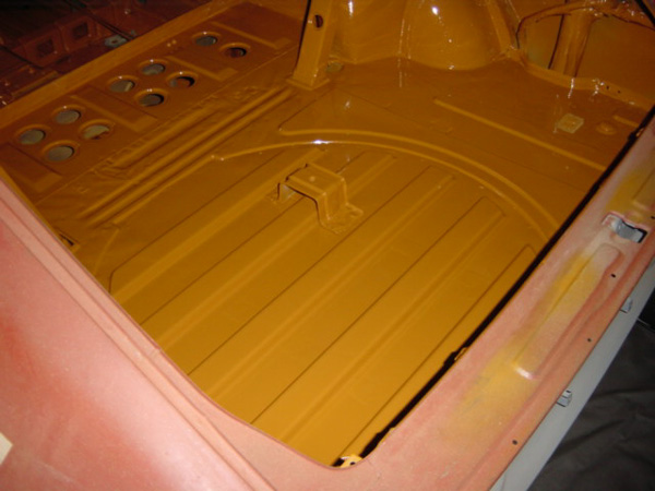

October 19, 200222 yr comment_17292 Alfadog,The "other" car ( an early 1970 Fairlady Z-L that is metamorphosing into a Z432-R replica ) is now in the queue at the body shop awaiting paint ( 920 Gold ). It probably will not get painted before Christmas now - but that suits me as it means that I will not have to pay for the paint job until its done!I've also got lots of money to find for other parts of the project ( like a full rebuild, including new cylinder liners and pistons, on an S20 twin cam engine ). I've already got a ton of special stuff for it, but its all stashed away awaiting the return of the rolling bodyshell.It's going to have a replica of the 100 Litre fuel tank ( I was given a present of a super-rare 100 Litre tank gauge in Japan ) and it already has the spare wheelwell deleted and the flat floor to make room for it. The idea is to make a 432-R with all the trick bits, but at less than a quarter of the cost of a real one. There are myriad differences between a PS30 and a PS30-SB, let alone between a PS30 and an S30 - so hunting them all down or replicating them is like archaeology ( or Carchaeology, as I like to say ).All this and "her indoors" still does not know about the project yet!.........Regards,Alan T. Link to comment https://www.classiczcars.com/forums/topic/3253-what-goes-where/?&page=2#findComment-17292 Share on other sites More sharing options...
October 19, 200222 yr comment_17296 Here's a pic of what the rear floor area looks like at the moment: Link to comment https://www.classiczcars.com/forums/topic/3253-what-goes-where/?&page=2#findComment-17296 Share on other sites More sharing options...
