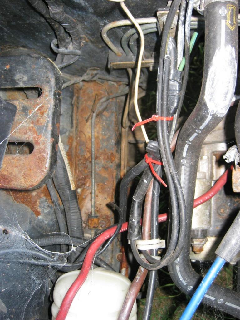

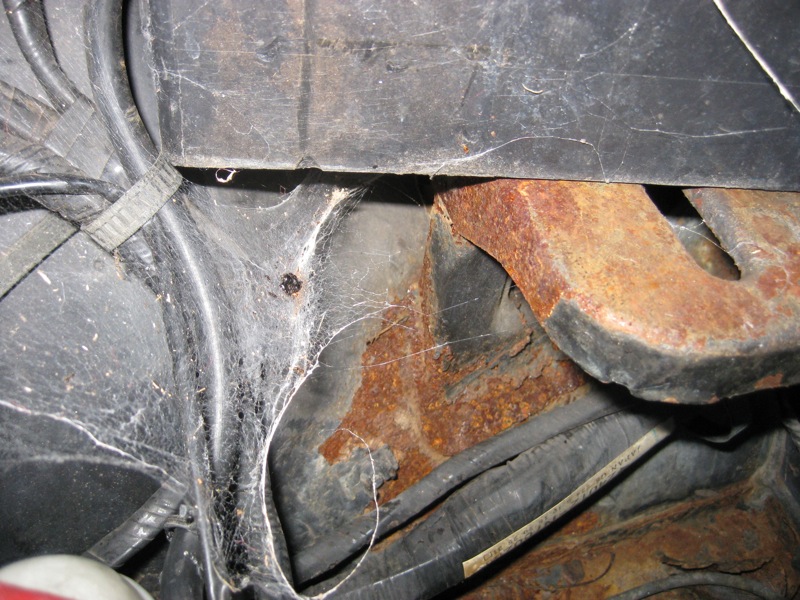

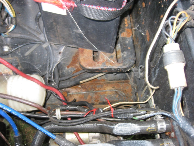

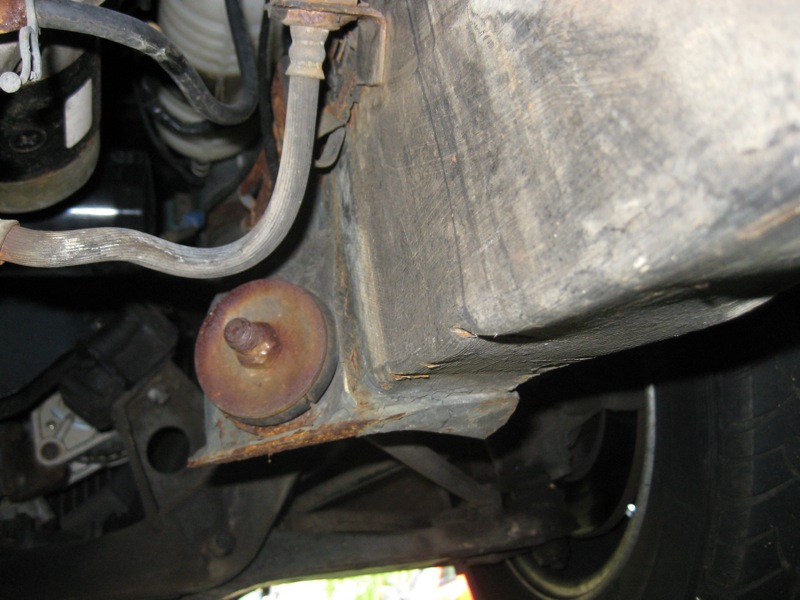

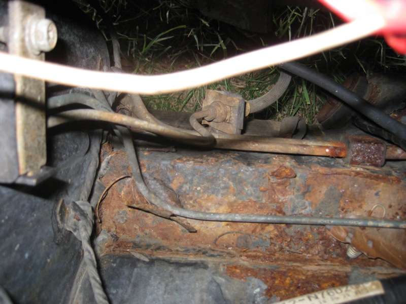

The good thing about the car is it's overall rust free. The seller claims it's been garaged most of it's life. The underside looks really solid as well as the doglegs and rockers. There is a bit of bubbling on the lower quarter panel next to the muffler. The floor boards, driver and passenger, both have one icepick sized whole, but look solid otherwise. The only big issue is the battery tray area. Seller claims it was recent, from, go figure, a leaking battery. I've taken some photos, and advice on how bad it looks would be appreciated. It seems to be just surface rust right now, the rails seem to be solid from tapping on them. But this is the only one I've seen, so...?

The battery tray rust is there, but there don't seem to be any perforations so you could clean up the area and probably be alright...
I would really look into the floor issues. Pinhole rust throughs are usually evidence of a lot of bad stuff to come...
No power steering is correct...you should see the biceps at club meets...
Your budget is tight but not impossible. Truly and completely rust free (but needing paint) will be more and a 240Z slightly more again. This car would seem to be about right for the price assuming the floors are not really too rough.
