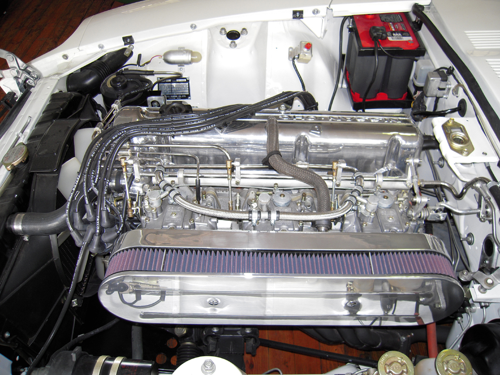

fixitman Posted July 23, 2009 Share #18 Posted July 23, 2009 A similar style air cleaner for triple Mikunis is shown in the attached photos. It was purchased from Jim Wolf's Import Auto Center in the 80's. The air filter is a K&N model E-2950, used in a Lamborghini Countach S. Fixitman Link to comment Share on other sites More sharing options...
datrod Posted July 23, 2009 Share #19 Posted July 23, 2009 A similar style air cleaner for triple Mikunis is shown in the attached photos. It was purchased from Jim Wolf's Import Auto Center in the 80's. The air filter is a K&N model E-2950, used in a Lamborghini Countach S.FixitmanWow that's a nice one. And from the 80's no less. Looks to be sheetmetal. Link to comment Share on other sites More sharing options...
fixitman Posted July 23, 2009 Share #20 Posted July 23, 2009 Wow that's a nice one. And from the 80's no less. Looks to be sheetmetal.[/quoteAluminum sheet actually. Your air cleaner is very nicely done. What is the material? How did you make it?Fixitman Link to comment Share on other sites More sharing options...
datrod Posted July 23, 2009 Share #21 Posted July 23, 2009 Wow that's a nice one. And from the 80's no less. Looks to be sheetmetal.[/quoteAluminum sheet actually. Your air cleaner is very nicely done. What is the material? How did you make it? Fixitman Thank you. It's made of 6061-T6 Aluminum. Machined on my Haas VF3 CNC. Link to comment Share on other sites More sharing options...
=Enigma= Posted July 24, 2009 Share #22 Posted July 24, 2009 NIce work on the air cleaners. Add some ram stacks and you'll be good to go. Link to comment Share on other sites More sharing options...
fixitman Posted July 24, 2009 Share #23 Posted July 24, 2009 NIce work on the air cleaners. Add some ram stacks and you'll be good to go.The Mikuni velocity stacks that came with the carbs are mounted inside this air cleaner.Fixitman Link to comment Share on other sites More sharing options...
