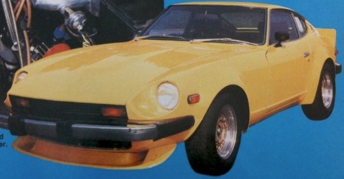

Check out this picture. It's from a 1976 issue of Hot Rod magazine, and it depicts a '76 280Z with a BRE-style air dam. So I know they were once available for the 280Z.

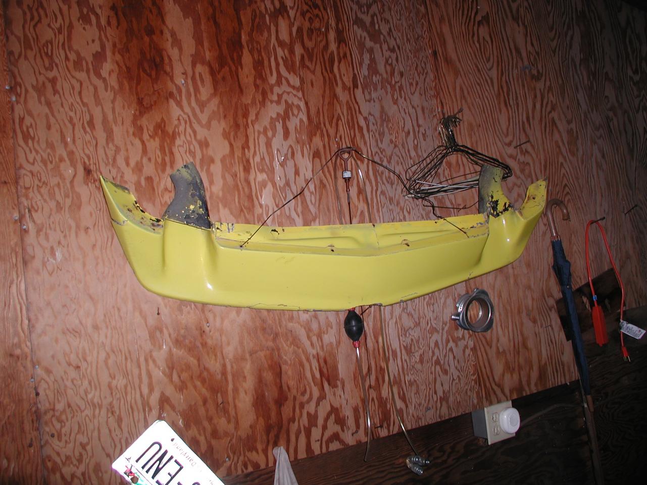

We sell the 280Z BRE style spoiler and even though it is no in our site yet it is the one in your photo. They cost $185 plus shipping and have the ducts just like your photo and fit the later much rounder lower valance of the 280Zs.

I am sorry but at this point I only have the one shown on the yellow car in the earlier post but I plan to see if there would be enought market for some 280 fiberglass items and maybe Carl can be talked into loaning his spoiler for a mold. I personally preferr ducts as the brake cooling is an important part for me and I like functional parts. I have one 280 Ducted spoiler in stock at this time. Thanks

I like the look of the 280 in the picture but it also has a fender package and a rear spoiler that add to the look. Don't think I would go that far.

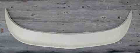

I just noticed that Motorsport is selling a BRE-style air dam in fiberglass or carbon fiber. I'm seriously considering one of the fiberglass dams.
How much work is it to install one of these? I'd imagine it involves some measuring and drilling.

Test-fitting, clamping, positioning, patience. I used body work vice grips and c-clamps to test fit and position. My dad helped me position it and hold it. It definitely helps to have a friend/helper.
I trimmed mine in a couple spots to get it just where I wanted it. I bought some M6 black oxide bolts, nuts, and fender washers from ACE Hardware. It's dark outside and I can't remember how many but I'm thinking I have 6 or 7 bolts for the mounting. I drilled the holes and bolted it up. It wasn't perfectly flush with the clamps but the bolts pulled it flush to the valance. It's not going anywhere and it made a noticeable difference in freeway manners. It feels more composed and less prone to wander or wind influence. It's hard to describe if you've never added a front spoiler. Pics are in My Z Photos
