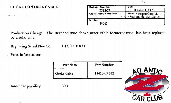

August 5, 200915 yr comment_291229 Technical Service Bulletin TS70-37, dated October 1970 shows the stranded wire replaced by solid wire begining with HLS30-01831. The part number referenced is 18410-E4502. I don't think anyone is going to find stranded wire cables new. Link to comment https://www.classiczcars.com/forums/topic/32722-240z-choke-cable-sticking/?&page=2#findComment-291229 Share on other sites More sharing options...
August 7, 200915 yr comment_291393 Engine - section 16 - Accelerator pedal, Choke & throttle controlThe parts manual shows lots of different part numbers for the choke assemblies, with overlapping date ranges. In addition to the ones I gave you before there are 7 others for the L24 shown, including 18410-E4502 for automatics from 2/70 to 2/71 and 18410-E8803 for manuals from 6/70 to 7/73.I think the only difference in 240Z choke cables is that the earliest cables were made of wire strands and the later ones were one solid cable. The later ones hold up better.-MikeWhere is the best place to purchase the replacement cables?Thxs in advanceJoel Link to comment https://www.classiczcars.com/forums/topic/32722-240z-choke-cable-sticking/?&page=2#findComment-291393 Share on other sites More sharing options...
