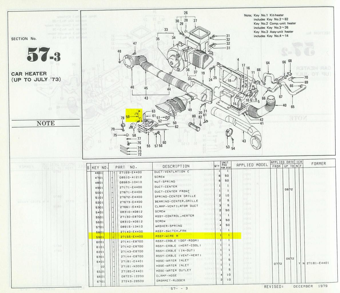

I have another part to add here, it's a section of wiring with a part number 27155 E4400 which I was also unable to locate via Google.

Texasz,
I can't help with the first part number, but 27155-E4400 is a fan switch cable (see fiche scan) for cars up to July 1973. The fiche I have applies to right hand drive cars, so I am not sure if the same part number applies to left hand drive vehicles.

Texasz,
Thank you for the info and the support document, that's perfect.
