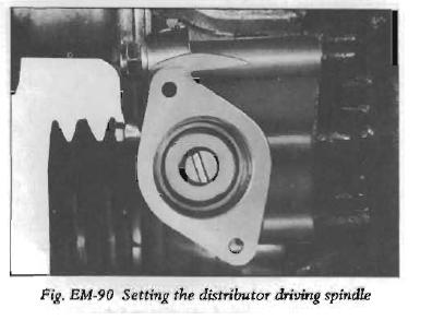

August 30, 200915 yr comment_293263 Hi Frankie, Just finished doing the timing chain, crank and cam, on my L26 and posted them on this thread with a number of pics. http://www.classiczcars.com/forums/showthread.php?threadid=35670 Hopefully that helps a bit. The fact that you got a couple pops seems somewhat promising. I am wondering if your oil pump/distributor timing was 180 out. As the slotted tab is offset, at 11:25, the key needs to be more on the 7 to 8 o'clock side than the 2 to 3 o'clock side. I hope that makes sense. see pic. Be careful moving a couple links. If you are off, you can bend valves. Link to comment https://www.classiczcars.com/forums/topic/32908-cam-crank-timing-off/?&page=3#findComment-293263 Share on other sites More sharing options...
August 30, 200915 yr Author comment_293272 the distributor fits right on the shaft only one way, or 180. but it was at 1 on the distributor when i hooked it up to tang, and that was at 11:25could it be the cam is off and the cyclinder isn't air tight when the spark is ignited Link to comment https://www.classiczcars.com/forums/topic/32908-cam-crank-timing-off/?&page=3#findComment-293272 Share on other sites More sharing options...

September 1, 200915 yr Author comment_293508 ITS ALIVE!!!!!!!!!!!!!! This mechanic came over and had it running in 20 minutes, I had the distributor 180, Sorry you were right Motorman :stupid::stupid:I felt so dumb, he kind of looked at me like, "you called me over here for that?"Now for tuning the carbs, she reved up real high when i got her running so im gonna resort to my z therapy video now for help.Thanks everyone for you inputFrankensteinz Link to comment https://www.classiczcars.com/forums/topic/32908-cam-crank-timing-off/?&page=3#findComment-293508 Share on other sites More sharing options...
