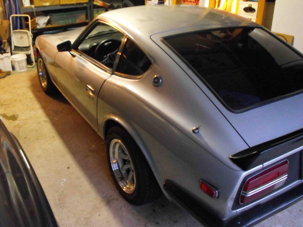

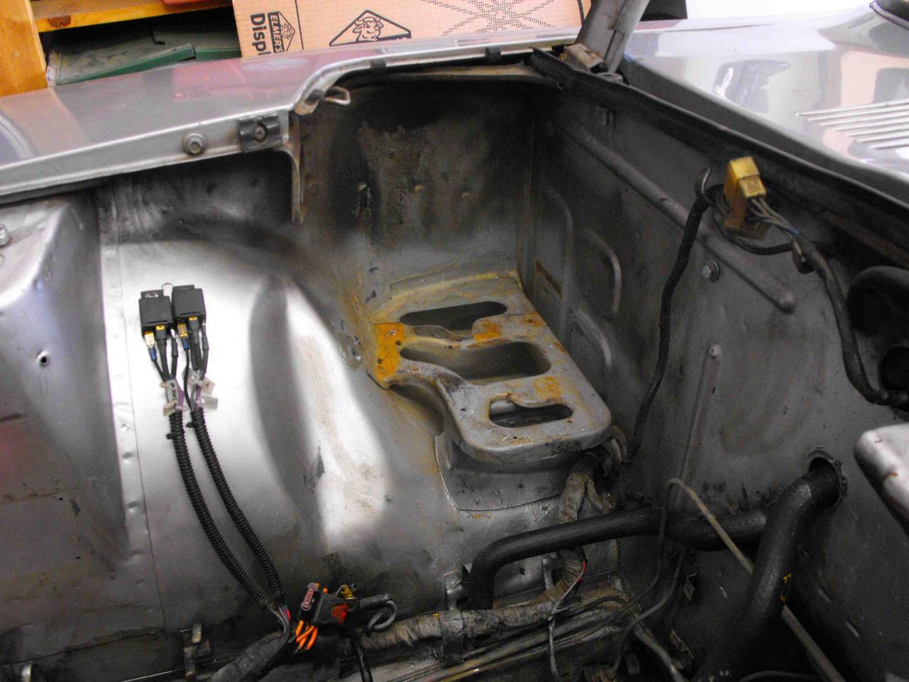

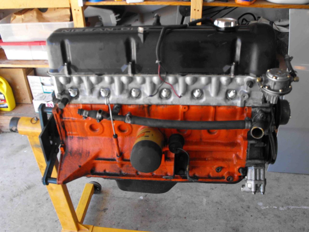

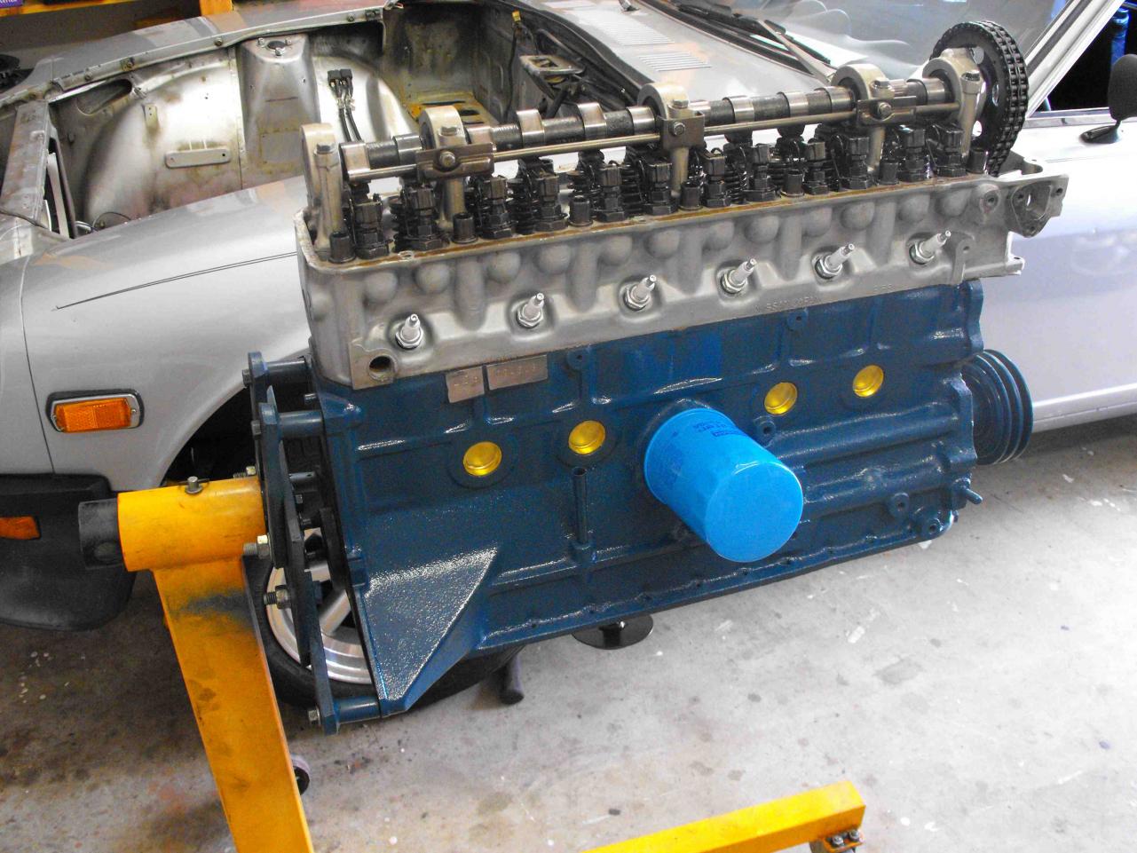

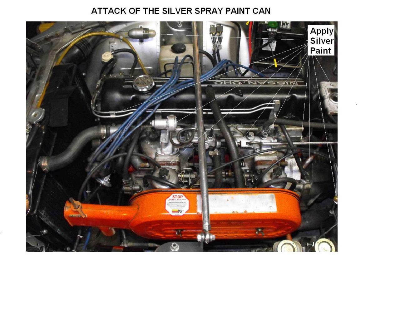

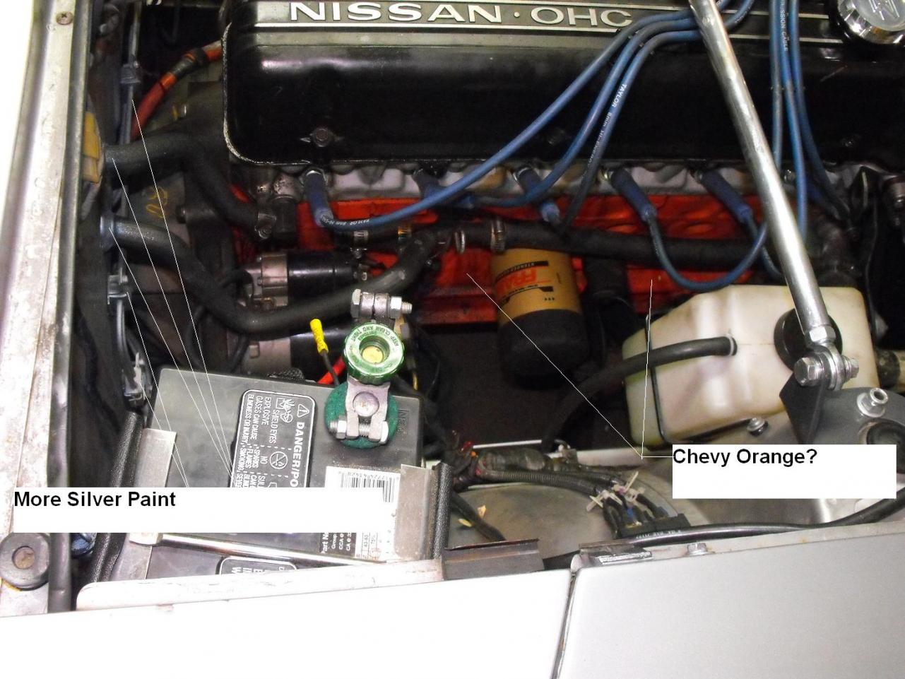

Posted August 22, 200915 yr comment_292515 I enjoyed the engine bay refresh on my 70 Z so much that I have decided to do it again, only this time on my newly acquired 71Z with the L26 motor. Seeing as how the motor is not original, I will not be as careful about sticking to the originality of the motor and engine bay detail. I would like to keep it somewhat close however. The two glaring things I want to fix here is the block color:sick: and 'Silver Overspray'. Actually, we're not talkin' silver overspray, we're talkin' silver spray paint gone wild. I will clean up the block and paint it the nissan blue, clean all of the aluminum to its original non-silver condition, and clean or replace the silver grommets. I ran a compression check and the cylinders ranged from 190 to 205 psi.:classic: Also, no leaks from the head gasket so I will just re-check torque on the head bolts. I will then clean, tape and paint the block with the head in place. I will do the same with the oil pan. After that, I will attack the engine bay. That will require the most work. Here are some pics at the start of the project. Edited August 22, 200915 yr by motorman7 Link to comment https://www.classiczcars.com/forums/topic/32914-refresh-part-2-1971-z-with-l26/ Share on other sites More sharing options...

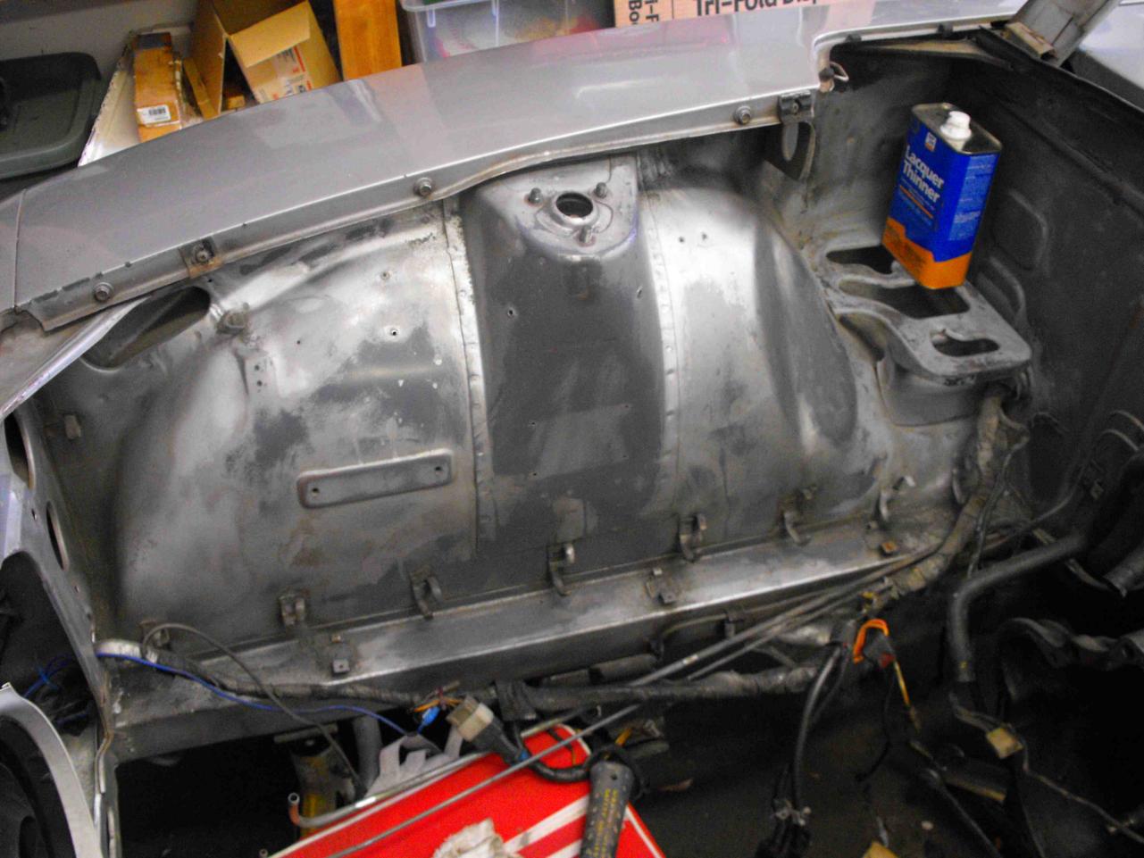

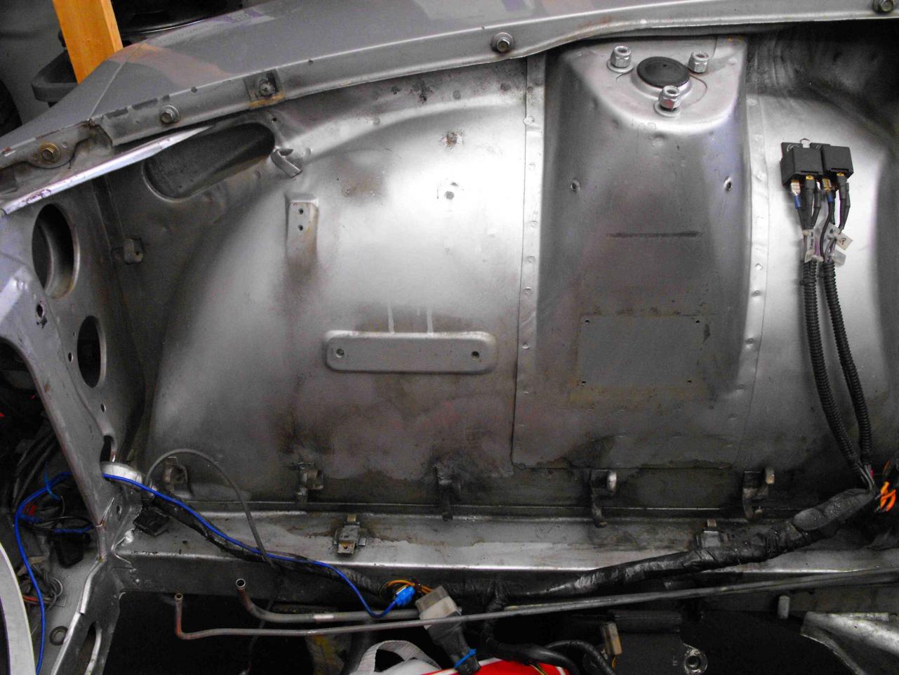

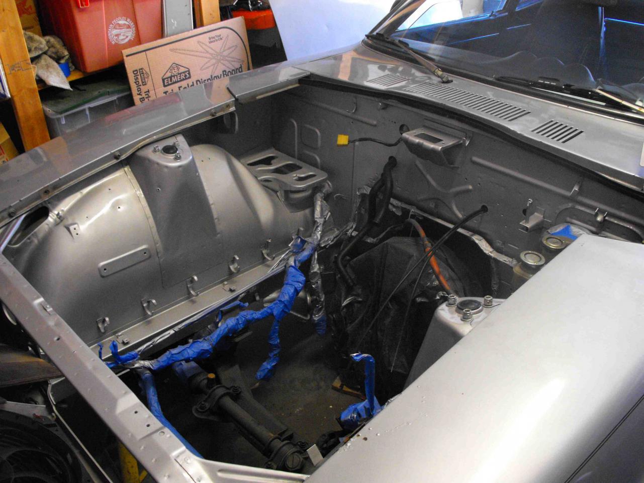

August 29, 200915 yr Author comment_293251 I got the block cleaned up and now need to attack the engine bay as you can see in the background. This is really a challenge. I have been using steel wool and laquer thinner for most of the clean. The plan here is to keep this low budget as this is not truly an original car. After engine bay clean-up, I will tape off the exposed parts and paint the engine bay with the 901 silver paint. I plan to eventually do some of the body work and repaint the exterior in the next year of two. That is about the extent of what I plan to do on this car Link to comment https://www.classiczcars.com/forums/topic/32914-refresh-part-2-1971-z-with-l26/#findComment-293251 Share on other sites More sharing options...

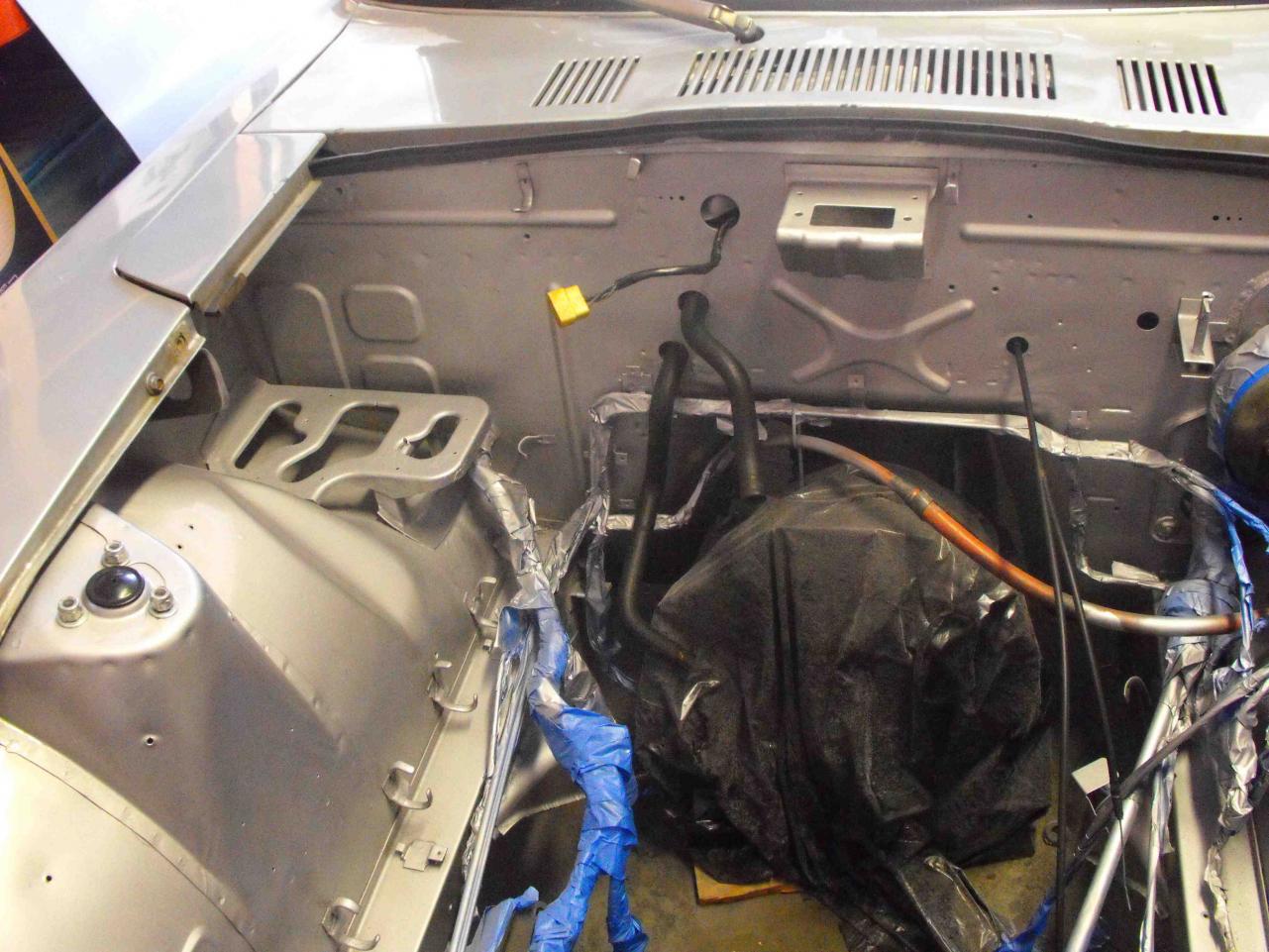

August 31, 200915 yr Author comment_293347 Got the engine bay cleaned and painted. The taping took forever. Probably would have been faster to have stripped everything. Now that this is done, I can start assembling. That's the fun part. It's not perfect but it only cost $60, so I think it's a good return on investment. The satisfaction of the bay looking nice is worth more than $60. Link to comment https://www.classiczcars.com/forums/topic/32914-refresh-part-2-1971-z-with-l26/#findComment-293347 Share on other sites More sharing options...
