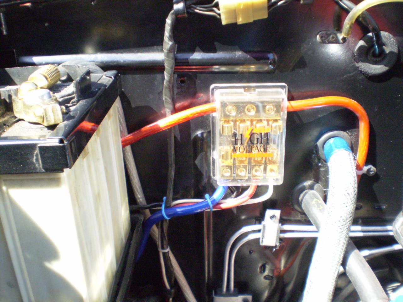

Chuck, the more ordinary variety of fuse is for lower amperages, perhaps up to 30A max (?). The maxi fuses are larger and are for higher amperages. Most importantly, they have more substantial connections capable of handling higher currents. I did finally order a couple of Stinger units. They are indeed a bit "blingish" -- really very pretty, with heavy polycarbonate construction, gold plated contacts, etc. They're more massive than I thought they'd be. Mine, the Stinger SFPD4MAX model, has a base measuring 4 1/4" x 3" and is 1 7/8" high/deep. It completely encoses the fuses. (I hope that's not a problem for heat.) If you wanted something more subdued than the clear polycarbonate housing with the yellow and black "Stinger" logo on the cover, you could always disassemble the unit, spray the plastic parts with black plastic spray paint, and reassemble. I don't think bling is a bad thing, though. ;-)
What wasn't clear from the product info is that this panel is not divided into separate circuits. The left-most connections are ALL interconnected and lead to the battery post. The right-most four connectors are independent. I'll be unbundling a bit of wiring tree to see how to make the conversion. The schematics indicate all the fusible links just lead to the battery, but the wiring harness has separate leads from the battery for each circuit.
