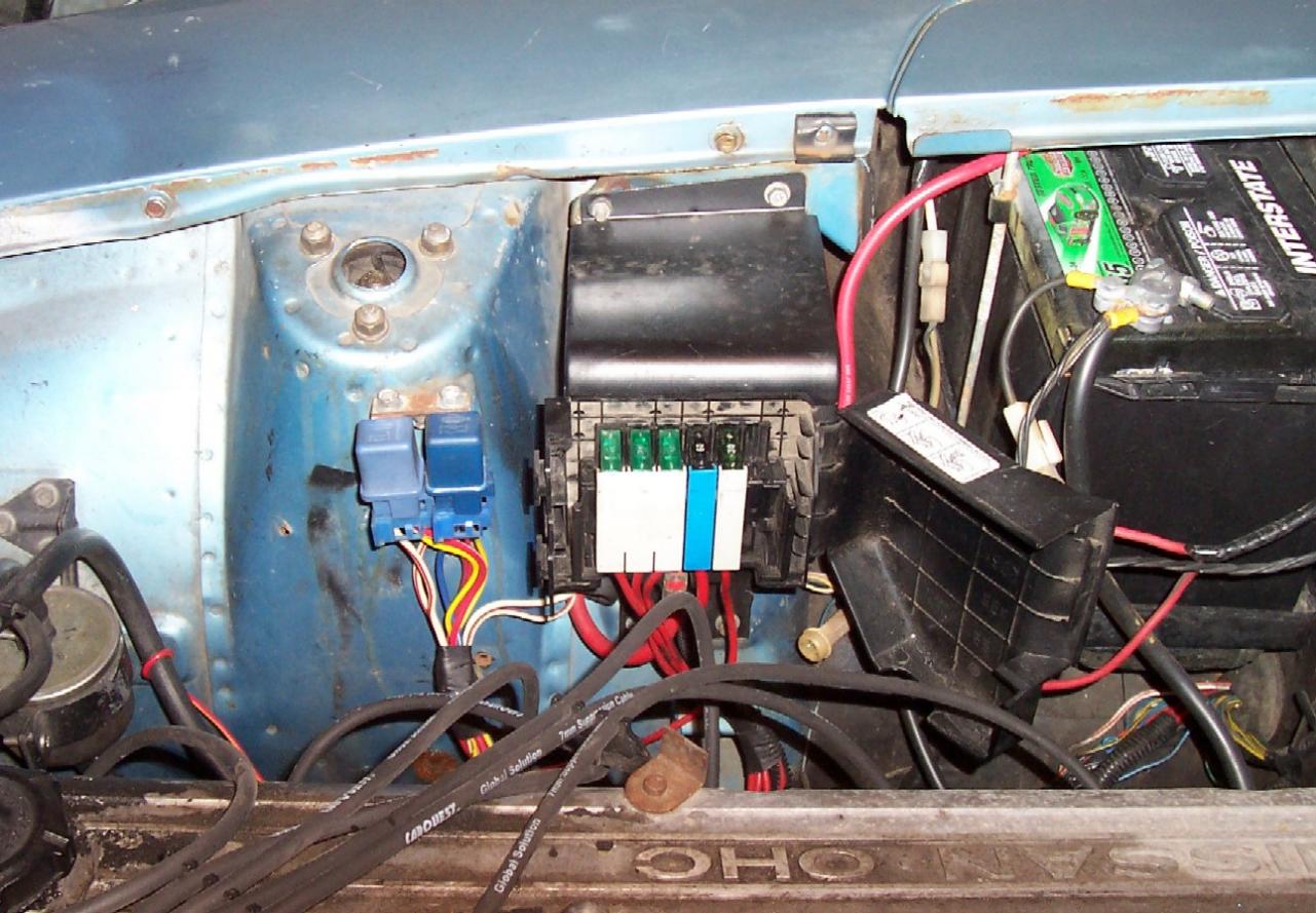

Hi Sarah - I found what suited my needs at the junkyard - as long as you don't mind a GM logo on the plastic cover...
Found this setup in the Caddy Catera platform - It is a 6 way, I only have 5 connections hooked up - 4 are stock and the 5th is for my headlight relays system. I went as far as sourcing part numbers and distributors for the contacts before giving up and just using a $0.29 butt connector to make the splice inside the cabin. I've got a few spares of these and last I remember, there were two Catera's out at Pick and Pull down here in VB two weeks ago. If anyone else is interested in this setup, I can start a step by step thread on making the conversion, as well as what to look for when getting the donor parts.

That's a nice solution! I have my Stinger blocks, though -- more blingish, but I don't think that's a bad thing. I'm going to mount them on an aluminum rail bolted to the relay housing.

Well,I like the Catera fuse box: if I can find one local to me so I can check it out in more detail i might go that direction. Otherwise, I might take up Fastwomen on her suggestion to use the Maxi-fuse and just 'de-bling' it a bit. I like the technical davantages of gold, so this route appeals to me.

I've got the MaxiFuse blocks installed. That was of course the easy part. The harder part is sorting through all the crusty, corroded bits of wiring harness and rebuilding the high-current parts of it. The ground line, which appeared to be about 10 ga and bolted to the block under the front heater hose clamp, was crimped in multiple places to branch lines. I pulled all that apart and replaced the wiring with 10 ga. crimped connections that I've sweetened by soldering.
The alternator wiring looked worse. It, too, was 10 ga, fused at 80A (!!). It had multiple crimp connectors that were crusty, corroded, and burnt. I upgraded to 8 ga, thin-insulated, teflon ensheathed wire, crimped and soldered, with the same wire running from the + post on the alternator all the way to the MaxiFuse block. I found that copper tubing made a great crimp material. Just pinch it with vice grips, and it snugs right up. Then infuse with solder, cool, and tape. I also made the lug at the alternator post out of 3/8" copper tubing. I put the 8 ga main line, a new 16 ga line with a bullet connector on it for the condensor, and the branch line to the field coil connector inside the 3/8 tube. I then crimped, soldered, flattened the end in a vice, and drilled a hole for the post. I finally put a piece of heat shrink around it. It looks great and is 5x beefier than the OEM. With this wiring, I was perfectly comfortable upgrading my fusing back to 80A. (I had previously downgraded to 60A, but upon seeing what horrors were inside the wiring tree, I think the wiring wasn't even competent to handle 40A.)
I took out the 10ga +12 wires and their branches from the starter lug to the fusible link assemblies and from the battery post to the two EFI fusible links, and I replaced it all with a 4 ga cable from the starter to the MaxiFuse block. The branches of the original lines were crimped and crusty, albeit not burnt.
