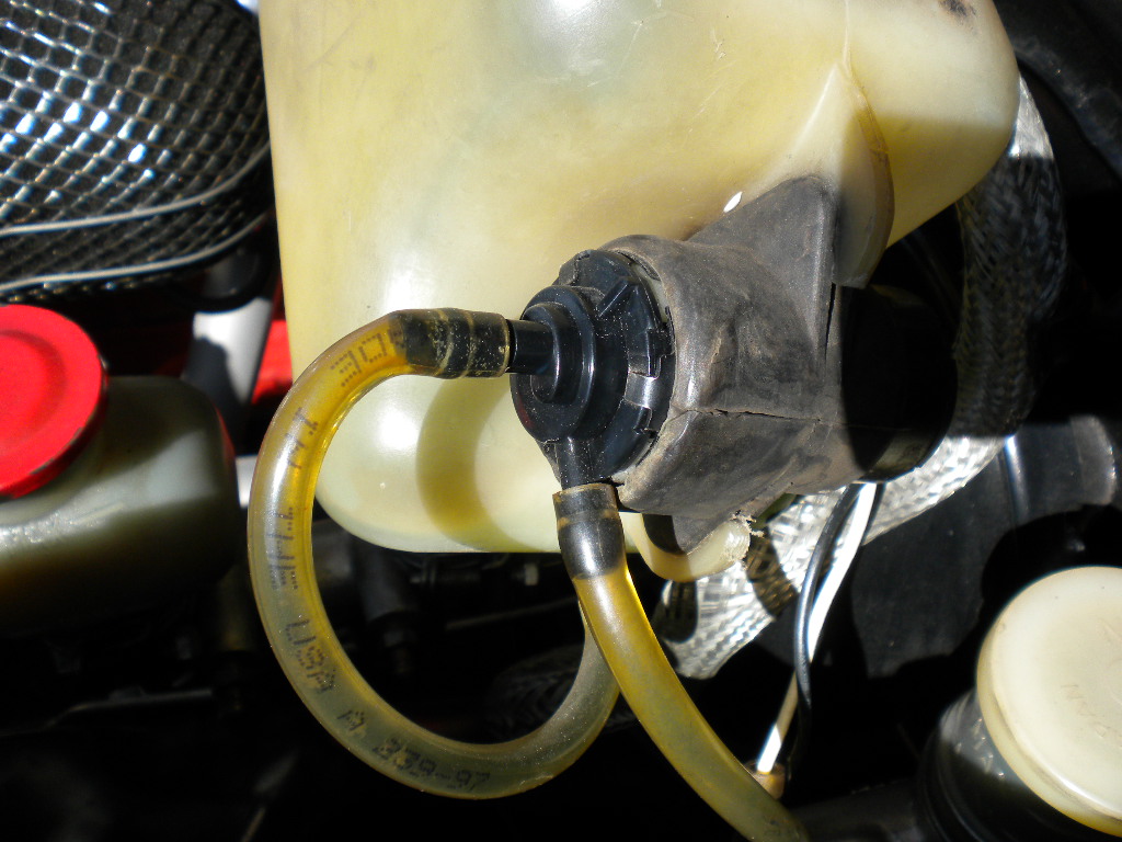

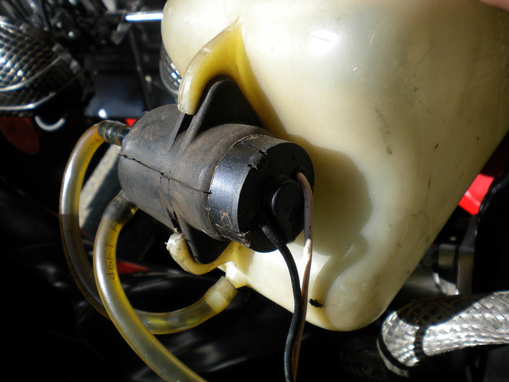

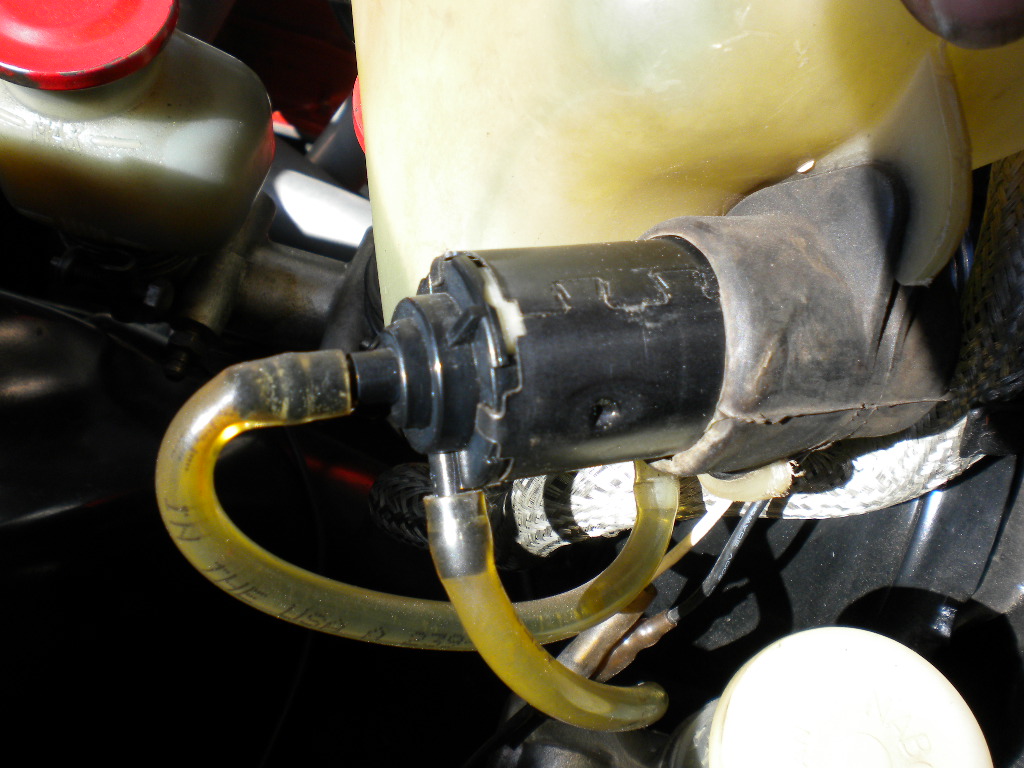

I had the same issue but mine was rust had eaten the tab insde the pump cap and then the motor fill with fluid. I took the old pump and the rubber boot that it sits in, to the local Auto parts store. I can't remember off hand what car it's for but I found a small pump with a black rotor cap that almost fit perfectly.
I bought it, took it home and used my dremmel with a sanding drum on it to widen the inner diameter of the rubber boot to fit the new pump motor. Everyhting fits, lokks and works perfect. I'll take a picture later on to help you find the right motor from the auto parts store. (about $10 I think)
Just took pics for ya. Should help ya find the right one. Cost way less than an OEM or NOS part and works probably better for years longer.

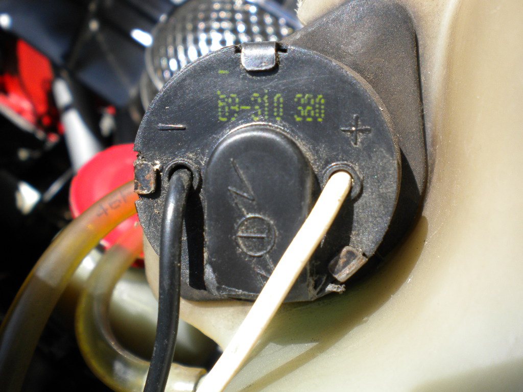

As you can see, a little sanding inside the rubber boot and it slides in perfect. The white wire of the pump goes to the black/yellow and the black pump wire to the black wire on the harness.
69-310-380 is the part number on the back, won't promise that it'll help but there it is.
