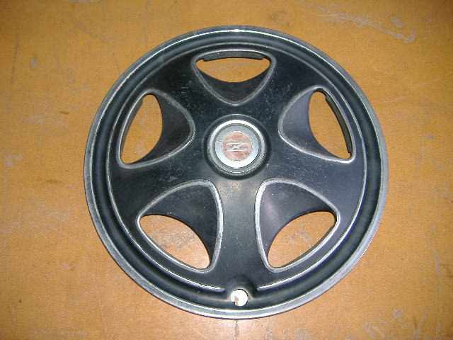

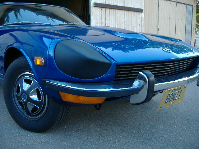

August 26, 200915 yr comment_292945 Jesse: This is what the original steel wheel and wheel cover lookd like.* Note: *On original, the chrome scollope you see would of been painted grey, the blue center should be a red reflector. Very early Z's had a "D" center. ($) Bonzi Lon Link to comment https://www.classiczcars.com/forums/topic/32961-rims-240z/#findComment-292945 Share on other sites More sharing options...

August 26, 200915 yr comment_292982 The "red reflector" is actually more of a "metallic orange". Link to comment https://www.classiczcars.com/forums/topic/32961-rims-240z/#findComment-292982 Share on other sites More sharing options...

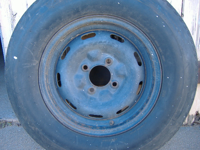

September 7, 200915 yr Author comment_293954 So I've got some *bad* pics, they're a bit blurry. The tires on these 14 x 5 rims are P195/70R14 90s....will these tires be to big for my stock z? But the whole lot plus 4 new tires bfgoodrich radials, is $200.... Edited September 7, 200915 yr by jessespencer79 Link to comment https://www.classiczcars.com/forums/topic/32961-rims-240z/#findComment-293954 Share on other sites More sharing options...
