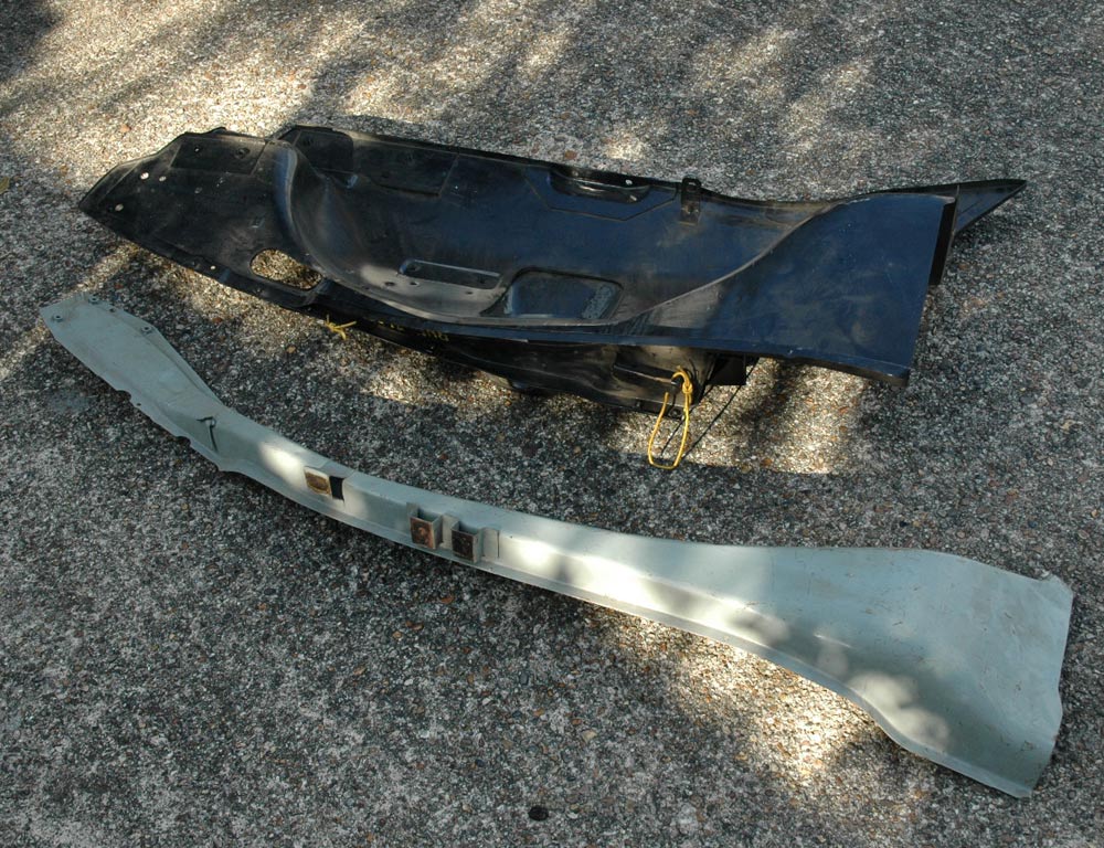

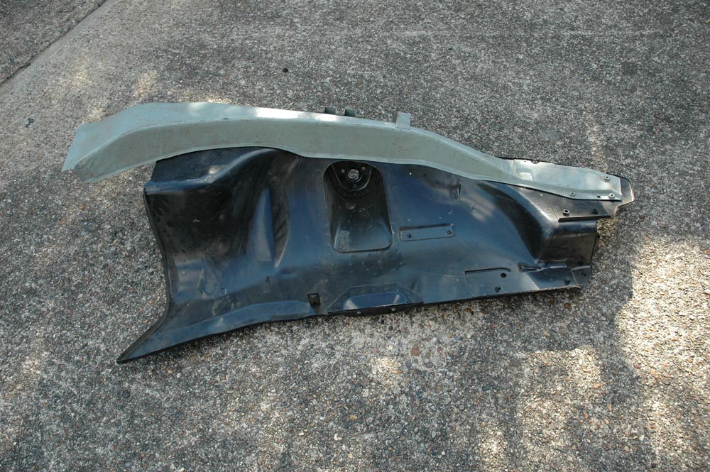

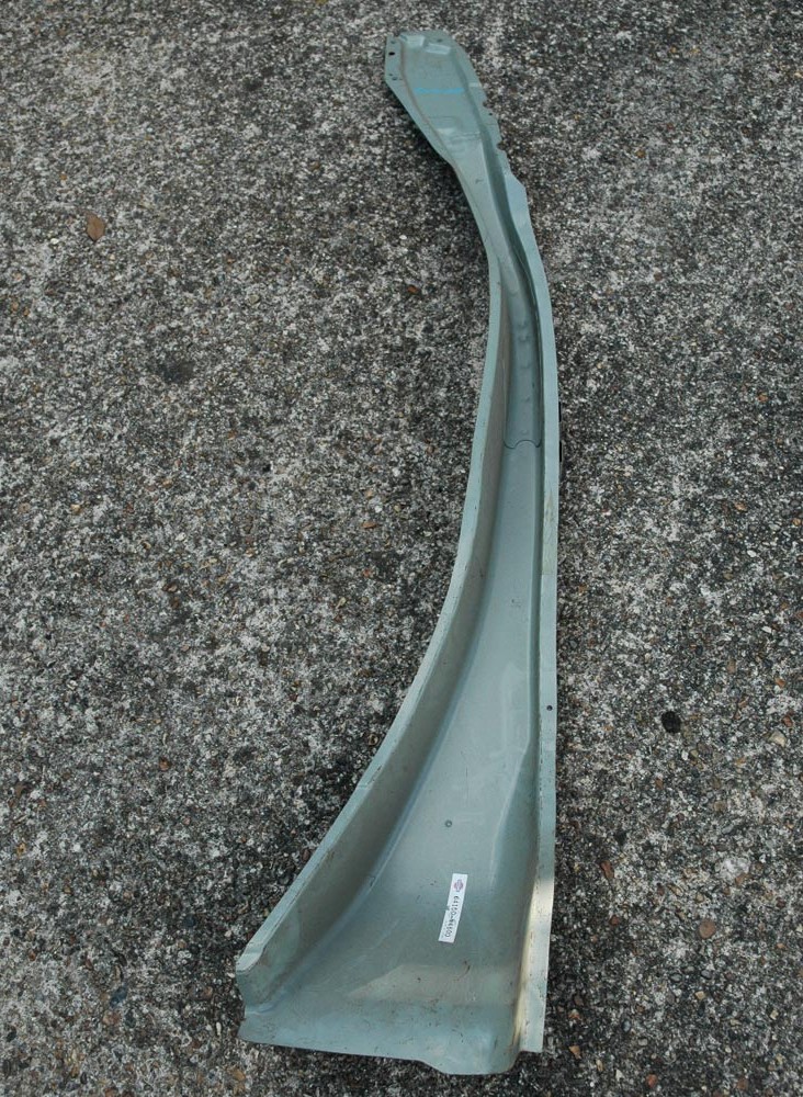

September 13, 200915 yr comment_294602 Does this help? Link to comment https://www.classiczcars.com/forums/topic/32980-datsun-240z-barn-find-restoration-cont/?&page=3#findComment-294602 Share on other sites More sharing options...
September 13, 200915 yr Author comment_294611 jr260z said: Does this help?Yes it does thanks. What's the bit above the front wheel arch? On my datsun, it's rusted to hell! Is it structural? Link to comment https://www.classiczcars.com/forums/topic/32980-datsun-240z-barn-find-restoration-cont/?&page=3#findComment-294611 Share on other sites More sharing options...
September 15, 200915 yr comment_294787 mattbibbey said: What's the bit above the front wheel arch? On my datsun, it's rusted to hell! Is it structural? Matt, I think you're referring to what Nissan called the "Hood Ledge Reinforcements", and what have come to be known colloquially as the 'Air Tubes'. Reason they are called 'Air Tubes' is because they have a secondary function of ducting fresh air from the front of the car ( inlets are in the radiator core support, and plastic tubes connect them to these 'air tubes' inside the engine bay ) to the outlets under the dash, where they are turned on and off by pull/push knobs located either side. Take a look under the dash on the extreme left and right, and you will see the ducts, flaps, cables and knobs. However, the primary function of the 'air tubes' is to act as a front upper body structural member. So yes, they are structural, and very important. Road muck thrown up by the front wheels builds up on the top ledge of the air tubes, and eventually rots through them. If they are badly corroded on your car, then it can be a BIG job to repair / replace them. NOS panels can sometimes be found, but they are expensive and fairly complex to attach properly. Big structural repairs of the air tubes, front crossmember / rad support and front chassis rails really ought to be done on a jig. Here are some pics to illustrate the shape of the parts: Link to comment https://www.classiczcars.com/forums/topic/32980-datsun-240z-barn-find-restoration-cont/?&page=3#findComment-294787 Share on other sites More sharing options...
