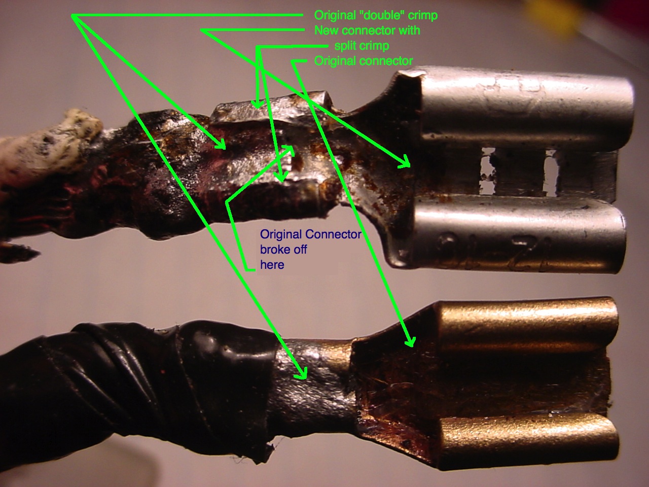

Posted September 4, 200915 yr comment_293702 Hi all, I want to replace one of the two very large connectors that are on the cable that goes out of the back of the fuse box because one of them broke off. These are the two white wires that go to the battery and ammeter according to the wiring diagram. I cut the crimp lengthwise on the largest connector I could find and tried to crimp it around the stump of the original connector that broke off. I soldered everything but someone who has raced cars told me that solder tends to come apart with vibration. Is there a way to get a really large crimp on connector to replace the original? I already tried Napa and another auto parts store and they just have 12 gauge crimp connectors like these. I need I think a crimp on connector for 10 or maybe 8 gauge from looking at it. Thanks for any ideas, Mike Link to comment https://www.classiczcars.com/forums/topic/33052-large-connector-replacement-on-fuse-box-cable/ Share on other sites More sharing options...

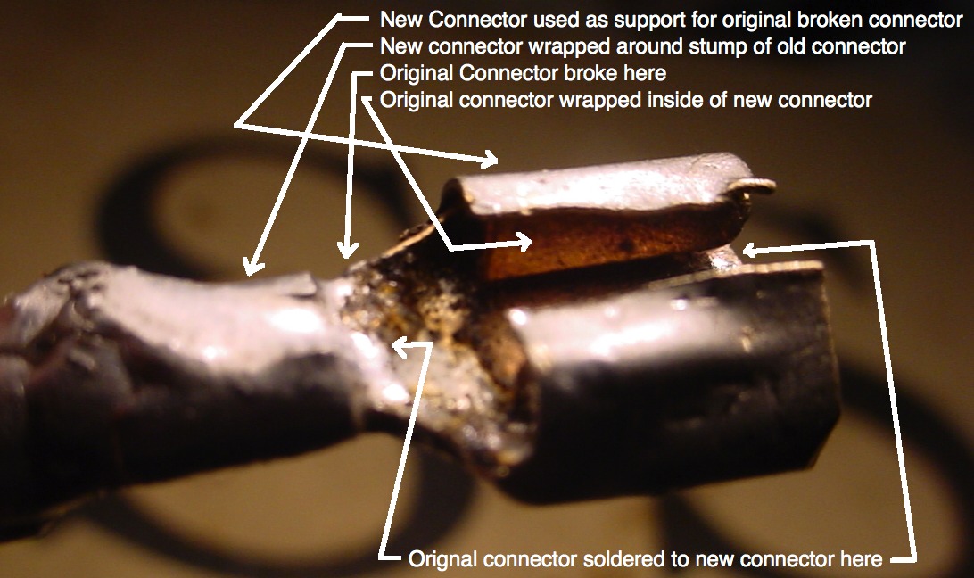

September 6, 200915 yr Author comment_293884 Thanks FastWoman, I listened to what you said and tried plugging in the connector to the car and finally noticed that the made in Taiwan new connector I got at the auto store had metal that was much too soft and was losing the grip on the spade connector it mates with. Running out of ideas I finally soldered in the original connector on top of the new one with the new one acting as a repair. The new rube goldberg connector plugs in great with a nice solid retention. Attached is a picture of the result though probably no one else will break this particular connector and get any use out of it! Thanks, Mike Link to comment https://www.classiczcars.com/forums/topic/33052-large-connector-replacement-on-fuse-box-cable/#findComment-293884 Share on other sites More sharing options...
