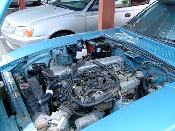

About three weeks ago I purchased my first Z. A 1976 280z with a 5 speed. The car is in pretty good shape with only a tad bit of rust located in the wheel well under the battery box. The interior is in pretty good shape as it has a complete dash cover. (so I'm pretty sure the original dash is cracked).
Engine is in great shape but does have a fairly annoying ticking noise coming from the injector side of the engine. Not sure what it is yet but I will figure it out. Its fairly loud, (can hear it in the car when driving.), but I'm thinking the injectors are just old.

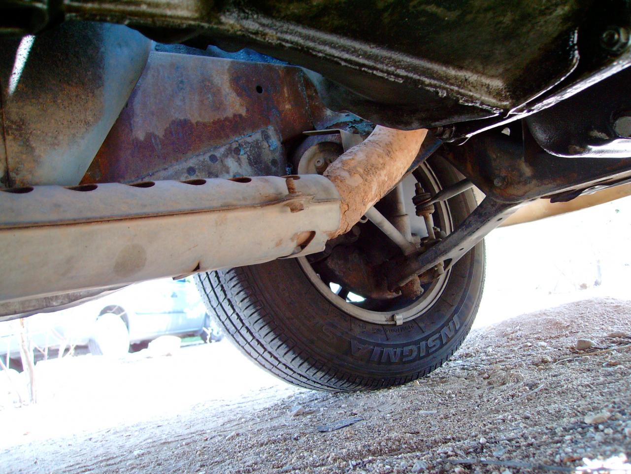

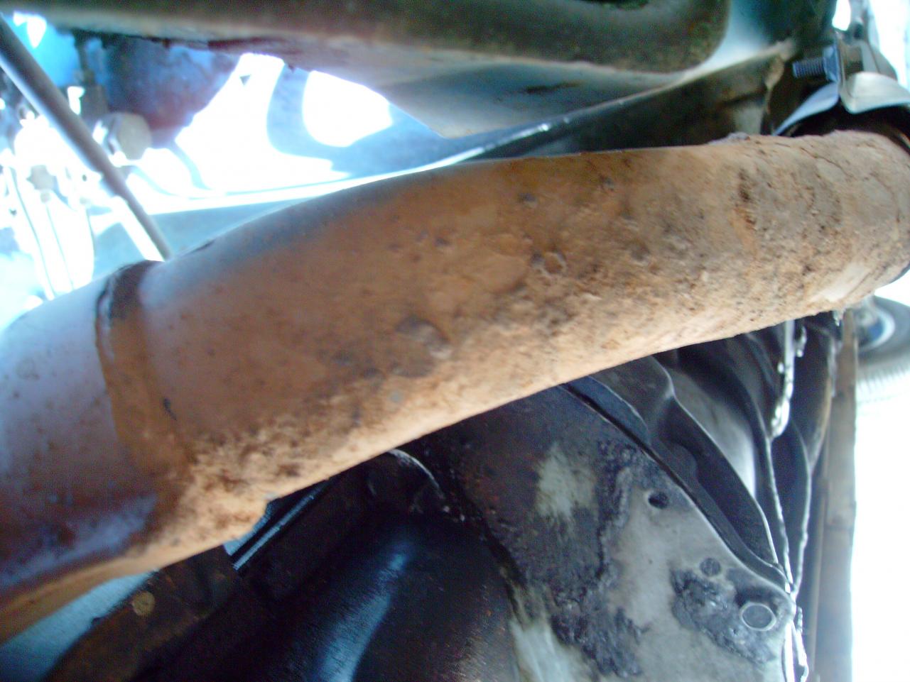

As for the ticking, look to see if it isn't an exhaust leak, either at the collector or at the manifold to the block (probably at the collector though). You might be able to see a black carbon trail near one of the three studs that hold the exhaust pipe to the collector. IF that is what it is, the gasket is about 6 bucks. Getting the nuts off the studs without twisting off the studs is the challenge. LOTS of PB Blaster. If you have a thread chaser (die), cleaning the threads could help. It is a major PITA to get out a broken stud. In fact, you may have a look and see if there is a broken one there now and it is indeed causing an exhaust leak.

Thanks for the advise. I'll crawl under there today and take a look at the entire exhaust. Will take pictures if anything is found (or not found really).

Yes I do know that the injectors "tick" when the car is driving. Should it be loud enough to hear while driving? I'm not saying just normal noise, its fairly loud and increases with the RPM

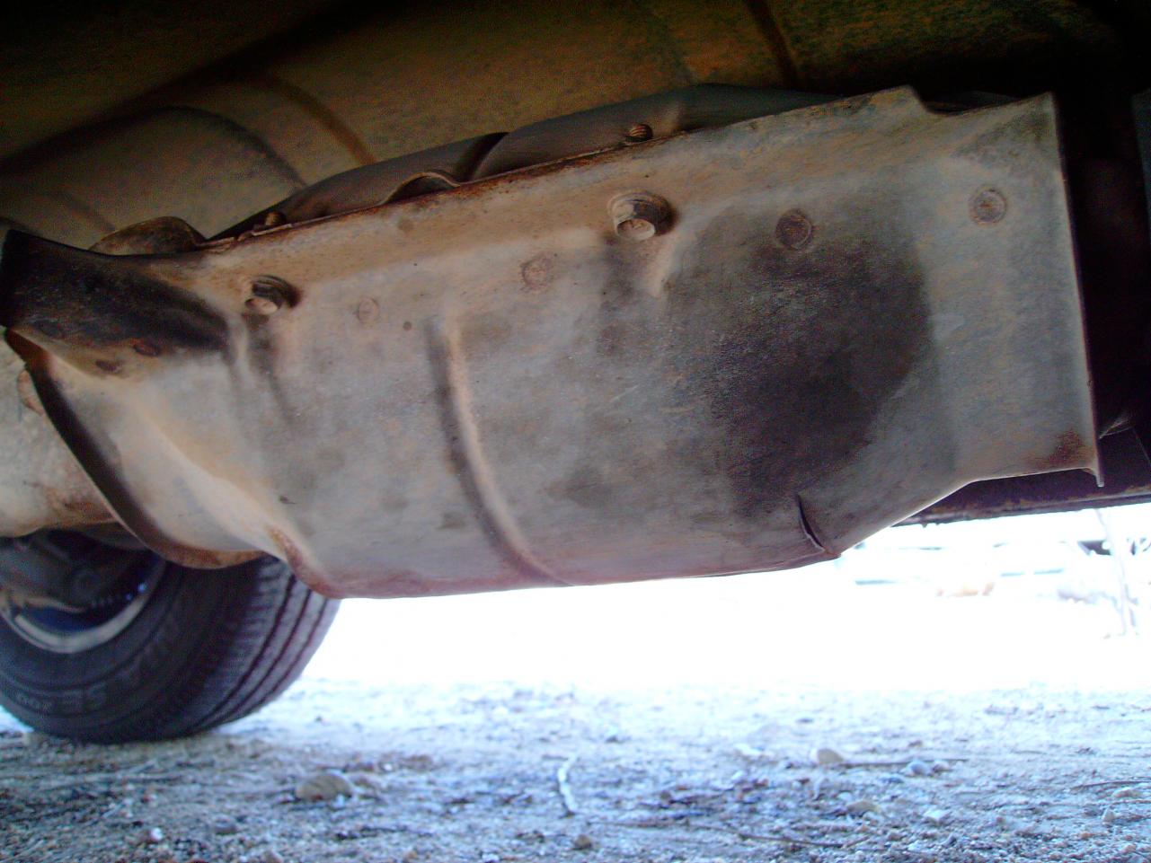

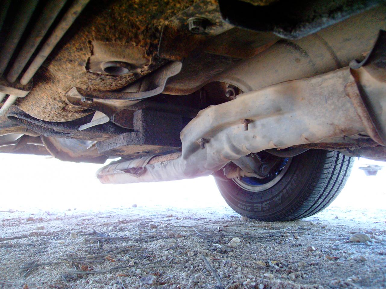

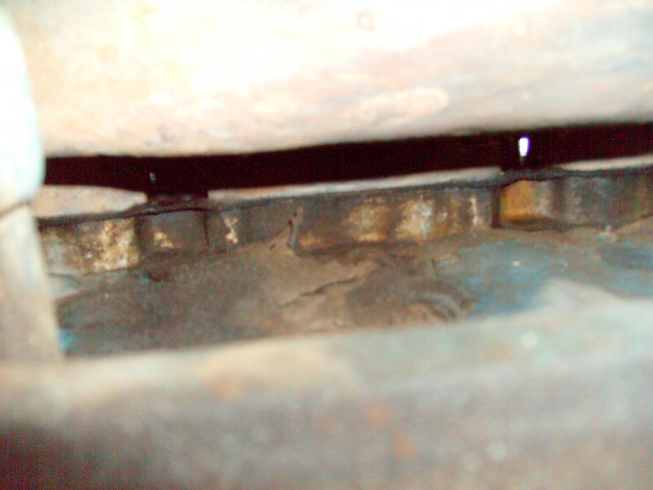

I did climb under the Z today and took a look at the entire exhaust. I didn't find any obvious leaks but it is pretty dirty. (rusty). I took some pictures, let me know what you all think.
Jan
