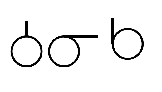

Sometimes even if the valves are at the top they still aren't right. The bleeder passage has to enter the piston chamber at the highest point. In the attached file the two "calipers" (sorry for the very crude artwork) on the left will bleed but the one on the right will not even though the bleeder is facing up.
