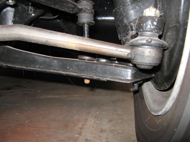

Posted September 10, 200915 yr comment_294256 FSM says: "When assembling the stabilizer connecting rod and transverse link, be sure to tighten the first nut to 8.7 to 13.7 ft-lb torque and tighten the lock nut to secure the first nut." Haynes says: "...do not tighten the mounting bolts or nuts beyond the specified torque which is 18 lb/ft for the (stabilizer) bracket bolts and 15 lb/ft for the drop link nuts." Wick Humble says: "Tighten the link until the rubber grommets bulge slightly--don't try to bottom the thread. When you estimate the links are tight enough, jam the nuts together. Then tighten the (top) locknut--you may have to hold the link with Vise-Grips pliers." I need some help here. Do any of these torque specs. refer to the top locknut on the front stabilizer connecting rod? And when I torque the bottom bushing to the lowest torque spec cited (8.7 ft-lb - FSM) the new stock rubber bushing is significantly more compressed than Humble's "bulge slightly" recommendation (see attached photo). What do you guys suggest for stock rubber? Thanks, Gary S. Link to comment https://www.classiczcars.com/forums/topic/33124-stabilizer-connecting-rod-torque-question/ Share on other sites More sharing options...
September 14, 200915 yr comment_294693 I'm curious here as well. Your bottom bushing looks compressed quite a bit but not terrible. Since the range for torquing is so wide (8.7 - 19.5 ft-lbs) back off toward the lower side of the spec to give it more rubber. Are your bushings rubber or urethane?I have new urethane bushings/grommets coming. I interpret the following: Lower Bushings attaching the rod to the Transverse link are to be torqued to 13.7-18.1 ft-lbs. (then use a lock nut to assure they stay in position). Upper Bushings attaching the rod to the Stabilizer Bar are to be torqued to 8.7-19.5 ft-lbs. (then use the lock nut to assure they stay in position). This is quite a large range so I was going to go to a mid-point and assure the bushings are compressed at least 50% before locking it in place with the lock nut).The Stabilizer Bracket (attaches to the frame) are to be torqued to 13.7-18.1 ft-lbs.(I didn't look to see if there is a lock nut - but if there is, then attach it locking this in place as well).This is would be my approach. Edited September 14, 200915 yr by moritz55 Link to comment https://www.classiczcars.com/forums/topic/33124-stabilizer-connecting-rod-torque-question/#findComment-294693 Share on other sites More sharing options...

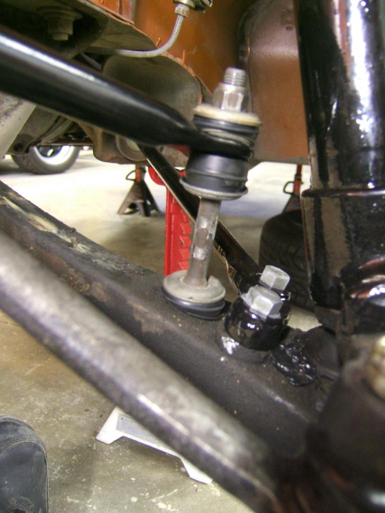

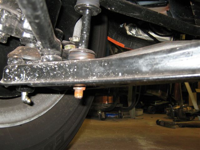

September 15, 200915 yr Author comment_294762 I used the stock, rubber bushings. Another member here responded to my question - these are his instructions, with photos. "8.7 foot lbs is way to tight that is about 105 in lbs. I torque mine to 35-45 in lbs. see attached pictures." Link to comment https://www.classiczcars.com/forums/topic/33124-stabilizer-connecting-rod-torque-question/#findComment-294762 Share on other sites More sharing options...
September 15, 200915 yr comment_294779 Excellent , thanks for the info. I'll do this when I install mine...I presume when you attach the Stabilizer Bar to the Frame you torque to 13.7-18.1 ft-lbs.Many thanks... Link to comment https://www.classiczcars.com/forums/topic/33124-stabilizer-connecting-rod-torque-question/#findComment-294779 Share on other sites More sharing options...
