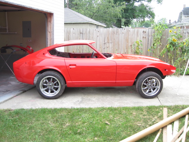

September 13, 200915 yr comment_294568 I wish I had taken some photos. I installed Toyo Proxes 225-50-15 on 15" Konig Rewinds a couple weeks ago. I only had them on my car for a couple days before ripping out the front suspension. I can say that the short drive I took (about 10 miles) I had no rubbing issues at all. Plenty of clearance on (at the time) a stock, albeit worn out '77 280 suspension.I can say that unless you lower it, it will not look quite right. I am putting on a set of Illuminas with Eibach springs. Should drop it an inch or so but Im not quite sure that will be enough from looking at it.I can take a photo of the rears (once my wife gets home with the camera) but the front is up on jack stands so it may give a slightly skewed view. Link to comment https://www.classiczcars.com/forums/topic/33164-15x7-rota-rb-wheels-on-stock-suspension/#findComment-294568 Share on other sites More sharing options...

September 13, 200915 yr comment_294628 Here is the photo of mine with 15" Rewinds and Toyo Proxes 225-50-15 As I said earlier, my front end is on stands right now. You can see the car will need to be dropped some. Link to comment https://www.classiczcars.com/forums/topic/33164-15x7-rota-rb-wheels-on-stock-suspension/#findComment-294628 Share on other sites More sharing options...

September 20, 200915 yr Author comment_295233 Thanks for the pic Mezzz...I also like your choice of the Konig's. Does it seem that stock hieght on 280's is higher than 240/260's. Looks like a lot of rear spring showing....maybe its the pic. Like you said, lowering should help. I would appreciate any and all additonal pics of 15" wheel/tire setups on stock as well as lowered 280's. I thought quite a few of you were running 225 -50's and 205-60's. Link to comment https://www.classiczcars.com/forums/topic/33164-15x7-rota-rb-wheels-on-stock-suspension/#findComment-295233 Share on other sites More sharing options...

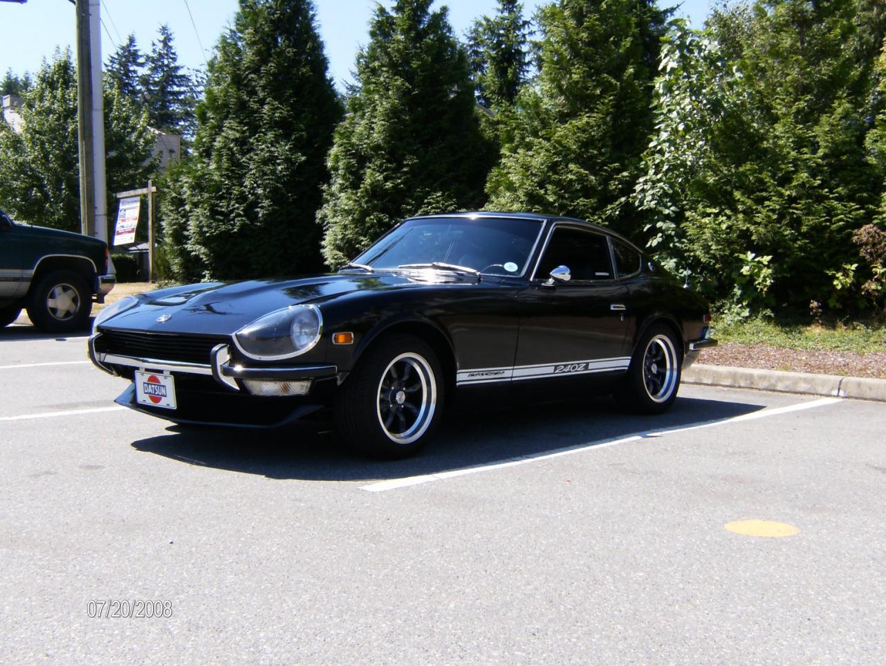

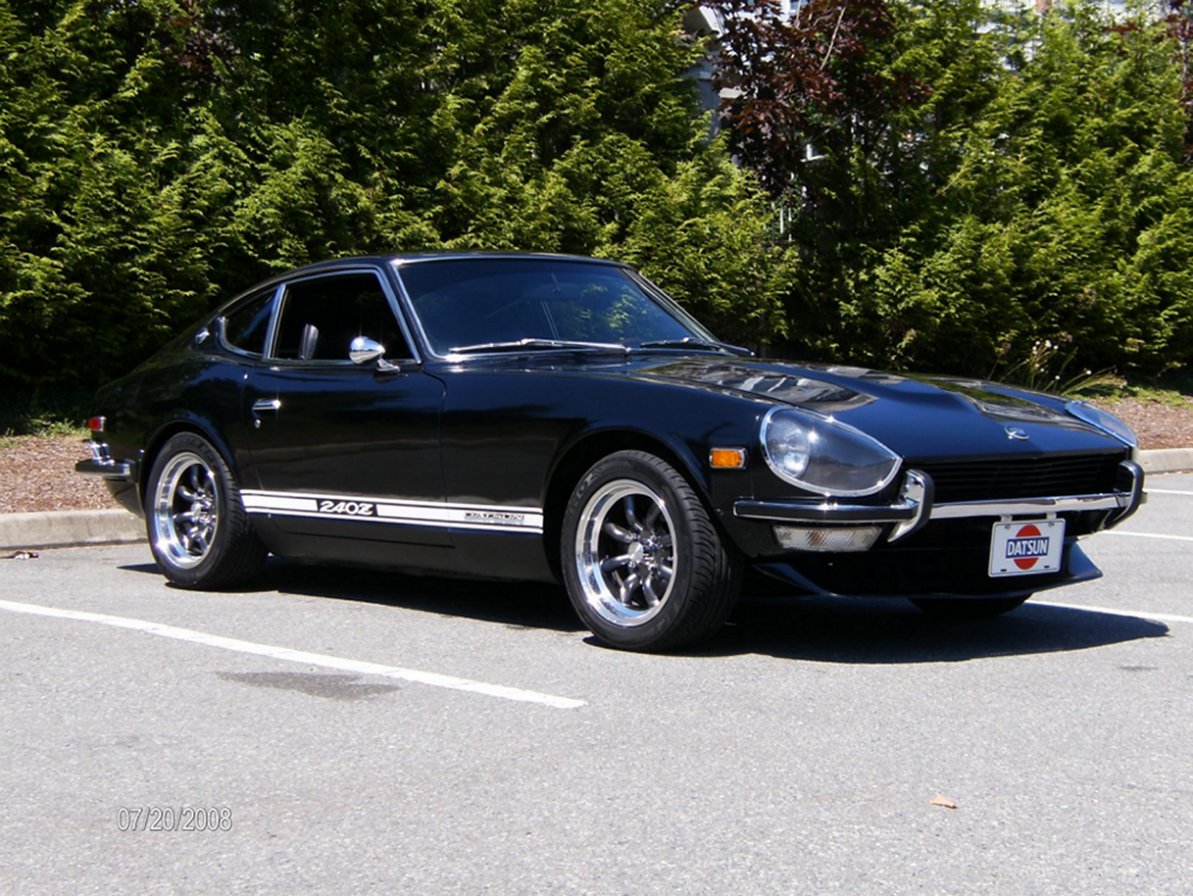

September 20, 200915 yr comment_295235 Just before I sold my black 240Z, I installed 15x7 Konig rewinds with Kumho KU31 195/50/15's. The car was lowered with the eibach springs and tokico blues and I never rubbed once while driving. The wheels were 0 offset and my tires weren't as stretched as what you ar eplanning but they were fantastic just the same. Here's mine after the lowering springs were installed. Link to comment https://www.classiczcars.com/forums/topic/33164-15x7-rota-rb-wheels-on-stock-suspension/#findComment-295235 Share on other sites More sharing options...

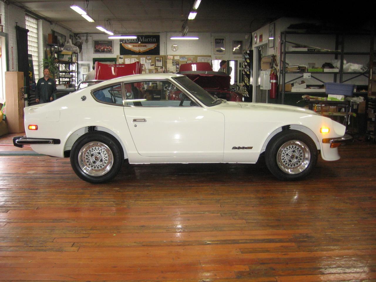

September 20, 200915 yr comment_295255 Thanks for the pic Mezzz...I also like your choice of the Konig's. Does it seem that stock hieght on 280's is higher than 240/260's. Looks like a lot of rear spring showing....maybe its the pic. Like you said, lowering should help. I would appreciate any and all additonal pics of 15" wheel/tire setups on stock as well as lowered 280's. I thought quite a few of you were running 225 -50's and 205-60's. This photo shows 15" x 7" Ronal 3-piece modular wheels with Bridgestone 205/60-15's on a 260Z. Fixitman Link to comment https://www.classiczcars.com/forums/topic/33164-15x7-rota-rb-wheels-on-stock-suspension/#findComment-295255 Share on other sites More sharing options...
