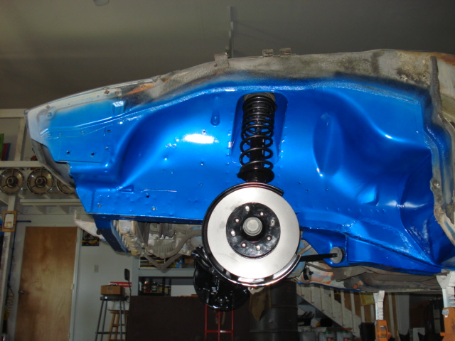

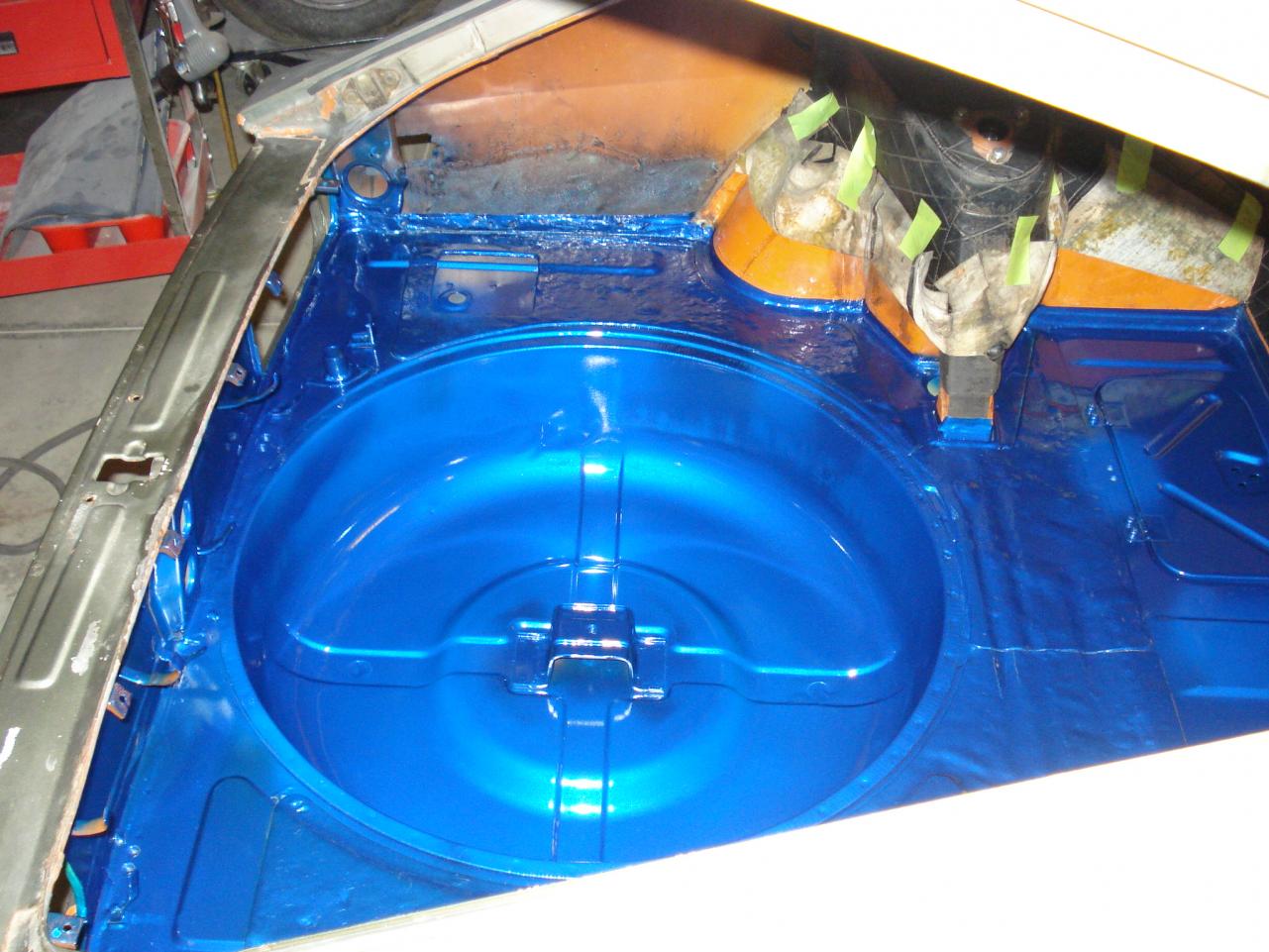

September 17, 200915 yr comment_294955 John, I built the rotisserie. It was more than sufficient for a body of this weight. I even bolted the entire undercarriage on the body before taking it off of the rotisserie a month or so ago. Wheels came from Harbor Freight. I'll attach some pics. If you're interested, I can get measurements for you. Terry Link to comment https://www.classiczcars.com/forums/topic/33167-920-gold/?&page=3#findComment-294955 Share on other sites More sharing options...
September 17, 200915 yr Author comment_294962 Terry,I would like measurements. That looks like one of the simplest designs I have seen. It looks like 2 engine stands that have been modified fo hold a Z. By the way, I am in awe of your Z. I am hoping to be where you are now by next spring. Started last November. John Link to comment https://www.classiczcars.com/forums/topic/33167-920-gold/?&page=3#findComment-294962 Share on other sites More sharing options...

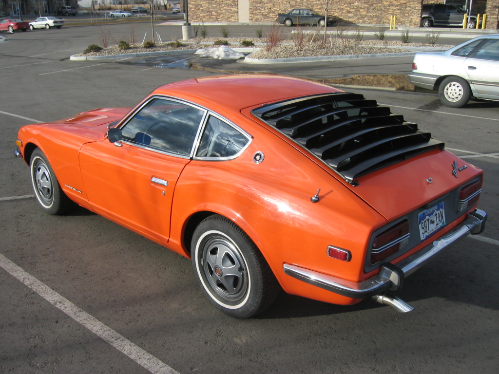

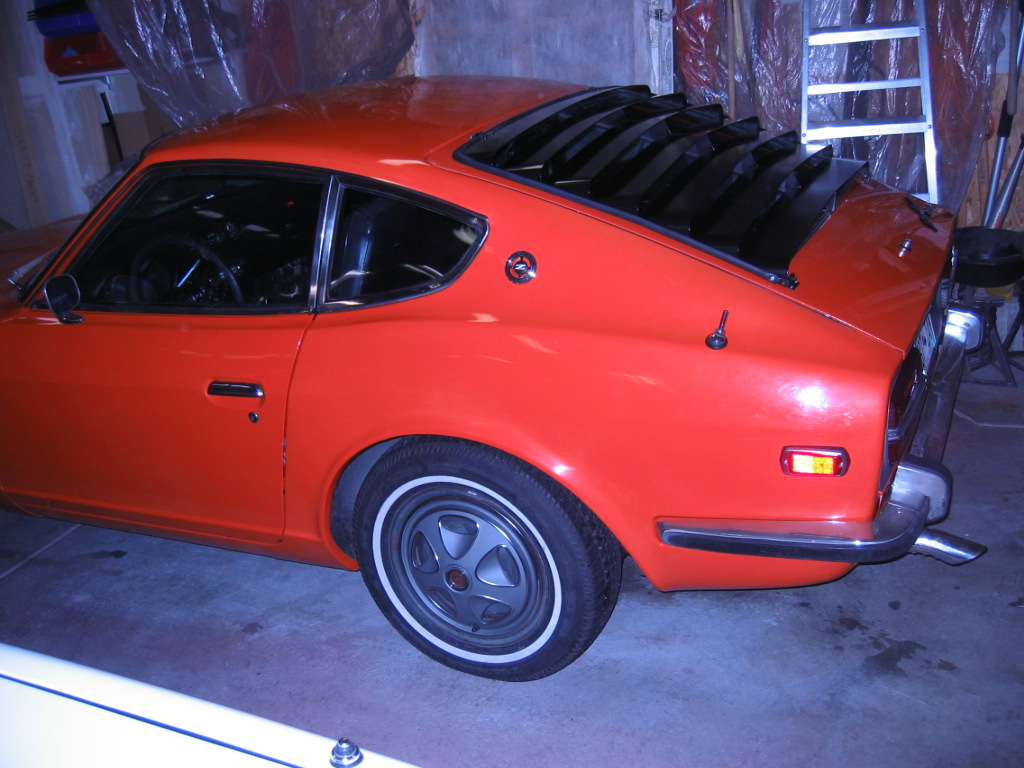

September 19, 200915 yr comment_295124 A quick point about color variations - the lighting will make a difference when comparing colors. Avoid comparing the color chips from the paint supplier's book to your sample while standing inside at the counter under the flourescent lights. For best results, do your color comparisons outside in the sunlight. Take a look at the two photos of my orange '73. The paint almost looks red under the flourescent lights in the garage. The primer can affect the color, so it's best to use a light primer with light color paints. Keep in mind that most paint systems allow you to tint the primer with the base color so that fewer color coats will be required for a basecoat/clearcoat paint job. With a bc/cc paint job you only need to spray enough color coat to achieve a uniform appearance. The clear coat seals it, adds depth & shine and provides a durable finish. You could tint the primer if you are using a single stage paint, although you need to apply enough coats to achieve a uniform color and a durable finish. Too thin could cause problems down the road. I agree with five&dime, there is nothing better than a bc/cc paint job that has been wet sanded perfectly smooth & buffed to a super high gloss. For those pursing a stock appearance this would be over-restoration on a Z car, considering the cars did not come from the factory with show quality paint. I've had no problem getting single stage paint from my local PPG supplier. And I've had very good luck with the PPG Omni value line of paints. The key, as theramz pointed out, is in the prep work. Expensive paint will be wasted on a car that has had poor body work and poor prep work. Don't paint your car black unless it is PERFECTLY straight or every ding, wave and ripple will stand out like a sore thumb. Lighter colors are more forgiving about the imperfections. I did my first Z in an orange basecoat/clearcoat, including the engine bay. I'm working on another Z that I plan to use bc/cc on the body exterior and will use a single stage in the same color for wheel wells, door/hatch jams, interior, underside of hood and engine compartment. I've already sprayed the interior and wheel wells. I've got a little body work to do before I can spray the body... Link to comment https://www.classiczcars.com/forums/topic/33167-920-gold/?&page=3#findComment-295124 Share on other sites More sharing options...

September 21, 200915 yr comment_295351 John,I built the rotisserie. It was more than sufficient for a body of this weight. I even bolted the entire undercarriage on the body before taking it off of the rotisserie a month or so ago. Wheels came from Harbor Freight. I'll attach some pics.If you're interested, I can get measurements for you.Terry That's truly first class, and far exceeds what I'm doing. Link to comment https://www.classiczcars.com/forums/topic/33167-920-gold/?&page=3#findComment-295351 Share on other sites More sharing options...
