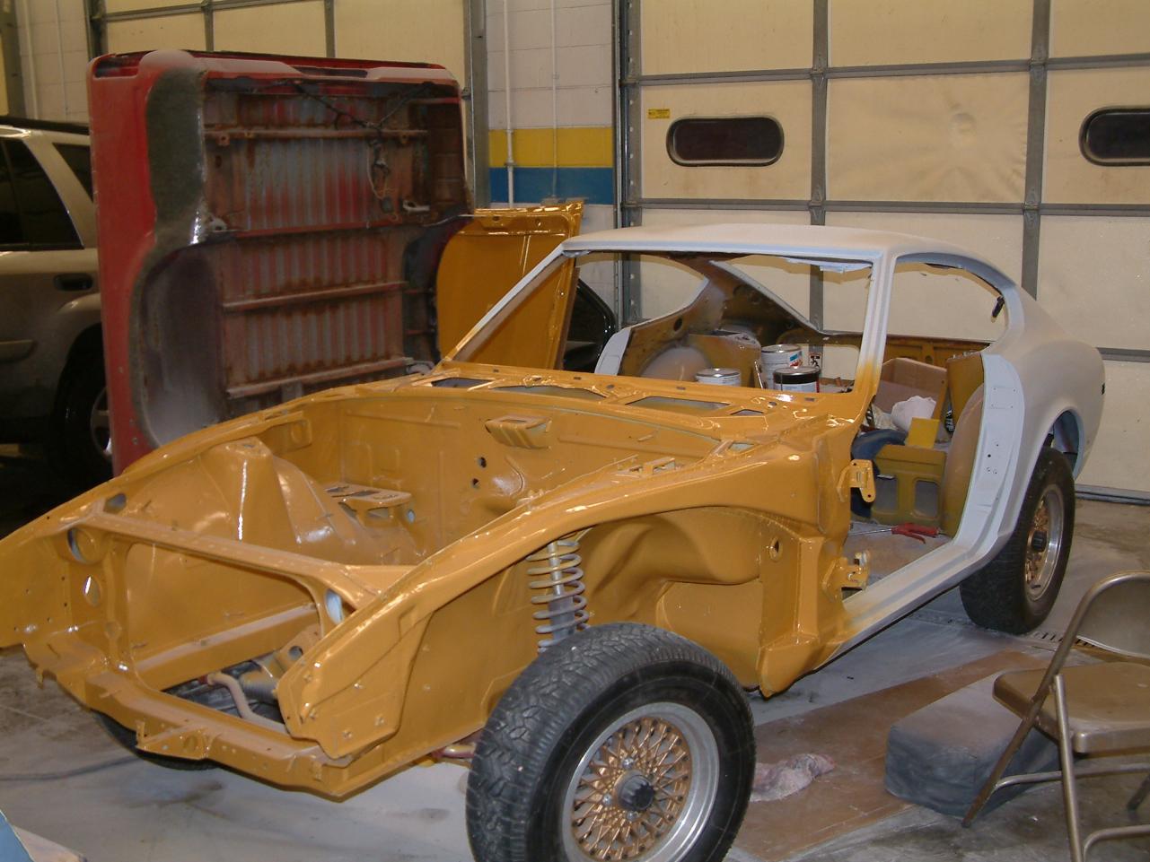

Update: So the drama continued until I said the hell with it and went with PPG Shop Line mixed in the off the shelf 23576 code. I had a sample of this and was spraying it on primed sheet metal. Me, being an inexperienced painter to say the least, had only put 3 - 4 light coats on. I wasn't happy with the color. My paint guy painted my valance corners for me so I could see the color and it looks great!
I asked him why it came out so much better and he told me it took 10 light coats to get the full color! 10! I had no idea you could even apply that much paint. He said even though my coverage looked even it wasn't deep enough. I guess that's why he makes the big bucks.
Anyway, it matches very close to the 40 year old samples I peeled from under the rear strut tower vinyl and the parts I have look great in the sunlight as well as the garage.
He is jamming the body and painting the engine bay now and I will pick it up next week to reassemble the body and install the engine, fuel and brake lines and get some of the smaller under body items back in.
I should be able to get the car back to him by the end of February for the topcoat.
the picture is from yesterday.
John

10 coats? From an HVLP gun??
The results look great, thats for sure. It just seems like that would be a ton of material thrown down. Did you go with single stage? Did you shoot right over primer, or did you toss up a tinted sealer of some sort?
Sorry to ask so many questions, but I plan on redoing my 920 car also, and like most 920 people I am really sensitive about making sure the tint comes out correctly. You would think with all of the tech advancements we would be able to match a color.
I'm still a long way from paint, so I guess I am lucky to be able to learn from other peoples frustrations.
I went with the original configuration. Red Oxide epoxy primer over light grey sealer then the top coat. My paint guy had a sample of the original paint which has definately changed in 40 years but it took him 8-10 light coats to get the depth of the color in the original sample.
You can tell from the thread that people have been trying to match this color and "that's about the closest you can ask for" seems to be the common answer. Like I said, after going with 3 or 4 Prophet gun samples from different areas I decided that the closest match was the PPG ShopLine 23576 in both single stage (wheel wells, under carraige and engine bay) and base/clear for the outer shell and jambs.
