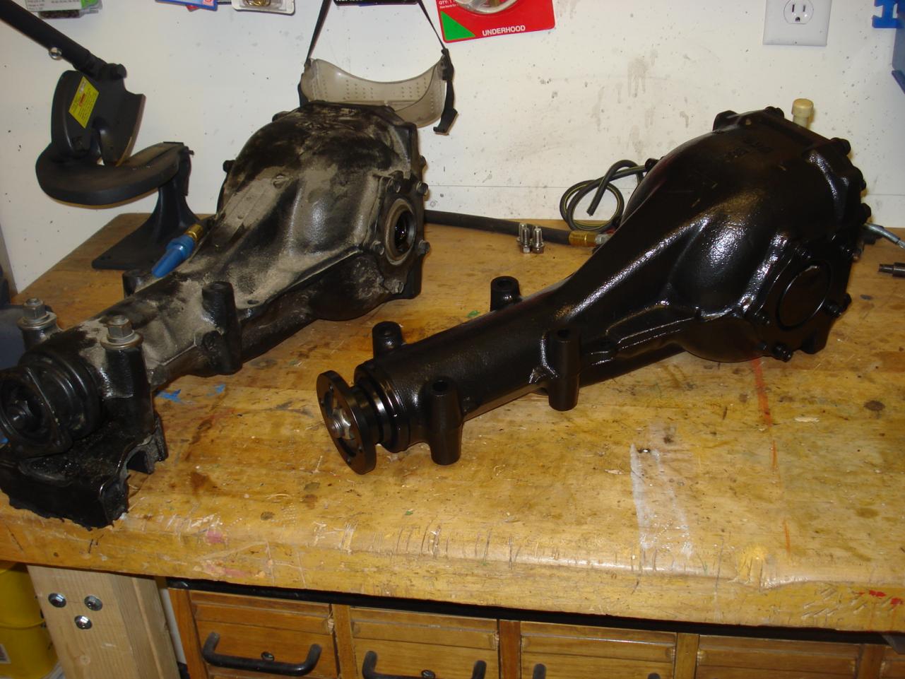

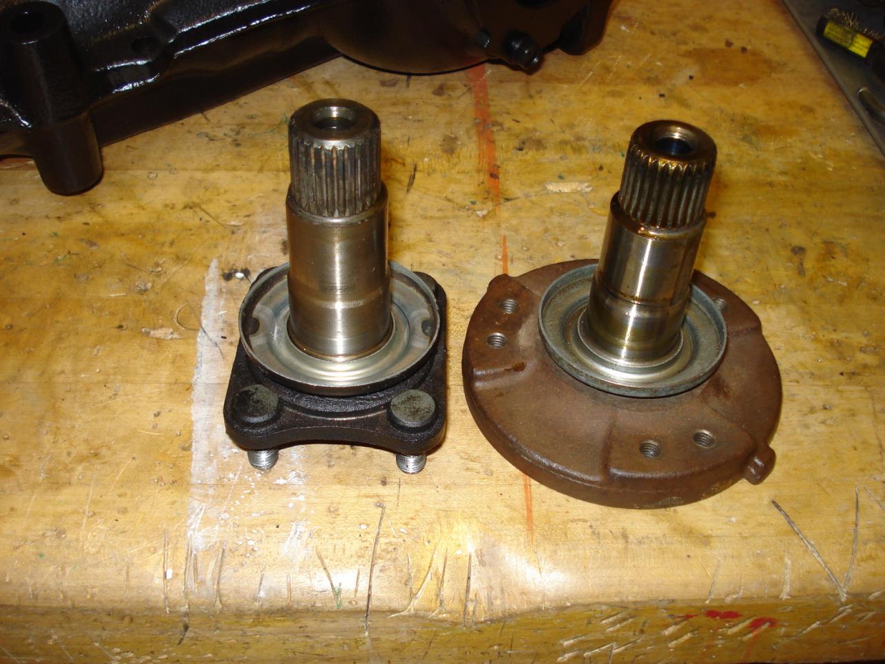

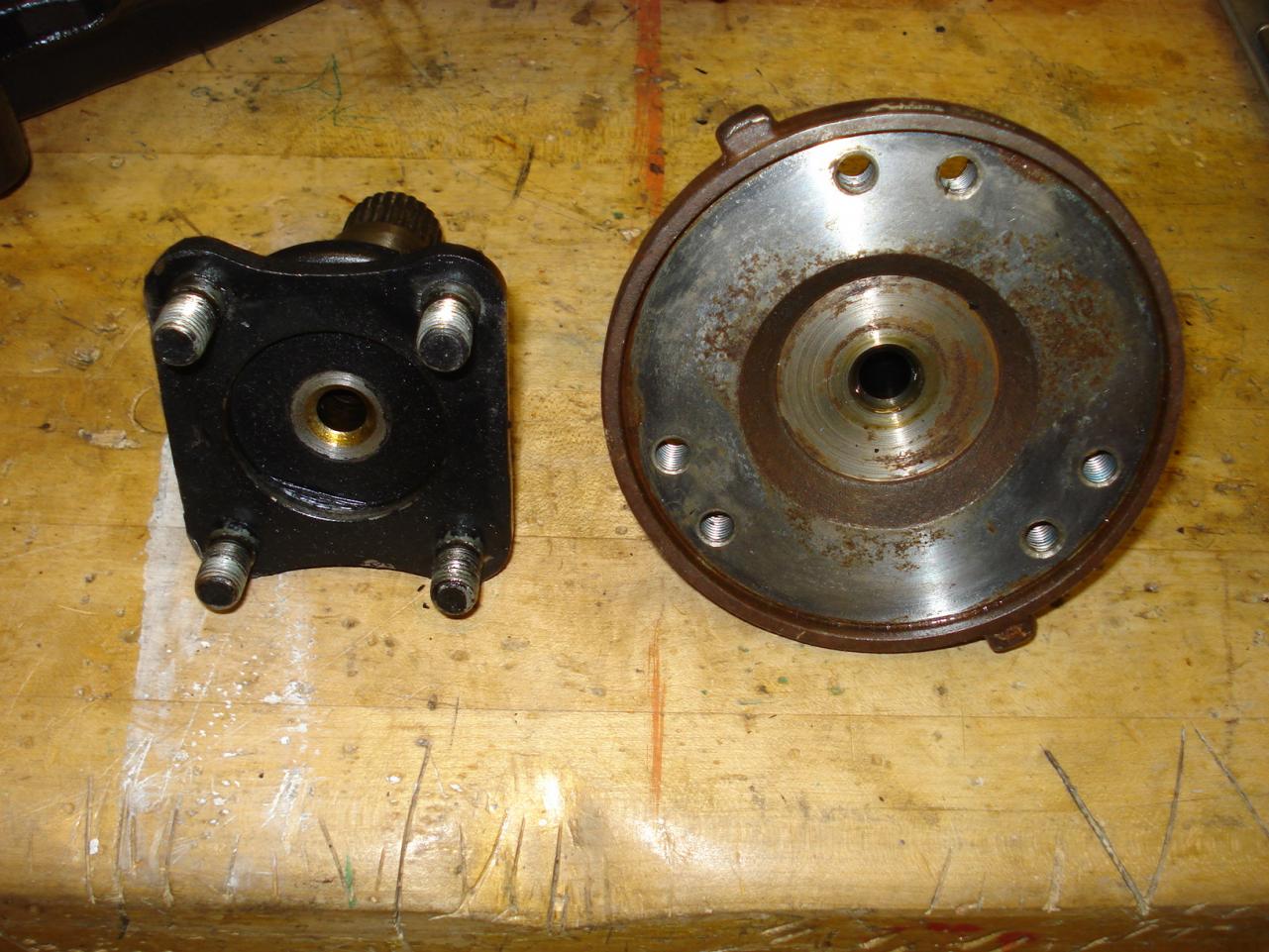

For those who are considering a 3.9 or 4.11 diffy, swapping in a R180 truck diffy is simple & straightforward. In the photo with the two diffys, the stock 3.54 is on the left and the truck 3.90 is on the right. It is the front diffy out of a early '80's Datsun 4X4 (K embossed on the top). The next two photos show the side flanges. The one on the left is from the stock 3.54 and the one on the right is from the truck 3.90. Note that both flanges use a bolt through the middle to attach to the diffy. So, it is a simple matter of removing the flanges from the truck diffy and bolting on the flanges from the stock diffy. No buttons to swap between diffys and the stock mustache bar & half-shafts do not need to be changed out.
My '73 has a L28 and 5-speed out of an '82 ZX and a truck 3.90 R180. The '82 ZX had a R200 3.90, so I've essentially got the '82 ZX drive train in my 240Z, although I did replace the fuel injection with SU carbies. My Z is a mountain cruiser, not a track car and not a drag car. I live in Colorado and cruise the twisty mountain roads with fellow Z car owners who enjoy spirited driving. Uphill acceleration is good and I'm getting 20-21 MPG. Probably better on the highway, but I haven't done enough highway driving to figure out the mpg...
