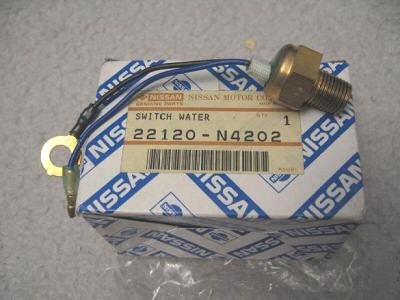

September 15, 200915 yr comment_294841 remember what part number you used off hand..?? Perhaps this photo might help...like they say..."a picture is worth a thousand words..." webdawg1 Link to comment https://www.classiczcars.com/forums/topic/33201-1976-water-temperature-switch/#findComment-294841 Share on other sites More sharing options...
September 16, 200915 yr Author comment_294861 ooooh that's beautiful. i wish i had one Link to comment https://www.classiczcars.com/forums/topic/33201-1976-water-temperature-switch/#findComment-294861 Share on other sites More sharing options...
