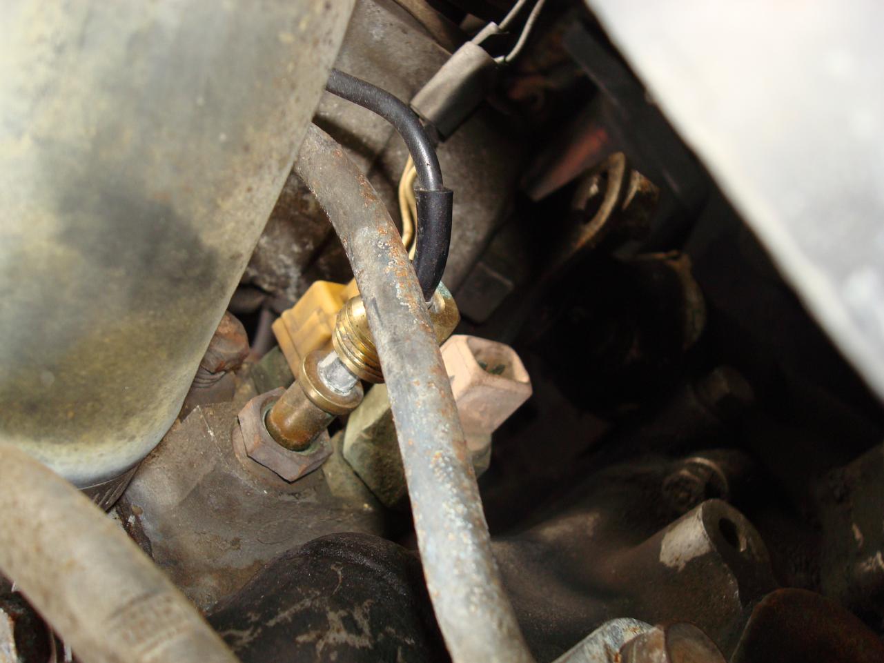

October 25, 200915 yr comment_298404 I am so confused, i am trying to reconnect the thermal transmitter in my dad's old '77 280z so that the gauge in the dash works. He installed an aftermarket gauge and plugged into the transmitter's port and has the gauge attached to the hood. This is a picture of the transmitter that i was told i needed, it looks nothing like the one pictured above Thermostat housing.doc Edited October 27, 200915 yr by kjphilippona Link to comment https://www.classiczcars.com/forums/topic/33201-1976-water-temperature-switch/?&page=3#findComment-298404 Share on other sites More sharing options...
October 25, 200915 yr comment_298438 Hi, if all possible could someone with a '77 280z that has all temp/thermal sensors/switches into the thermostat housing attached and working too take a picture ? Link to comment https://www.classiczcars.com/forums/topic/33201-1976-water-temperature-switch/?&page=3#findComment-298438 Share on other sites More sharing options...

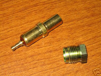

May 2, 201014 yr comment_317951 Hey, whoever reads this post further I found the part you need. That's for a 75-76 water temperature switch. You can find the part "22120-N4202" at courtesyparts.com. These guys seem to have the hard to find parts for early Datsun/Nissan. Link to comment https://www.classiczcars.com/forums/topic/33201-1976-water-temperature-switch/?&page=3#findComment-317951 Share on other sites More sharing options...
May 4, 201014 yr comment_318226 Sorry, I just got an email on my order from Courtesyparts.com. that the part is discontinued and there is no cross reference for the part. Link to comment https://www.classiczcars.com/forums/topic/33201-1976-water-temperature-switch/?&page=3#findComment-318226 Share on other sites More sharing options...
