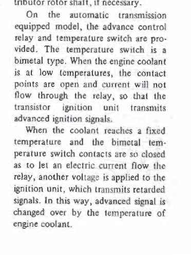

July 5, 201212 yr comment_394842 mousemedic might be going off of what is said in the 1974 FSM. Kudos to him for checking the factory source. It says that the automatic only used the water temp. switch to switch pickups in the distributor. Of course, 1974 is the year of change so it wouldn't be a surprise if the manuals had the switch also, like the 280Zs do (auto and manual), or they added it to the manuals when they went to the big bumpers.To correct one thing in mm's post though, the timing is advanced when cold, then goes back to retarded when warm. My guess is it's another idle speed increaser, like the AAR. It's described n Engine Fuel, not Emissions. It seems like a lot of technology for an unexplained effect. Link to comment https://www.classiczcars.com/forums/topic/33201-1976-water-temperature-switch/?&page=4#findComment-394842 Share on other sites More sharing options...

July 5, 201212 yr comment_394872 Just trying to help people get on the same page. In this case, page EE-27 of the 1974 FSM. Link to comment https://www.classiczcars.com/forums/topic/33201-1976-water-temperature-switch/?&page=4#findComment-394872 Share on other sites More sharing options...
July 6, 201212 yr comment_394904 Just trying to help people get on the same page. In this case, page EE-27 of the 1974 FSM.I've got no problem with that page except that it isn't the whole story. There's more to it than that.Take a look at EC-16 and you'll see that the same switch and the same relay also controls the EGR function.And that EGR control happens on every 260 regardless of what transmission it has.Still not sure? Study the wiring diagram. It's there too. Link to comment https://www.classiczcars.com/forums/topic/33201-1976-water-temperature-switch/?&page=4#findComment-394904 Share on other sites More sharing options...
July 6, 201212 yr comment_394912 I think that you're mistaking my quest for clarity and knowledge with a challenge to what you're saying. It's not. It's exactly what I wrote and the picture I posted.mousemedic said "only", I showed why he might have said that. Now, you have shown, with your references, that there's more to the story.This is the internet. The best way to get someone to believe the point you're making is with examples and references. Without those, how do you know if anyone really knows what they're talking about? And how do you explain it to someone else? "A guy from the internet said it was so". Thanks for the link to the EC section. Now we're learning. Link to comment https://www.classiczcars.com/forums/topic/33201-1976-water-temperature-switch/?&page=4#findComment-394912 Share on other sites More sharing options...
