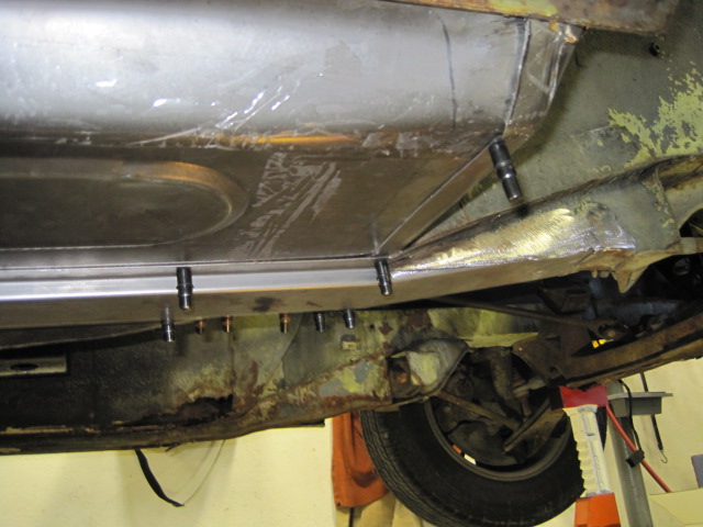

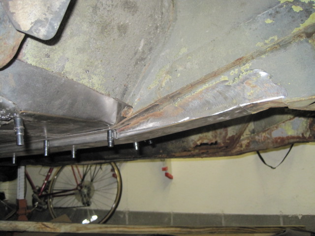

December 18, 200915 yr comment_303600 These are not the greatest pictures but I purchased Charlies floor pans and rails, not really sure what you mean by only partial. Keep in mind I paid my shop to install mine, but I don't remember them saying they were not long enough. Just to help me, tell me what to look for on the rails. I want to make sure mine were done as close to factory as possible. Link to comment https://www.classiczcars.com/forums/topic/33215-floor-support-rails/#findComment-303600 Share on other sites More sharing options...
December 18, 200915 yr Author comment_303602 These are not the greatest pictures but I purchased Charlies floor pans and rails, not really sure what you mean by only partial. Keep in mind I paid my shop to install mine, but I don't remember them saying they were not long enough.Just to help me, tell me what to look for on the rails. I want to make sure mine were done as close to factory as possible.I think you misunderstood something in the posts. Charlie's rails were more than long enough. I am pretty sure there is at least 6 extra inches on them so you can cut to fit. They do not include the very front part of the rail that is shaped like a triangle under your brake booster. This is not attached to the floor pan it is attached to the firewall and front frame rails. Your rails look good.John Edited December 18, 200915 yr by JohnnyO Link to comment https://www.classiczcars.com/forums/topic/33215-floor-support-rails/#findComment-303602 Share on other sites More sharing options...

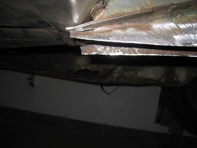

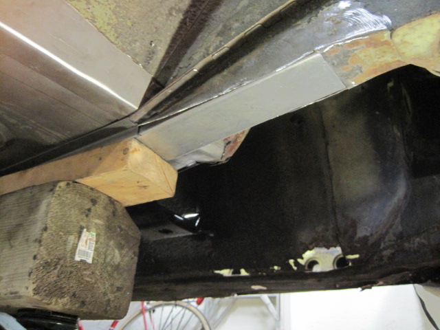

December 18, 200915 yr comment_303604 Well it worked out better then I thought. Though Charlies floor pans are short on material up front, the rails are extra long. I moved the rail forward probably 2 inches from the stock, maybe not even that much. I was able to remove most of the damaged area under the tension box and I believe it will look very stock when it's done. As you can see the rail is about perfect width for the tension box except for the aft part of the box-you have to spread that out a little. This is on a customers car. On my car I actually had the same situation where I had rust free floors but a bent rail. I actually cut a hole in the floor pan right over the damaged area of the rail and then beat it back in place and then touched up some of the welds. Link to comment https://www.classiczcars.com/forums/topic/33215-floor-support-rails/#findComment-303604 Share on other sites More sharing options...
