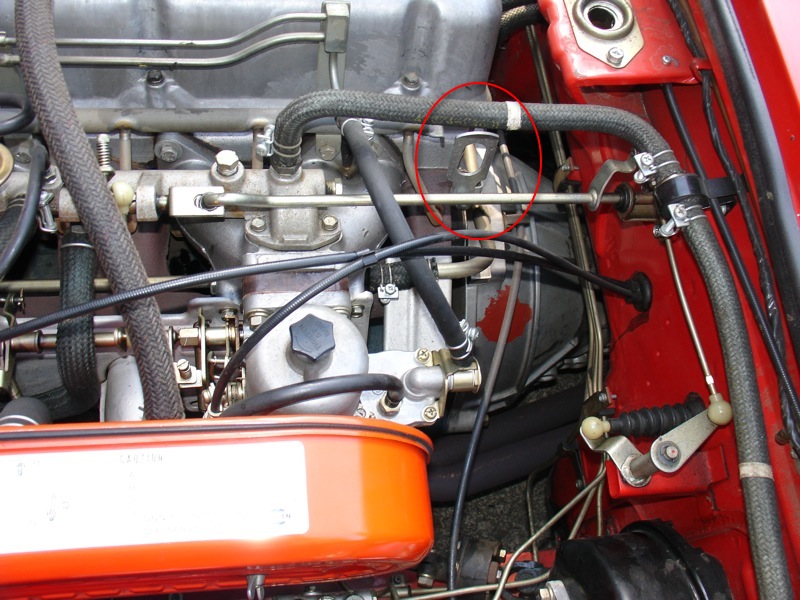

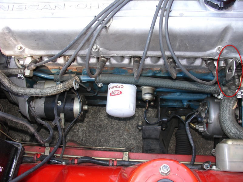

Posted September 17, 200915 yr comment_295006 but now that i've got my engine assembled, head bolted on etc., where do i attach the chains to hoist it? i'm not seeing anything obvious on the block, like "slingers." the fsm doesn't offer much insight... Link to comment https://www.classiczcars.com/forums/topic/33224-this-may-be-a-really-dumb-question/ Share on other sites More sharing options...
September 17, 200915 yr comment_295008 not much better than fsm, but says center hook over engine. attach the ends of the sling to the engine-lifting lugs-one at the front of the block; another at the rear.there are no pics of said lugs. Link to comment https://www.classiczcars.com/forums/topic/33224-this-may-be-a-really-dumb-question/#findComment-295008 Share on other sites More sharing options...
September 17, 200915 yr comment_295009 I've drawn red ovals around the lugs on my engine. Yours were probably removed at some point in the past. Link to comment https://www.classiczcars.com/forums/topic/33224-this-may-be-a-really-dumb-question/#findComment-295009 Share on other sites More sharing options...
September 17, 200915 yr Author comment_295010 thanks! i do not have those. are they bolted onto the head? it's sort of hard to tell from the photos. Link to comment https://www.classiczcars.com/forums/topic/33224-this-may-be-a-really-dumb-question/#findComment-295010 Share on other sites More sharing options...
September 17, 200915 yr comment_295013 thanks! i do not have those. are they bolted onto the head? it's sort of hard to tell from the photos.Yes, they bolt into the head. If you use some steel bolts that you have in your shop/garage for lifting, make sure you have good thread engagement; at minimum 8 threads. Also, keep lifting hooks as close to the head as possible to minimize torque on the bolt. Link to comment https://www.classiczcars.com/forums/topic/33224-this-may-be-a-really-dumb-question/#findComment-295013 Share on other sites More sharing options...
