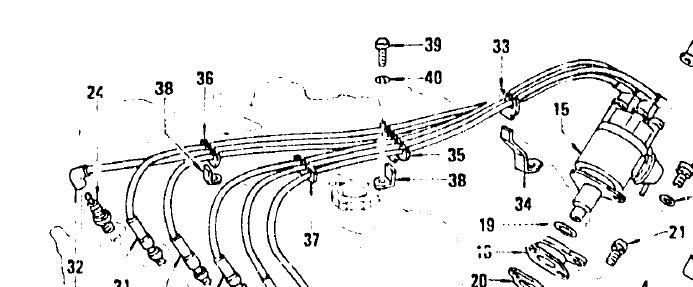

Quick note. It seems I made a bit of a mistake when putting my thermostat back on. The spark plug wire holder that bolts to the rear most bolt on the thermostat cover is made of plastic, and when I put it back on, I sort of snapped the plastic in half. Does anybody know who may have an extra?
Part 33, Nissan number 22472-E3000, still available from Nissan for around a buck and a half. Same price roughly from MSA. #12-4181.

You know for whatever reason, I was looking at the cooling part of the catalog since that is where its attached to the engine.
