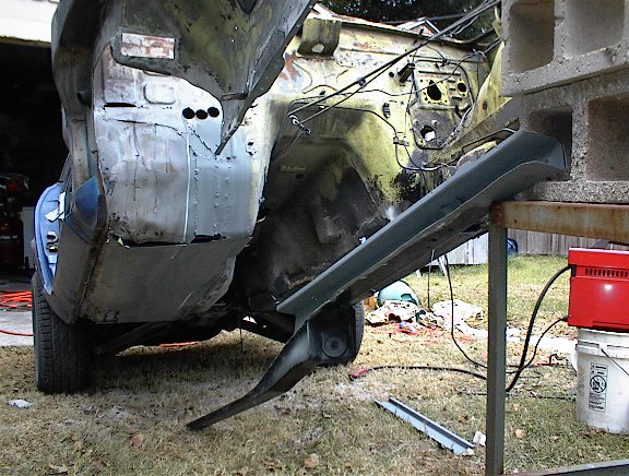

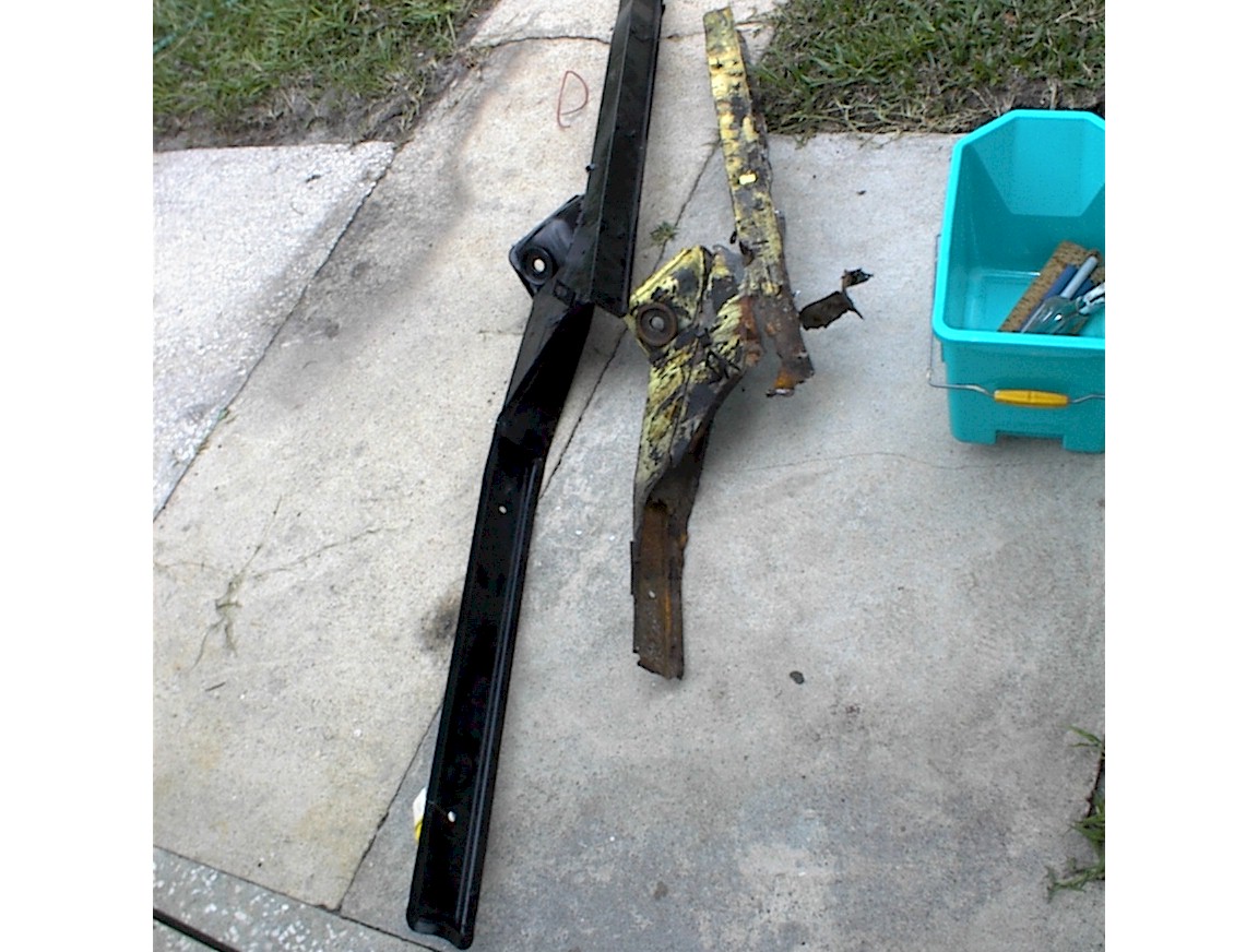

You might find that some of your metal has rusted/thinned so much that you need to replace it. The third picture shows that the battery tray and firewall needed patching. I ground the welds flush using the cut off wheel since it had fine control. Use eye protction! :)

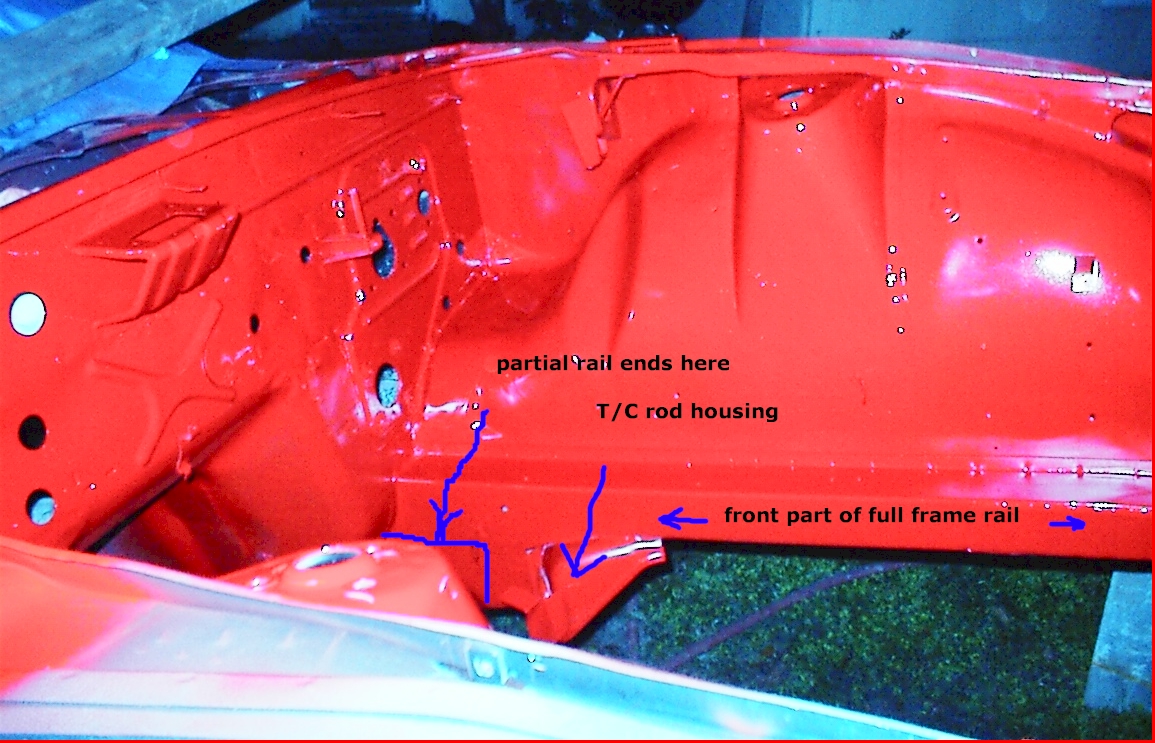

It's not the full length frame rail... Just the rear section which is aft of the T/C rod. From what I read off Bad dogs site they slip over your existing rear rail and are then welded on. It's a very nice band aid to get you through for a while. They should be pretty cheap to have installed at a body shop.

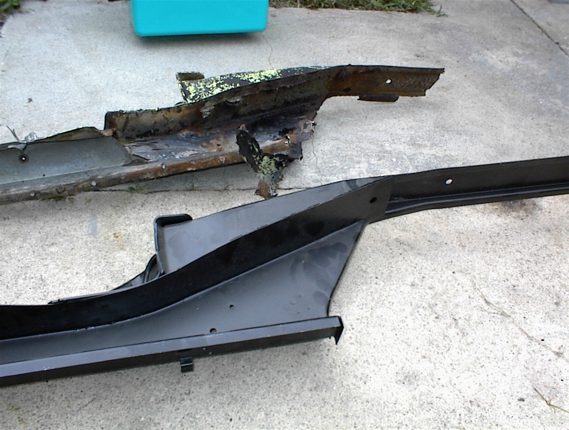

In my last post the first picture shows a full rail (black). Notice the front section from where the T/C rod and engine/suspension crossmember mount. You don't want to have the front of the rail crumble. Mine was so thin it was actually tearing.

Heres a picture of the front section of a frame rail...

It's a BIG undertaking for someone at home to replace a full rail. It can be done but takes time. The partial could be done in a short afternoon at home if you have the tools.
