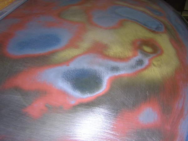

You don't get it that hot. Blue or even hay colored is too hot. For me the long cooler flame allowed me to gradually heat a larger area like the picture and watch the indent "grow", and quench it just enough to make it come back down. A localized hot spot will warp it unless you are doing very small dings and use a dinging hammer and a dolley.
