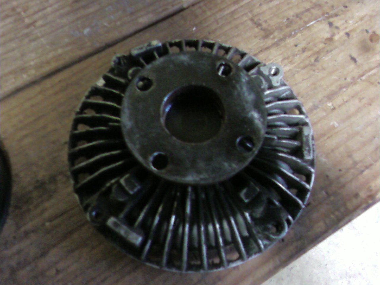

Posted September 23, 200915 yr comment_295562 Does anyone have any tips on how to effectivley get all, or most of the road grime, grease and dirt from out between all the nooks and crannies in the fan clutch, i tried scraping, and a nylon bristle brush, and wd- 40, i just cant seem to get it out and make it clean. This was it before i even started cleaning it Link to comment https://www.classiczcars.com/forums/topic/33305-fan-clutch-help/ Share on other sites More sharing options...

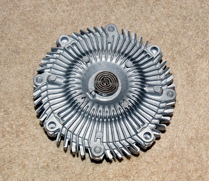

September 24, 200915 yr comment_295570 I just put them in the cleaner, let it run for a few minutes, hit them with the air gun and they look like this: Link to comment https://www.classiczcars.com/forums/topic/33305-fan-clutch-help/#findComment-295570 Share on other sites More sharing options...
