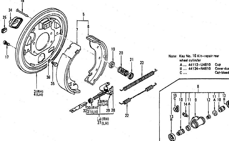

Hi Guys,
Thank you for all your suggestions. Btw, I should have mentioned that I have a 1978 280Z and I think it might be slightly different than older Zs. The pictures in the manuals don't resemble what I have. I was able to remove the driver's side drum and have attached a couple of pictures. The first pic shows the piston but no starwheel and the 2nd pic has a wheel behind the piston (circled in red) and that's for adjusting the hand brake and can't be accessed thru the front, it does have an access hole in the back but very difficult to reach the wheel. Anyway, I worked on the passenger’s side without luck, I guess I'll try again tomorrow I ran out of light.
Thanks again,
Rick
rxsleeper,
That's it! That’s what I have. I just realize that the drum does not want to go on because the pads are too spread out. It looks like the parking brake needs to be adjusted, this should turn assembled, but I'm having issues. I may have to take it apart again. Btw, I already broke the lower tension spring and have to get another one. I might be doing something wrong in the assembly. I'm putting the springs on both shoes and then I'm spreading them to fit. I have not been able to put the springs on when the shoes are in place. If you guys have a better way of doing this please let me know.
Thanks,
Rick
