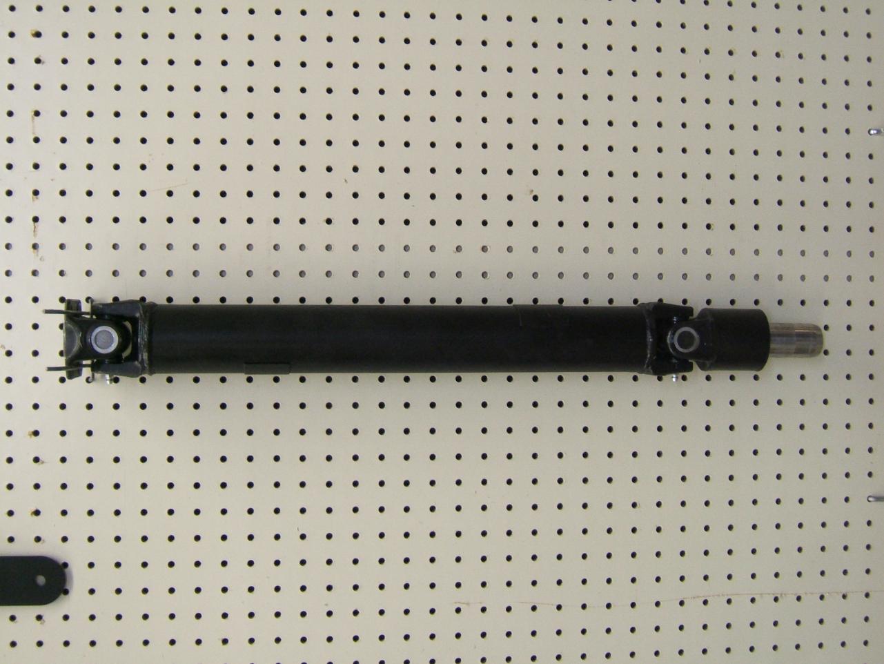

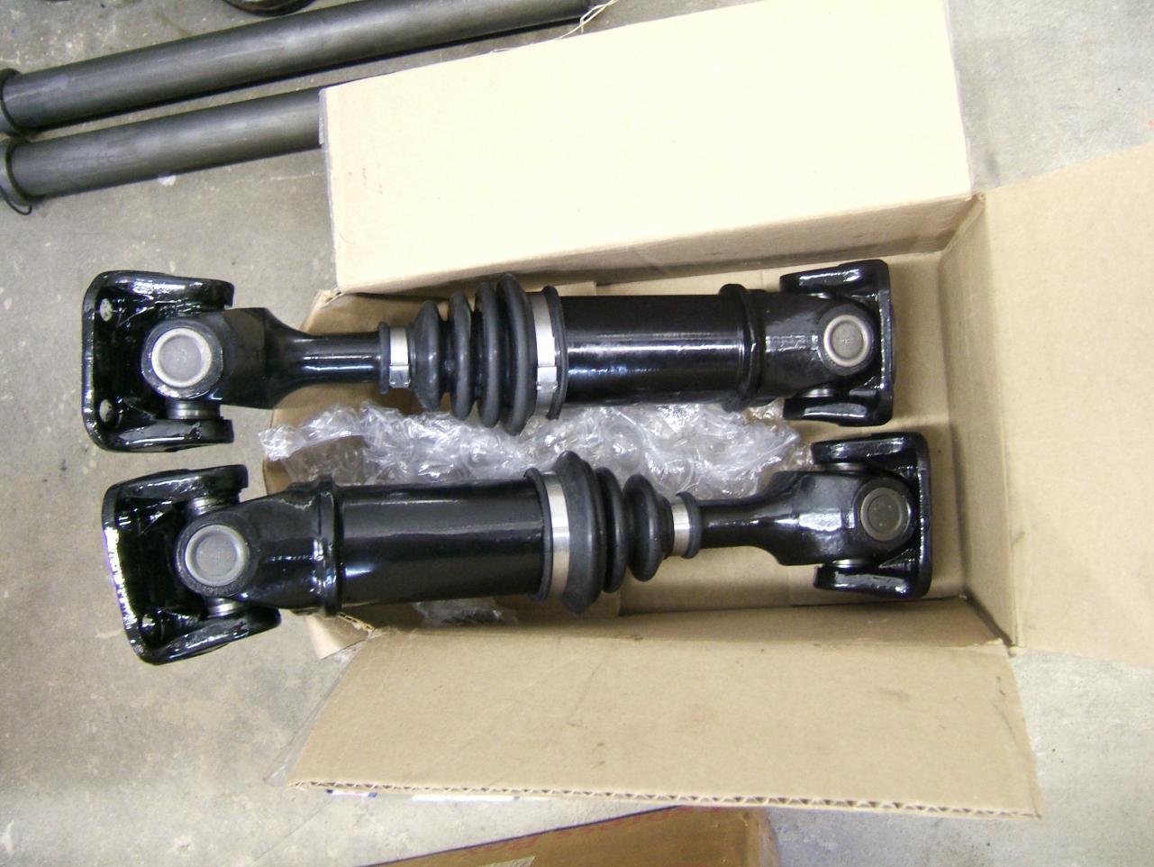

September 27, 200915 yr comment_295833 So what U joints Would you choose over other for axles and drive shaft I had new u-joints installed by a local shop, both for the halfshafts and the driveshaft. The shop's preference, and what I purchased, is Neapco brand. I'm sorry I don't have part numbers for you, but here is a link to Neapco contact info., where you can inquire about where to purchase: http://www.neapco.com/n_contact-support.php Pics: Link to comment https://www.classiczcars.com/forums/topic/33334-u-joints-and-vapor-tank-leak/#findComment-295833 Share on other sites More sharing options...
