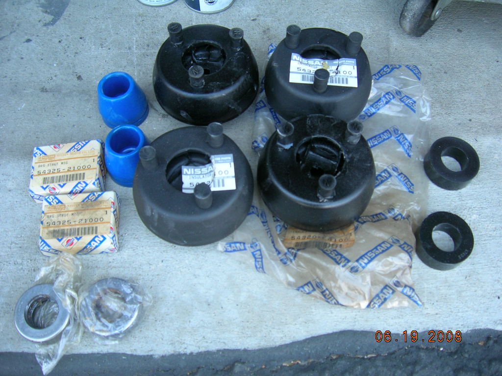

Esprist (or anyone who may know) .. I have a question.
Q) What is the Height difference between a 260z/280z Strut Inuslator and the stock 240z strut for a rear suspension? I'm thinking of installing all stock 240z parts accept for the Strut Insulator where I'd use a 260z/280z one since I need a little more height given my wheels are 3/4" large in diameter (3/8" less clearance between Fender & Tire.
I'm figuring to raise my rear suspension 1.75" to 2" with 1 adult in the car. My coils are stock original so I know I'm loosing almost 3/4" of height from them based on spring rate differences with the New Arizona Z Rear coils. Here's my assessment of height increase:
=> New Arizona Z Stock Height Coil: +3/4" increase (did the fronts and saw this height increase since rates of 100 lb/in Stock vs A-Z's 200 ft/in).
=> New Tokico Gas HP Shocks: ~1/8" at most. I'm removing 8year old HP Gas Tokicos and this is what I saw when I replaced my front ones.
=> New Urethane Spacer: ?? don't know here until I remove the current ones. At most +1/4" if they are worn, normal height is 3/4" for urethane new ones.
=> 260z/280z Strut Insulator: ???? MSA said 3/4" thcker than a 240z Strut Insulator. I ordered a set and will measure it exactly.
==> Total increase estimated using the 240z Strut insulator would be: ~1-1/8" at best assuming my urethane spacer is 1/4" thicker than the one I remove.
===> This still leaves me roughly 7/8" shorter than I'd like.
That's why I'm thinking a 260z/280z Strut Insulator may get me the addtional 7/8"-1" in height I need.
Many thanks for any insight and advice folks ...

Mezz is correct. MSA has New Strut insulators for both 240z and 260z/280z's. They are interchangeable between both models and they are a bit pricey so it's cheaper to lower or raise your car using different coil springs and shocks if possible. The 260z/280z Strut insulator is thicker making the car sit higher versus the 240z. I did order a set of 260z/280z strut insulators along with new 240z strut insulators so when I finally get around to replacing my rear shocks and coils - I'll be able to decide what parts to use so I get 1.75"-2' of more rear high.
Anyway - MSA said the 260z/280z Strut Inuslator is 3/4" thicker than the 240z. I'll get an exact measurement when they all arrive and post it here.
Also - Arizona-Z is out of Rear Stock height springs and no batch run in the future is planned so I'm in a real bind. Since most coil springs are now performance ones and lower the 240z ~1", the only option is for me to order a set for 260z/280z hoping the compressed length is close to a stock 240z spring. Anyway I ordered a set of Eibach's from MSA for a 260/280z 2+2; Free length is ~1" shorter than the stock 240z however the progressive spring rate on Eibachs is 80 - 300 lb/in with an average of 185lb/in (where as the stock 240z coil was 103 lb/in new). I'm hoping this gets me close or slightly higher than the stock 240z compressed height of 8.4".
Anyway I'll let you know how it goes.
Edited by moritz55
If the Eibach springs start at 80 lb/in - where the OEM's are 103 lb/in - then the car is going to set even lower with the Eibach's.
That is to say - that if you have 635 lbs on the rear corner - - that would compress the Eibach spring 635/80 = 7.9 inches... If in that progressive range they "average" 90 lb/in in the first few inches - that would be 635/90 = 7.05 inch. Where the OEM springs would compress only 635/103 = 6.17
If the Eibach's start out being an inch shorter than stock - then they will not have the same amount of pre-load {applied by tightening them down within the lower Spring perch and extended Shock Rod}, So yes, I would guess that in the end the Eibach's will lower your 240Z ride height about an inch or more when installed.
To raise your ride height - you'd need a spring the same Free Length as OEM - 15" with a spring rate around 128 lbs/in.
