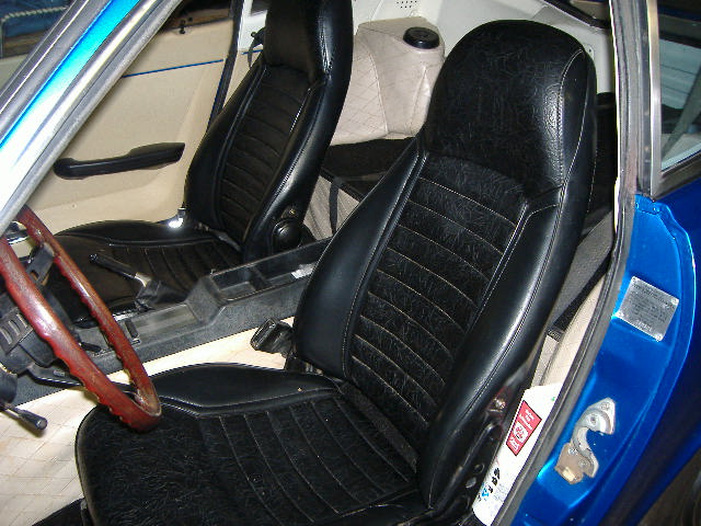

Posted September 28, 200915 yr comment_295919 Here's my problem: I replaced all of my rubber fuel injection hose under the hood from the fuel inlet pipe to the fuel return pipe. I started the engine and backed it out of the garage leaving a large trail of gasoline (to find my way back into the garage.) I used 5/16" GoodYear SAE J30R9 fuel injection hose and Ideal 52F15V fuel injector hose clamps for 5/16" hose. All of the leaking seemed to be located at the fuel rail/injectors as the heat shield above the exhaust header was soaked. I had turned off the engine before opening the hood so it's kinda hard to pinpoint exactly where the leak was - everything on the driver's side of the engine was wet.Do I have the wrong size hose or clamps? Did I tighten the clamps too tight causing the hose to pucker? Link to comment https://www.classiczcars.com/forums/topic/33349-fuel-injector-hoses-replaced-fuel-everywhere/ Share on other sites More sharing options...

September 29, 200915 yr comment_295994 One of these should be installed in everyone's Z. Right behind the seat, easy access. Hopefully, never have to use it. Bonzi Lon Link to comment https://www.classiczcars.com/forums/topic/33349-fuel-injector-hoses-replaced-fuel-everywhere/#findComment-295994 Share on other sites More sharing options...
September 29, 200915 yr comment_296001 Can't see it very well. Got another photo? Link to comment https://www.classiczcars.com/forums/topic/33349-fuel-injector-hoses-replaced-fuel-everywhere/#findComment-296001 Share on other sites More sharing options...

September 29, 200915 yr comment_296007 Can't see it very well. Got another photo?I don't think a different shot or angle would help. It has a cover on it. Most extinguishers come with some type of mounting bracket and are fairly easy to install. Had one in all three Datsuns and plan to install one in the GTO. Edited September 29, 200915 yr by sblake01 Link to comment https://www.classiczcars.com/forums/topic/33349-fuel-injector-hoses-replaced-fuel-everywhere/#findComment-296007 Share on other sites More sharing options...
September 29, 200915 yr Author comment_296016 That's normal operation as long as the AFM flap is open enough initially to close the fuel pump contacts. This is true for all 75-77. 78 and up don't have fuel pump contacts in the AFM.Stephen,I thought that the fuel pump wasn't supposed to switch on until the key had been turned to the "start" position - which would also open the AFM flap, closing the fuel pump contacts. Is my AFM flap stuck open or is this normal? Do I need to lubricate or even clean/rebuild my AFM?Tomo,The fire extinguisher is in the picture next to the door opening...it looks like the extinguisher has a cover of some kind over it - like you would find in an RV or trailer. Edited September 29, 200915 yr by twsutt Link to comment https://www.classiczcars.com/forums/topic/33349-fuel-injector-hoses-replaced-fuel-everywhere/#findComment-296016 Share on other sites More sharing options...
