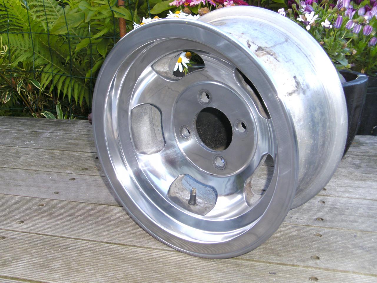

September 29, 200915 yr comment_296019 The attached photo show one of my Appilance wheels in progress of restoration. They were pitted like he.. and had a lot of curb rash, so after cleaning them with phosforic acid, i sanded them down and then went up in grith ending with grith 800 before buffing, not much to it, except of elbow grease. Chris Link to comment https://www.classiczcars.com/forums/topic/33351-refurbishing-mag-wheels/#findComment-296019 Share on other sites More sharing options...

September 30, 200915 yr comment_296091 Coop / Alan, I do apologize for my post, I was not aware that it actually is Magnesium, I have seen so many times, that alloy's are referred to as mag wheels and just assumed.Chris Link to comment https://www.classiczcars.com/forums/topic/33351-refurbishing-mag-wheels/#findComment-296091 Share on other sites More sharing options...
